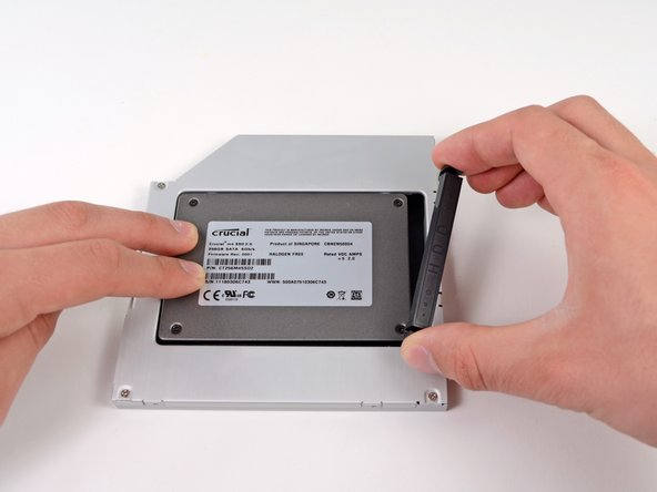

I replaced with an ssd, put that into a ssd enclosure. Had to drill an extra hole in it to fasten the pins that hold it in place.
Used Carbon Copy Cloner to make an image from the old hdd, with the sad connected via usb. Checked it of it booted via System Preferences > Startup Disk. It worked so the took the imac apart and replaced the disk. Booted, everything was working as always, only faster!

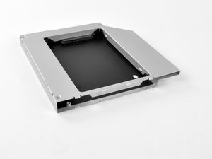

I'm replacing my optical drive too. what exactly needs to be plugged into the SSD? I don't have the kit - as I am not sure one is required if I buy something like this: http://www.amazon.com/gp/product/B0056OB...
Can you please advise? Can I do it with this piece, or do I need to get the entire bracket kit?

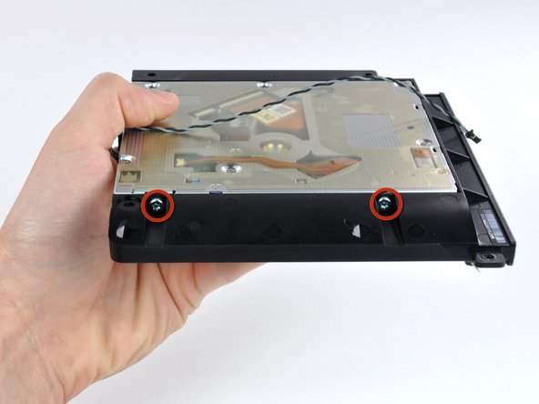

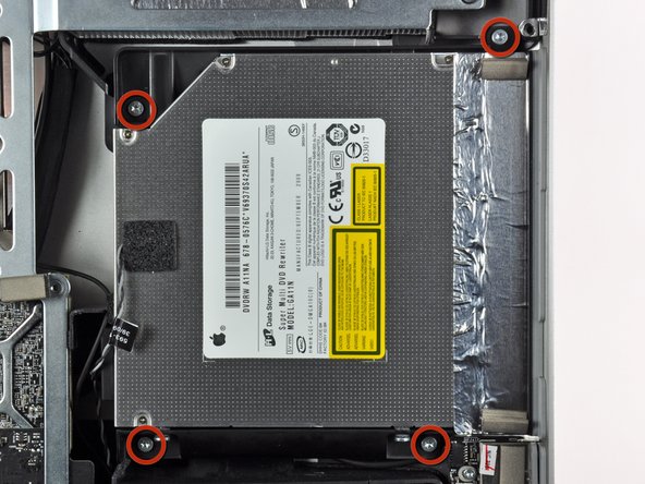

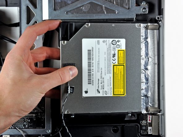

  • Remove the four T10 Torx screws securing the optical drive to the outer case.
Is it possible to use the DVD drive after installing the SSD, or is there no space left?

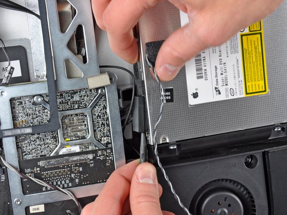

Image 1/1:

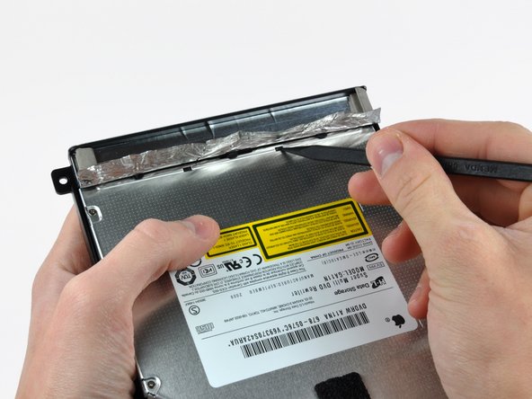

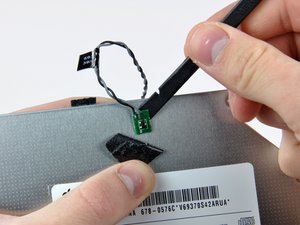

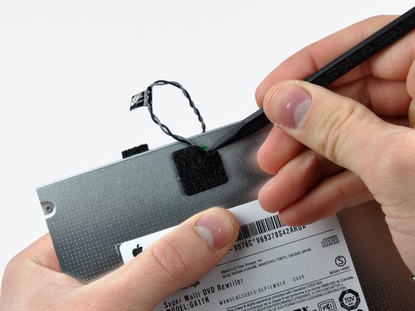

  • Pull the optical drive thermal sensor connector straight away from its socket on the logic board.
This step is not necessary. I have problems with the pulling out, and found that it's not necessary to out it in this case.
Steve - Reply
Agreed. Leave it plugged in and peel the buffer tape and temp sensor off the optical drive assembly while it's still in the computer.
John Lavenia -
What problems did you have?
Toni Marmol - Reply
Don't do that! It's not necessary to pull the sensor cable out. And it cost me an hour to find out that it was this sensor cable and not the LCD sensor cable that made the fans spin at 3000+rpm. The less sensor cables you remove, the easier to find the culprit if you stumble into fan issues.
bhager - Reply

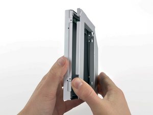

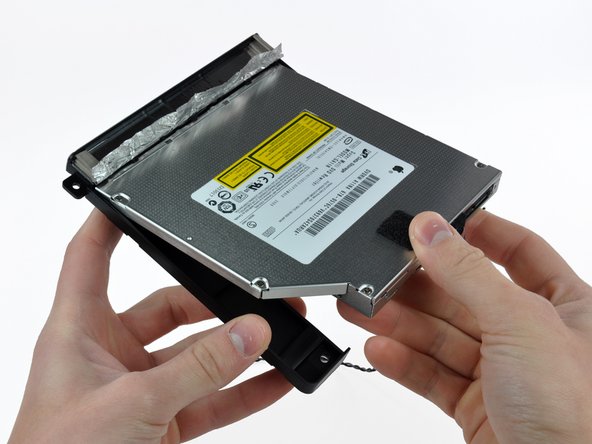

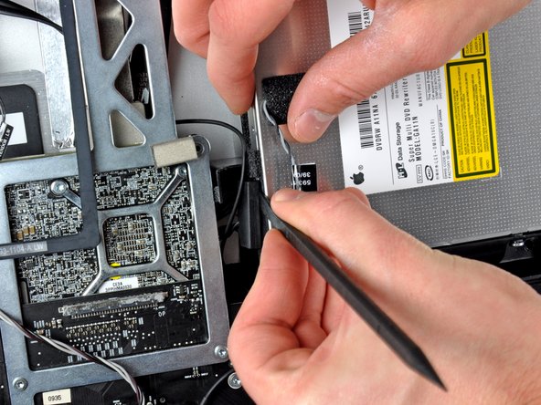

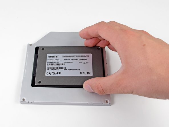

Image 1/2: Twist the spudger to slightly separate the optical drive connector from the optical drive, then use your fingers to pull the connector away from the drive. Image 2/2: Twist the spudger to slightly separate the optical drive connector from the optical drive, then use your fingers to pull the connector away from the drive.
  • Insert a spudger between the optical drive connector and the optical drive.
  • Twist the spudger to slightly separate the optical drive connector from the optical drive, then use your fingers to pull the connector away from the drive.

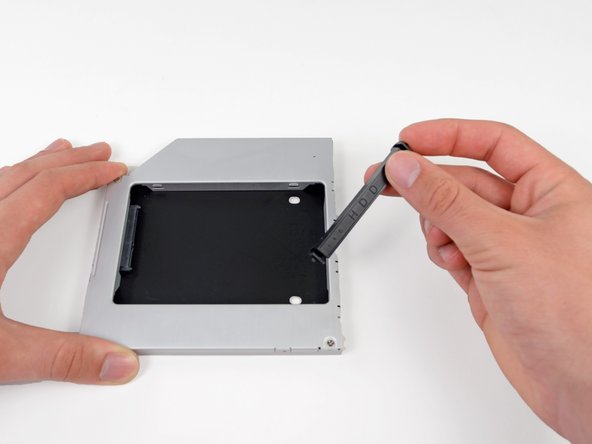

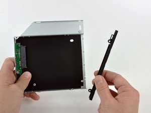

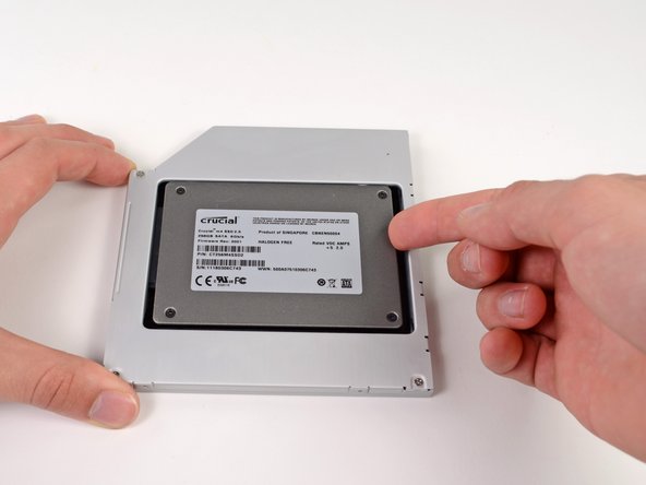

Hello, is the sata & power cabla from the mac can directly feet inside the SSD?
Roman Quenin - Reply
Can the superdrive connector cable (possibly just SATA and SATA power bundled) be used for SSD? I wanted to replace the superdrive completely with an SSD, and thus having in total 2 SSDs and one HDD inside the iMac. Thanks in advance.

Image 1/1: During reassembly, note that there are two holes in the optical drive face plate into which two stubby plastic posts must engage for proper positioning.
  • Lift the left edge of the optical drive slightly and pull it away from the right side of the outer case.
  • During reassembly, note that there are two holes in the optical drive face plate into which two stubby plastic posts must engage for proper positioning.

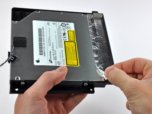

Image 1/2: It is not necessary to peel all of the EMI tape off the optical drive bracket. Image 2/2: It is not necessary to peel all of the EMI tape off the optical drive bracket.
  • Peel back the portion of aluminum tape highlighted in red, leaving the rest attached to the black plastic optical drive bracket.
    • It is not necessary to peel all of the EMI tape off the optical drive bracket.

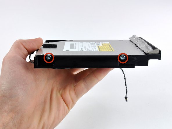

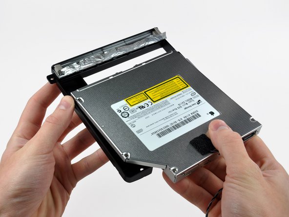

  • Remove the two T10 Torx screws from each side of the optical drive (four screws total).
Image 1/3: Rotate the optical drive bracket slightly away from the optical drive. Image 2/3: Pull the optical drive bracket away from the open end of the optical drive, minding any tabs that may get caught. Image 3/3: Pull the optical drive bracket away from the open end of the optical drive, minding any tabs that may get caught.
  • Use the tip of a spudger to press each of the optical drive bracket tabs out of their slots on the bottom of the optical drive.
  • Rotate the optical drive bracket slightly away from the optical drive.
  • Pull the optical drive bracket away from the open end of the optical drive, minding any tabs that may get caught.
Image 1/2: Use the flat end of a spudger to carefully pry the thermal sensor up off the adhesive securing it to the optical drive. Image 2/2: If you have a disc or anything else stuck inside your optical drive, we have a [guide|772|guide] to fix it.
  • Use the tip of a spudger to peel back the piece of foam tape covering the optical drive thermal sensor.
  • Use the flat end of a spudger to carefully pry the thermal sensor up off the adhesive securing it to the optical drive.
  • If you have a disc or anything else stuck inside your optical drive, we have a guide to fix it.
Do I have to reattach the optical drive thermal sensor to the SSD?
Ignatius Lee - Reply
Yes, just stick it onto the SSD and cover it with the buffer. Better than leaving it loose in the computer, or worse omitting it altogether.

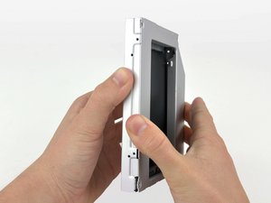

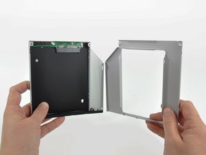

Image 1/3: Continue to pull open the two halves of the enclosure until they separate. Image 2/3: Continue to pull open the two halves of the enclosure until they separate. Image 3/3: Continue to pull open the two halves of the enclosure until they separate.
  • Starting from the left edge, gently pull open the optical bay enclosure.
  • Continue to pull open the two halves of the enclosure until they separate.

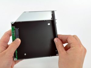

Image 1/1:
  • Remove the two 3.0 mm Phillips #0 screws securing the faceplate to the optical bay enclosure.
Image 1/3: You will no longer need the faceplate or the two Phillips screws that held it in place. Set those parts aside if you ever wish to put the faceplate back into the enclosure. Image 2/3: Reassemble the optical bay enclosure without the faceplate, reusing the original three 3.0 mm Phillips screws to keep it intact. Image 3/3: Reassemble the optical bay enclosure without the faceplate, reusing the original three 3.0 mm Phillips screws to keep it intact.
  • Lift the black plastic faceplate out of the optical bay enclosure.
    • You will no longer need the faceplate or the two Phillips screws that held it in place. Set those parts aside if you ever wish to put the faceplate back into the enclosure.
  • Reassemble the optical bay enclosure without the faceplate, reusing the original three 3.0 mm Phillips screws to keep it intact.

Image 1/2: Image 2/2:
  • Remove the plastic positioner from the optical bay hard drive enclosure by pressing in on one of the clips on either side and lifting it up and out of the enclosure.

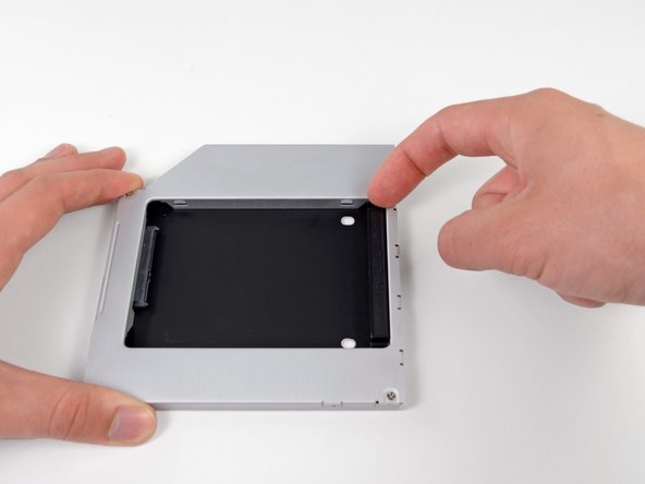

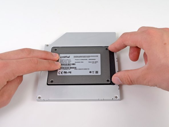

Image 1/3: Gently place the hard drive into the enclosure's hard drive slot. Image 2/3: While firmly holding the enclosure in place with one hand, use your other hand to press the hard drive into the enclosure connectors. Image 3/3: While firmly holding the enclosure in place with one hand, use your other hand to press the hard drive into the enclosure connectors.
  • Make sure that the hard drive connectors are facing down before placing it into the enclosure.
  • Gently place the hard drive into the enclosure's hard drive slot.
  • While firmly holding the enclosure in place with one hand, use your other hand to press the hard drive into the enclosure connectors.
Image 1/2: Reconnect any cables you have removed from the original optical drive onto the optical bay enclosure. Image 2/2: Reconnect any cables you have removed from the original optical drive onto the optical bay enclosure.
  • Once the hard drive is snug, reinsert the plastic positioner while holding the hard drive against the bottom of the enclosure.
  • Reconnect any cables you have removed from the original optical drive onto the optical bay enclosure.
Why no mention of attaching the new hard drive to the Optical Drive Enclosure using the enclosed phillips screws?
Once you have securely inserted the new hard drive into the Optical Drive Enclosure and replaced the plastic positioner you should attach the drive to the enclosure using two of the provided phillips screws. Two holes on the underside of the enclosure should align with two attachment holes on the underside of the drive.

Not terribly difficult, though I did install an SSD in my son's 20" iMac. Used the OWC data doubler bracket, which, of course, isn't designed for the iMac. I had to bend some metal in order to make it work at a very basic level, but otherwise didn't run into any real roadblocks.
Joseph Bonito - Reply
I used OWC Data Doubler. Fit no prob.
John Lavenia -
Success, and not as difficult as I thought. Getting the glass out (27") was a bit nervous but it's strong and the suction cups work well. The display itself has a heavy frame around it so also is strong. I used a large soft artist's brush to dust the display and inner glass. I carefully used needle nose pliers on the cables and connectors, couldn't get enough grip with tweezers.
Andrew Crabb - Reply
I have iMac late 2009 (EMC 2374) and the optical bay fits well into it. I installed Samsung SSD 850 PRO 256 Gb with a documented speed 520/550 (write/read). But unfortunately it seems because of ODD (optical disk drive) link I've got only 250/270. Anyway I'm pretty happy, because I merged SSD with my hybrid HDD 2 Tb (150/150) and now have 2.25 Tb Fusion drive with about x2 speed. My advise - don't buy expensive SSD with high speed if you want to link it through optical bay - the speed will be cut anyway.
evgeniyfedoseev - Reply
The real matter is the interface that is an old 3GB/s instead of a recent 6GB/s that limit the performance of SSD drive
Simone Richelmy -
Question: would it be faster/better to mount the SSD on the original HD bay? Is that a faster/better SATA interface?
macmai -
I completed this in less than 30 minutes, but I too had problems securing the optical bay enclosure to the SSD caddy. I had to squeeze them together about 1/16th of an inch to get the screws to line up. Other than that, it was easy squeezy lemon peasy.
aegrant - Reply
Really easy. I would suggest not to disconnect the sensor for the optical drive from the motherboard. Really fiddly to try and reconnect.....and difficult to find where it went! Rather just peel the sensor carefully off the optical drive and then replace it on the solid state drive case with some insulating tape. It has to be connected on my Mac late 2009 otherwise the cooling fan runs all the time.
With the solid state drive in this iMac now flies! Wonderful
Peter Shahinian - Reply
Yesterday I changed the SuperDrive for a SSD following this guide without any problems. All perfect. Thanks from Spain.
Sweet Moon - Reply
