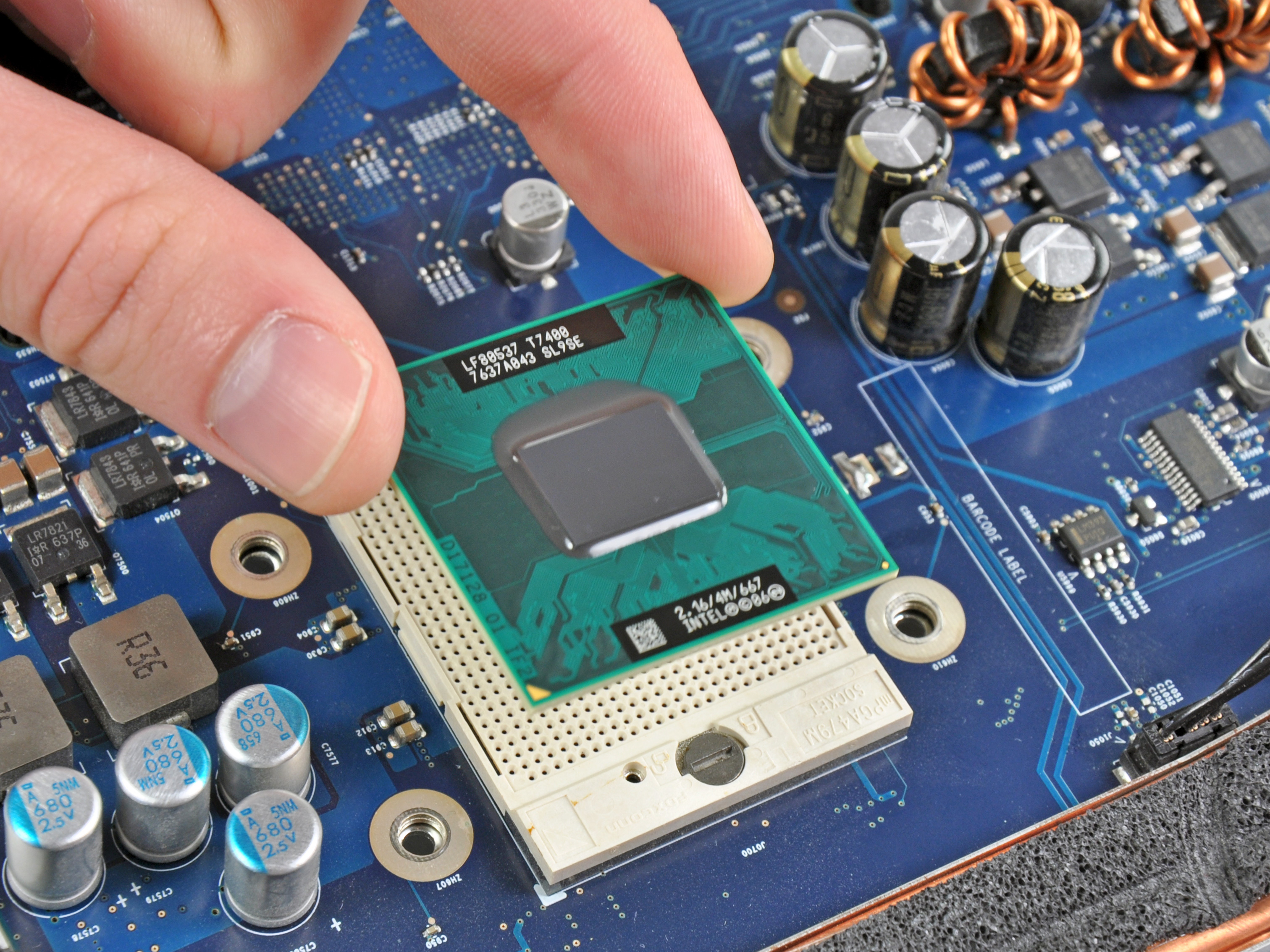

Use the tip of a spudger to push the CPU thermal sensor cable connector out of its socket on the logic board.
Use a small flathead screwdriver to rotate the CPU lock 180 degrees counter-clockwise.
Lift the CPU straight up from its socket.
