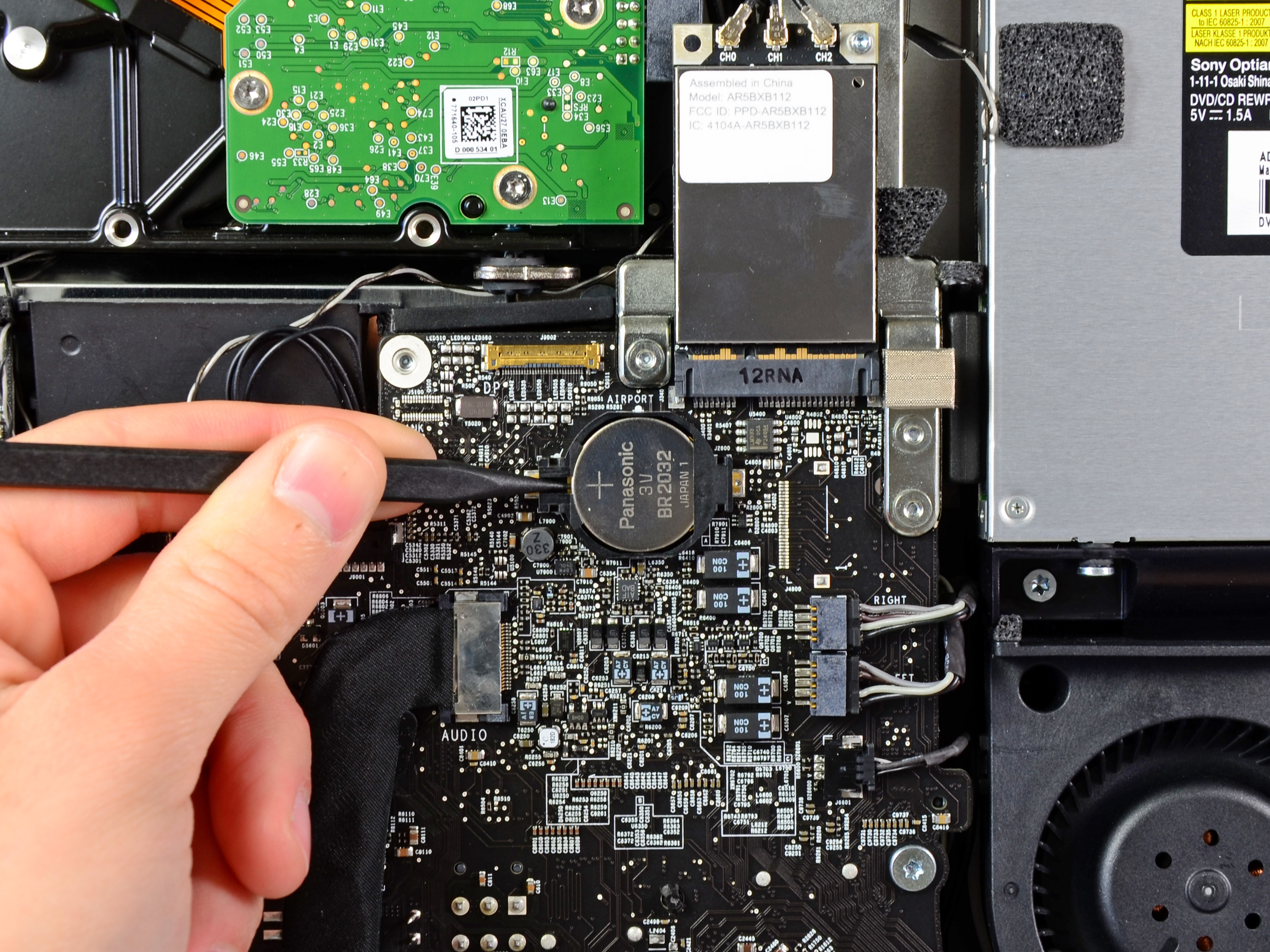

Use this guide to replace your logic board's BR 2032 PRAM battery.
Tool used on this step:Heavy-Duty Suction Cups (Pair)$14.95
Stick a suction cup near each of the two top corners of the glass panel.
If your suction cups refuse to stick, try cleaning both the glass panel and the suction cup with a mild solvent.
Use the tip of a spudger to pry the PRAM battery out of its socket on the logic board.
