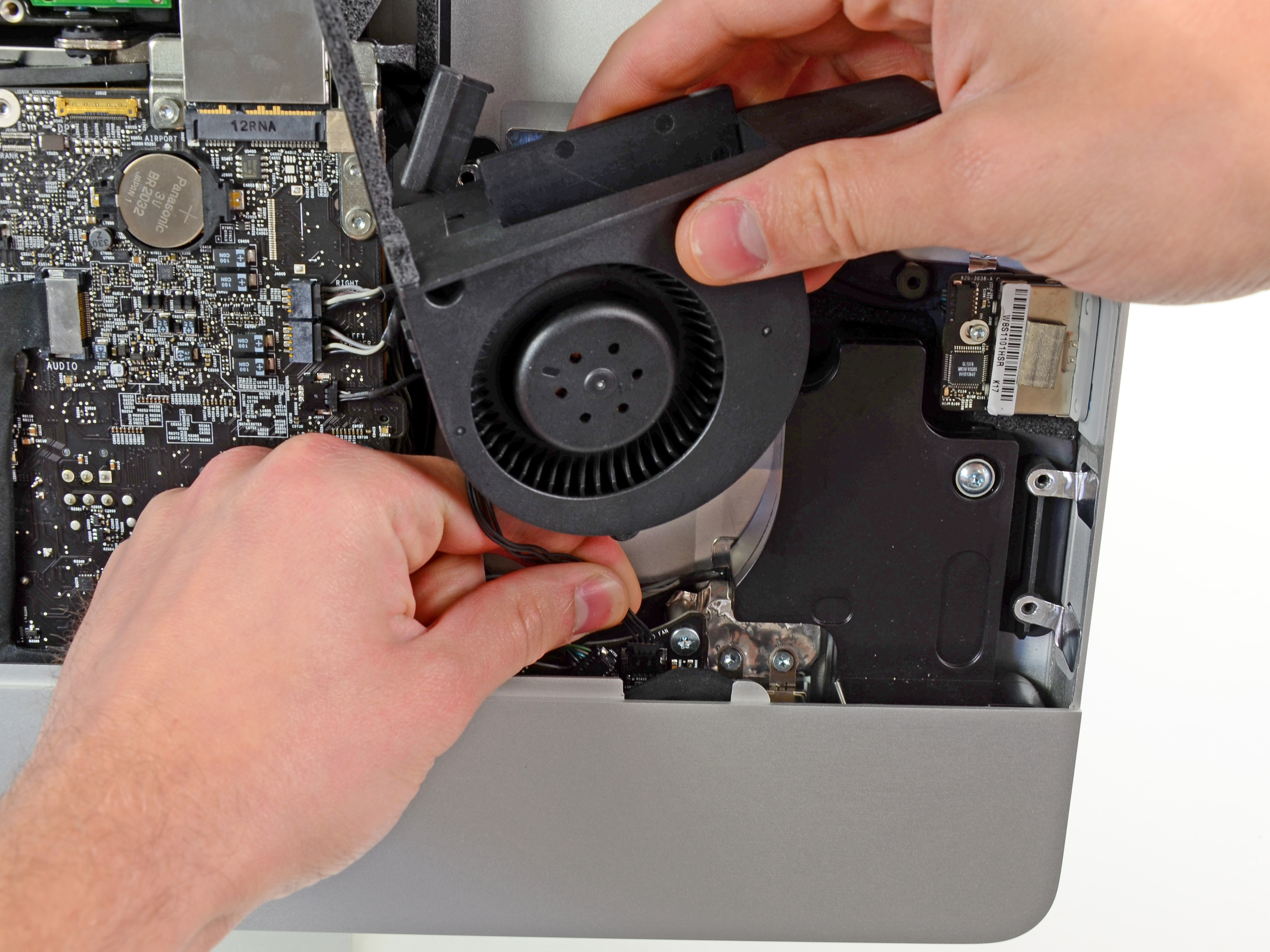

  14. iMac Intel 21.5" EMC 2428 Optical Drive Fan Replacement, Optical Drive Fan: step 14, image 1 of 1
    • Remove the single 13 mm T10 Torx screw securing the optical drive fan to the outer case.
  15. iMac Intel 21.5" EMC 2428 Optical Drive Fan Replacement: step 15, image 1 of 1
    • Pull the optical drive fan off the pins attached to the outer case.
  16. iMac Intel 21.5" EMC 2428 Optical Drive Fan Replacement: step 16, image 1 of 1
    • Pull the optical drive fan connector away from its socket on the logic board.
    • Remove the optical drive fan from the iMac.
