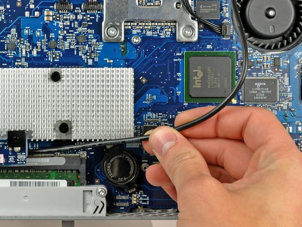

Image 1/1: The microphone connector is located near the inside of top edge of your iMac.
  • If necessary, remove the strip of tape covering the microphone cable connector.
  • The microphone connector is located near the inside of top edge of your iMac.
i posted a note on the next page about disconnecting the microphone and camera cable. may help. reed it before disconnect.
sebalancea - Reply

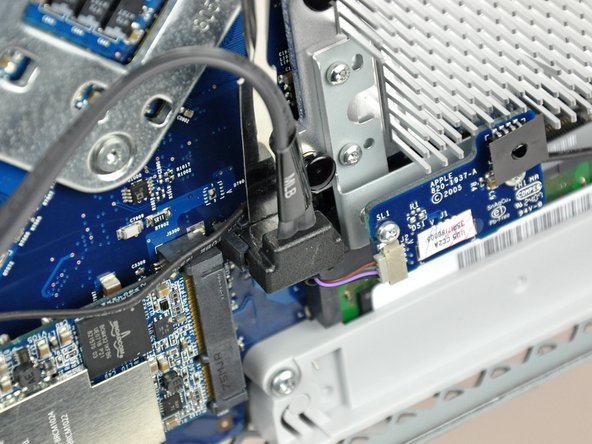

Image 1/3: Disconnect the camera cable by pulling its connector away from the socket on the camera board. Image 2/3: The camera cable connector and socket are delicate and easily bent. Remove with caution. Image 3/3: The camera cable connector and socket are delicate and easily bent. Remove with caution.
  • Disconnect the microphone cable.
  • Disconnect the camera cable by pulling its connector away from the socket on the camera board.
  • The camera cable connector and socket are delicate and easily bent. Remove with caution.
there's no need to disconnect the microphone and camera cable. you can work against a wall and carefully rest the frame and the display on the wall.
sebalancea - Reply
Quote from sebalancea:
I didn't even use the wall, I just carefully pivoted the frame backwards and laid it on the table without disconnecting the wires
Bob - Reply
Be careful. My microphone and camera cables looked a little bit different from this. My camera cable connector did NOT plug directly into the camera board (and I almost tried pulling the cable out of the board), but rather there was a cable to cable connector that was stuffed behind the monitor. I had to skip this step until the monitor was out. I have an early 2006 20" iMac.
avcaruso - Reply
My Mac had a different camera board and it didn't appear that the cables could be detached. Leaving them in place and propping up the back of the case worked for me.
gordonhamachi - Reply
I agree, no need to disconnect. I used a bunch of books (heavy books), to keep the monitor frame upright.

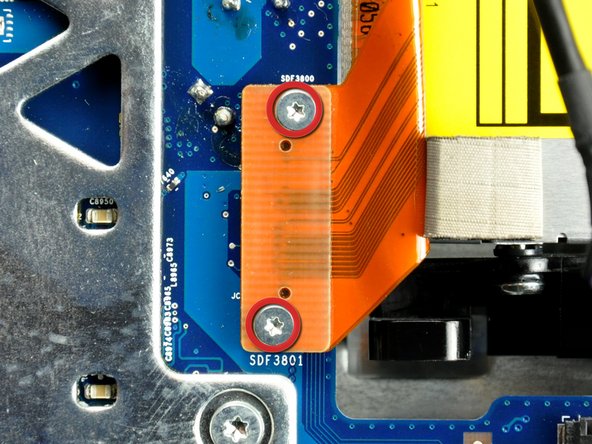

Image 1/2: Pull the display data cable connector up off the logic board by its black pull tab. Image 2/2: Pull the display data cable connector up off the logic board by its black pull tab.
  • Remove the two 5 mm T6 Torx screws securing the display data cable connector to the logic board.
  • Pull the display data cable connector up off the logic board by its black pull tab.
This would be a really good time to change the PRAM battery. They only last 4-5 years, and cost very little. It'll save another teardown in the near future. (3v CR2032)
Bob - Reply
Quote from Bob:
Good idea, I just replaced this. $5 @ radioshack.
sleestack - Reply
I found that disconnecting the display cable at the LCD end was easier. There are 2 v small clips either side of the ribbon cable, squeeze together and the cable disconnects from the panel.
KazR - Reply
on this step I just forgot (there always something to forget!!) to connect back display data cable connector to the logic board, after I replaced the hard drive. Don't worry nothing happens. Hwen I switched on the iMac and it was just functioning alright and normal but I wasn't able see anything other than a black screen :)
If you got a black screen but a normal white light on the right bottom corner, think abot the connector !
joleisa - Reply

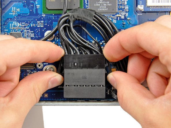

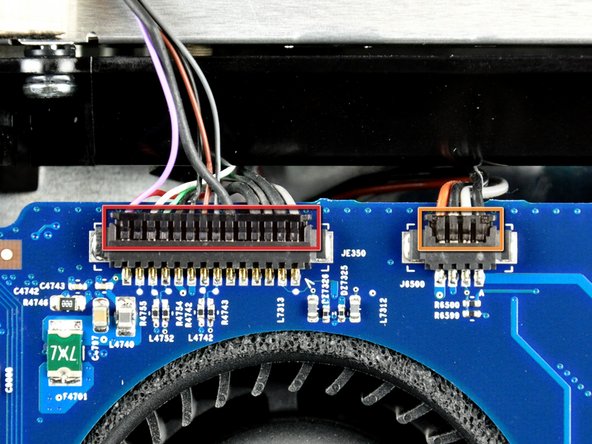

Image 1/2: These connectors are seated very tightly in their sockets. It is helpful to use your fingernails or the tip of a spudger to push the ears on either side of the connectors to dislodge them from their sockets. A small pair of hemostats helps a lot. Image 2/2: These connectors are seated very tightly in their sockets. It is helpful to use your fingernails or the tip of a spudger to push the ears on either side of the connectors to dislodge them from their sockets. A small pair of hemostats helps a lot.

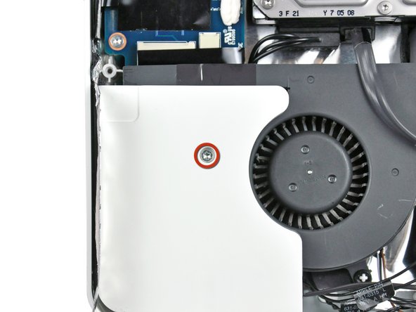

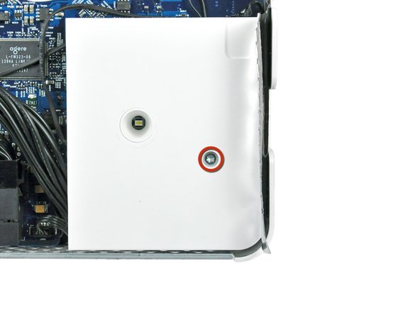

Image 1/2: Pull the left speaker out of the rear case. Image 2/2: The screw for the left speaker is longer than the screw for the right speaker.
  • Remove the single T10 Torx screw securing the left speaker to the rear case.
  • Pull the left speaker out of the rear case.
  • The screw for the left speaker is longer than the screw for the right speaker.

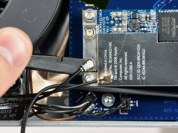

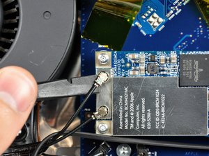

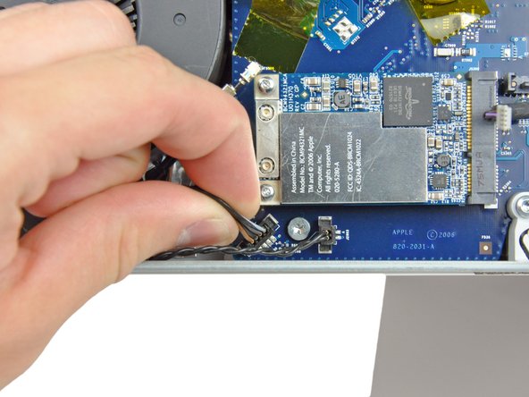

Image 1/2: Some models may have only one AirPort antenna wire. Image 2/2: Some models may have only one AirPort antenna wire.
  • Use the flat end of a spudger to pry both antenna connectors up off the AirPort Extreme card.
    • Some models may have only one AirPort antenna wire.
I only had one of these connectors on the Airport extreme card (in the lower position).
Ed Schrank - Reply
I am nearly certain I put the same connectors back in the same positions but am hoping it doesn't matter as this wasn't addressed as important to remember. Look for an update note if my airport doesn't work right away.
bhoffs - Reply

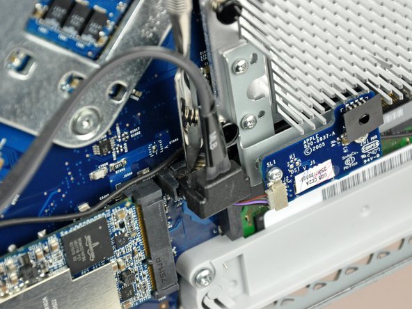

Image 1/2: The SATA connector on most iMacs tends to stick in its socket on the logic board. If you are having trouble disconnecting the SATA cable, insert a [product|IF145-012|metal spudger] or any other thin tool into the gap between the SATA connector and its socket and twist the spudger's shaft to safely separate the two pieces. Image 2/2: The SATA connector on most iMacs tends to stick in its socket on the logic board. If you are having trouble disconnecting the SATA cable, insert a [product|IF145-012|metal spudger] or any other thin tool into the gap between the SATA connector and its socket and twist the spudger's shaft to safely separate the two pieces.
  • Use a metal spudger to disconnect the SATA data cable up off the logic board.
  • The SATA connector on most iMacs tends to stick in its socket on the logic board. If you are having trouble disconnecting the SATA cable, insert a metal spudger or any other thin tool into the gap between the SATA connector and its socket and twist the spudger's shaft to safely separate the two pieces.
Be really careful disconnecting the SATA cable. Don't tug too hard, or tug at all really. I broke mine clear off the board and according to multiple sources it's not easy/worth trying to fix. So now it can't read the internal hard drive anymore.
theseekeroftruth - Reply
While pulling on the SATA cable, the entire plastic socket base came off in my hand, leaving a bunch of metal socket prongs sticking up in the air. Fortunately I was able to push the plastic socket base back onto the prongs. Next time I'm going to skip this step, as it isn't really necessary.

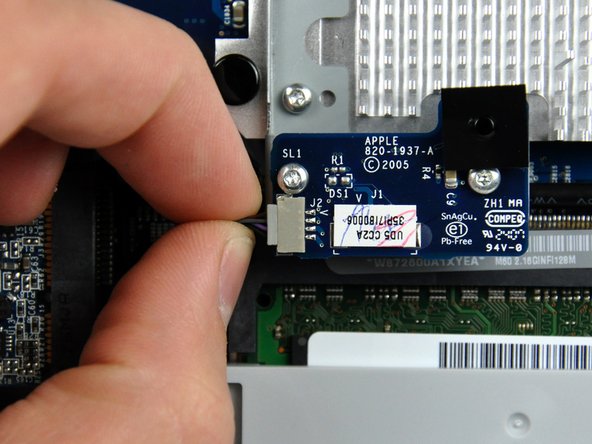

Image 1/1: Pull the connector parallel to the face of the logic board.
  • Pull the IR board cable connector away from its socket on the IR board.
  • Pull the connector parallel to the face of the logic board.
In fact it is easier to unscrew (T6) the metallic support and leave the card attached to the cables
Destouches Philippe - Reply
  • Disconnect the speaker cable connector by lifting it straight up off its socket on the logic board.
Mine was assembled with the Bluetooth connector ran such that it precludes removing the speakers completely, meaning step 28 had to be done while I was over there.
Carl Pearson - Reply

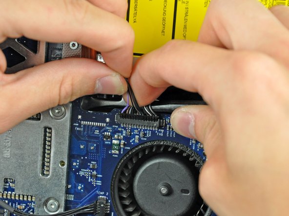

  • Disconnect the HDD fan and power button from the logic board by pulling their connectors straight up off the sockets on the logic board.

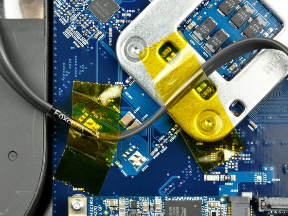

  • If necessary, remove the pieces of tape holding the SATA data cable to the logic board.
  • Move the SATA data cable away from the face of the logic board.

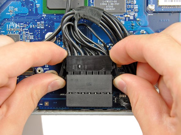

Image 1/2: After both locking arms pass their retaining tabs, it is helpful to push the arms toward the top edge of your iMac while wiggling the connector. Image 2/2: After both locking arms pass their retaining tabs, it is helpful to push the arms toward the top edge of your iMac while wiggling the connector.

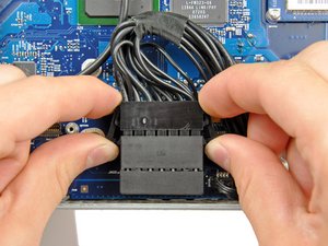

  • Disconnect the DC-In cable by simultaneously depressing both locking arms and pulling its connector away from the socket on the logic board toward the top of your iMac.
  • After both locking arms pass their retaining tabs, it is helpful to push the arms toward the top edge of your iMac while wiggling the connector.

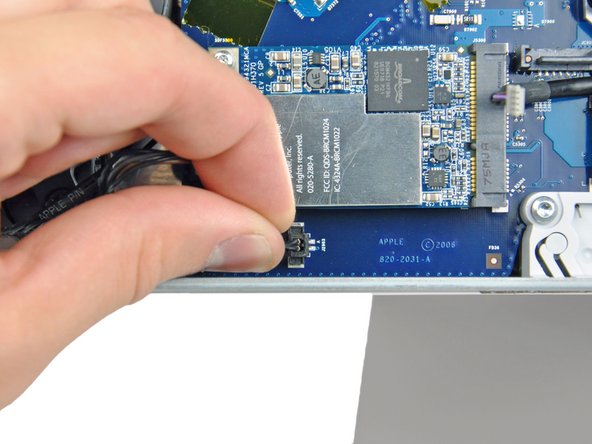

Image 1/1:
  • Pull the ambient light sensor cable connector up off the logic board.

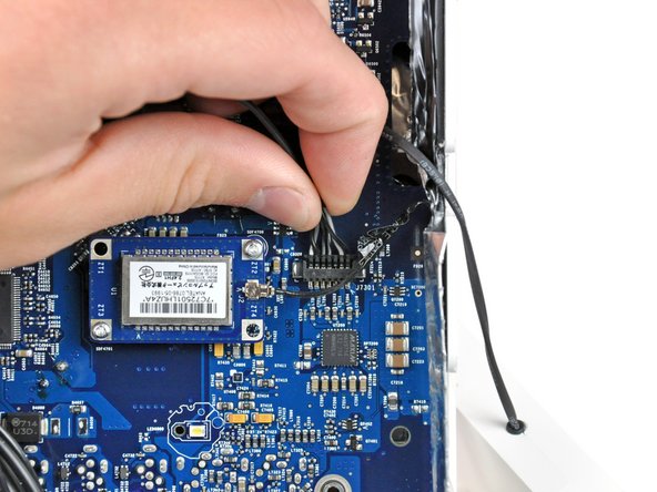

Image 1/1:

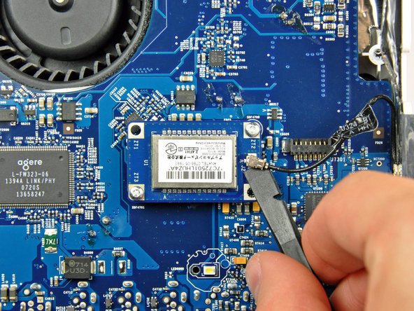

  • Use the flat end of a spudger to pry the Bluetooth antenna cable connector up off the Bluetooth board.
Apologies for the ignorance, but would using a spudger on something like the Bluetooth antenna connector necessarily break it? Will some special glue be required to re-attatch? I will definitely take this challenge up (better than buying a new computer and very rewarding), but it's little things like that that give me pause.
projectjce - Reply
Image 1/1:
  • Carefully de-route the IR board cable out from under the IR board and move it out of the way of the logic board.

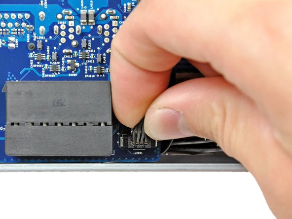

  • Disconnect the optical drive thermal sensor cable from the logic board by pulling its connector away from the socket on the logic board.

  • Remove the two T6 Torx screws securing the optical drive ribbon cable connector to the logic board.

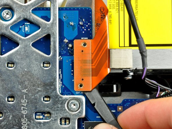

Image 1/1: The connector is most easily removed when prying from the top or bottom of the connector.
  • Use the flat end of a spudger to pry the optical drive ribbon cable connector up off the logic board.
  • The connector is most easily removed when prying from the top or bottom of the connector.
  • Bend the optical drive ribbon cable back away from the logic board.
  • Be very careful when moving the optical drive ribbon cable as it is delicate and easily ripped.

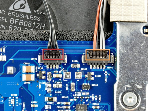

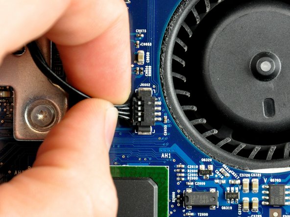

Image 1/1: Hard drive thermal sensor cable.
  • Disconnect the following connectors from the logic board:
    • Hard drive thermal sensor cable.
    • CPU fan cable.
  • When removing these connectors, it is helpful to push the ears on either side of the connector with your fingernails or the tip of a spudger toward the top edge of the iMac.

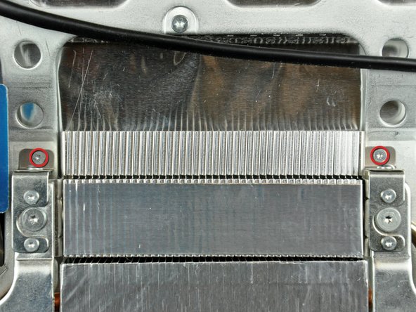

Image 1/1:
  • Remove the two T6 Torx screws securing the top of the heat sink framework to the chassis.

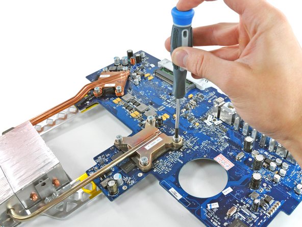

Image 1/1:

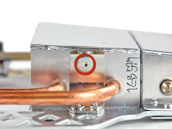

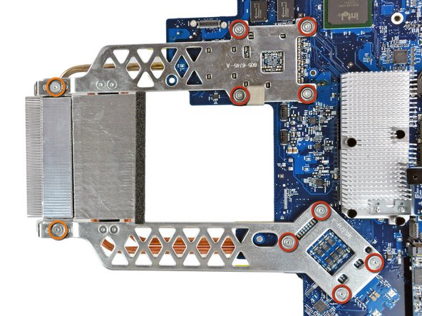

  • Remove the 6.1 mm T8 Torx screw from both sides of the heat sink nearest the logic board (two screws total).
Image 1/2: Eight 7.8 mm T8 Torx. Image 2/2: Two 6.1 mm T8 Torx.
  • Remove the following ten screws:
    • Eight 7.8 mm T8 Torx.
    • Two 6.1 mm T8 Torx.
  • If the eight screws around the processors refuse to unscrew, use a Phillips screwdriver to hold the lug from the one side of the board while you remove the Torx screw from the other side.
Image 1/2: Image 2/2:

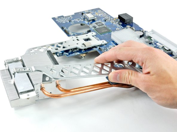

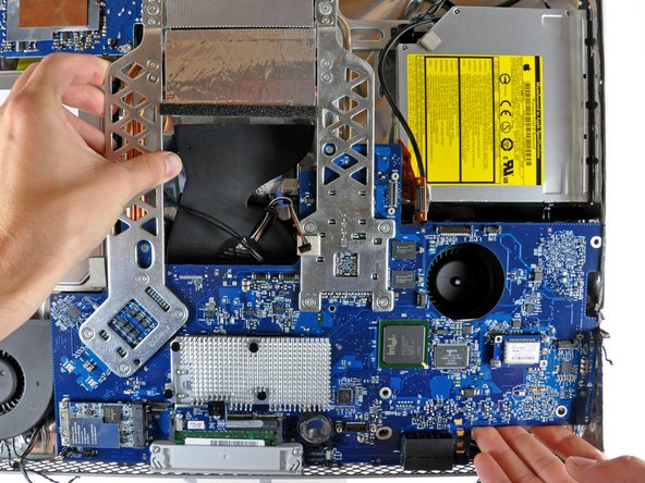

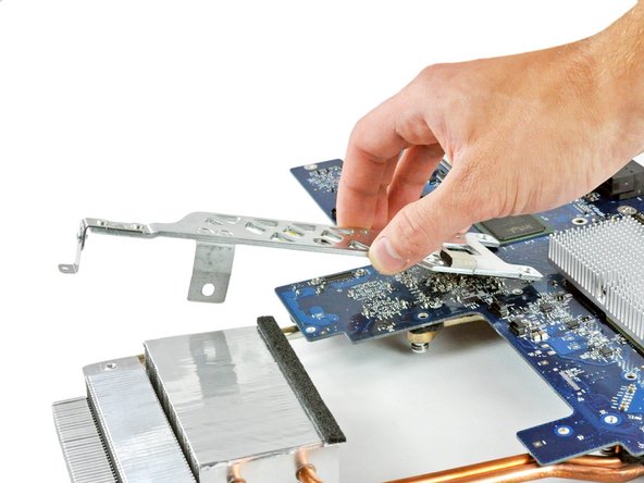

  • Carefully lift both metal heat sink brackets off the logic board.

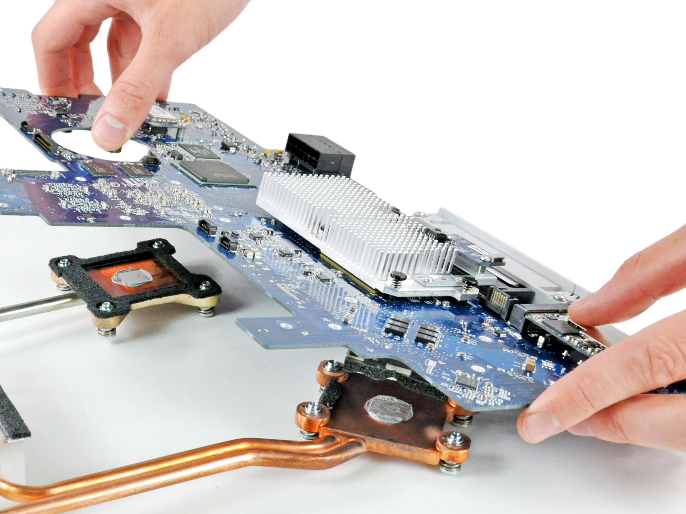

Image 1/1: If a heat sink seems to be stuck, carefully pry it away from the logic board to separate the solidified thermal paste.
  • Lift the logic board off the heat sinks.
  • If a heat sink seems to be stuck, carefully pry it away from the logic board to separate the solidified thermal paste.
  • If you need to mount the heat sink back into the iMac, we have a thermal paste guide that makes replacing the thermal compound easy.
  • During reinstallation it is helpful to install the heat sinks one at a time, starting with the one closest to the logic board.
