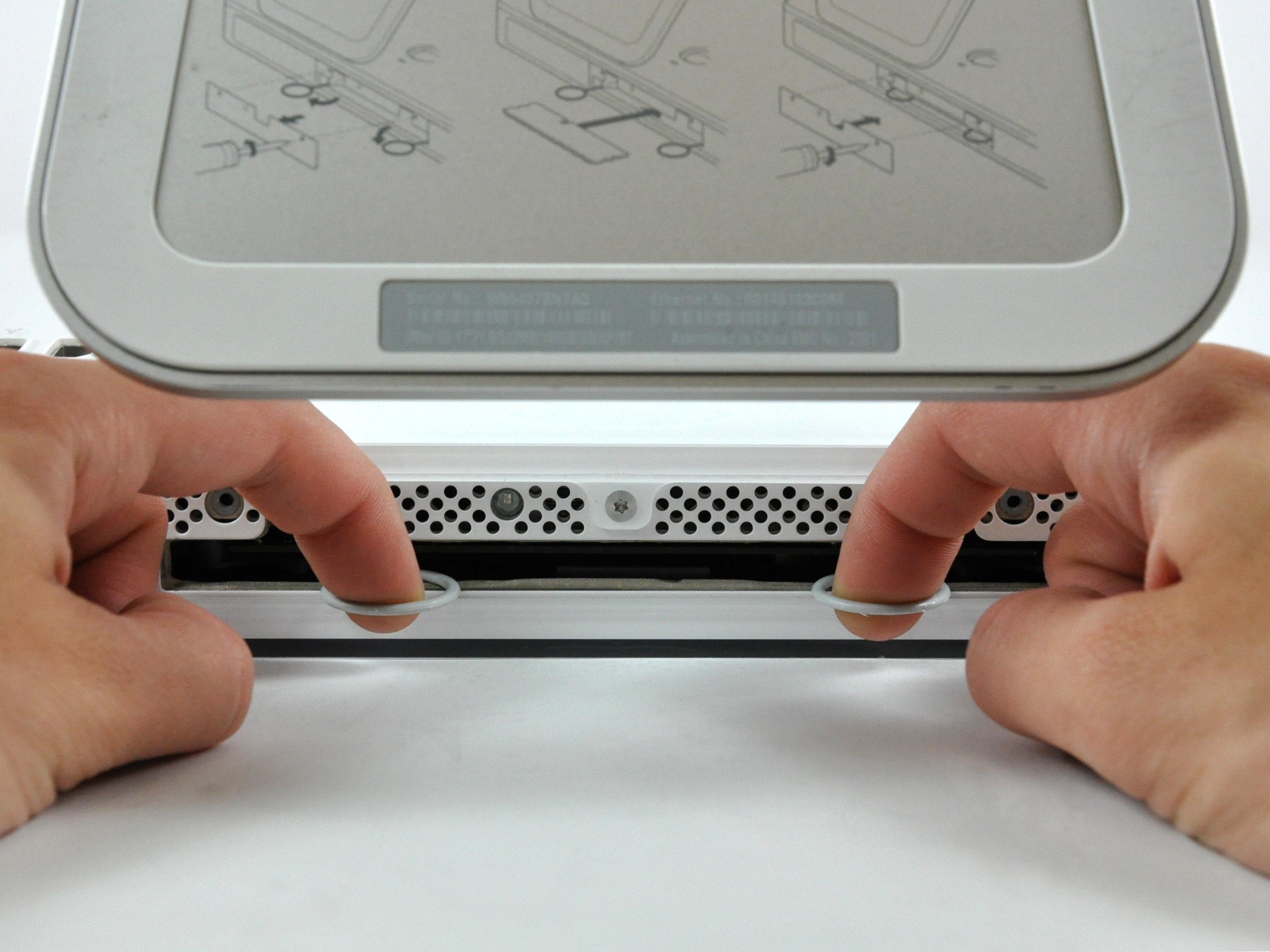

Orient the iMac face-side down on a table with the bottom edge facing yourself.
Remove the two Phillips screws securing the access door to the bottom grille of your iMac.
Remove the access door.

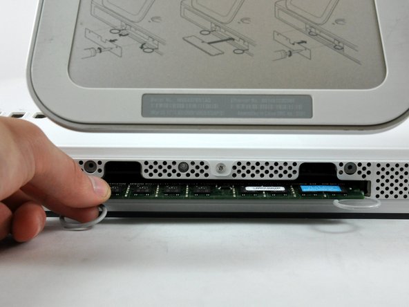

Insert your fingers into the two RAM arms and pull both arms toward yourself to eject the RAM chip.
Slide the RAM chip straight out of its socket.
