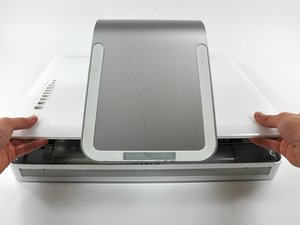

Image 1/1: Loosen the three Phillips screws securing the rear panel to the iMac.
  • Lay the iMac display-side down on a flat surface.
  • Loosen the three Phillips screws securing the rear panel to the iMac.
  • These screws are captive in the iMac. The center screw will stop turning after about 3.5 turns and the outer screws will stop turning after about 5.5 turns. Do not try to remove these screws from your iMac.
Some models (with light sensor) have only the two outboard screws.
Robert Huber - Reply

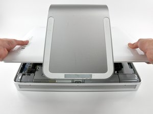

Image 1/2: Pull the rear panel toward yourself and remove it from the iMac.
  • Lift the rear panel slightly near the bottom of the iMac.
  • Pull the rear panel toward yourself and remove it from the iMac.

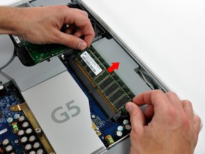

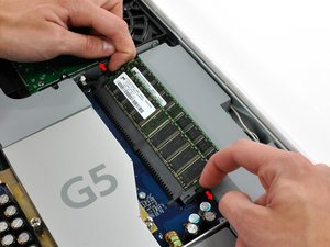

Image 1/2: Pull the RAM chip straight away from its socket.
  • Rotate each of the two RAM retaining arms away from the RAM chip.
  • Pull the RAM chip straight away from its socket.
  • Repeat this process for the other RAM chip.
  • Be sure the RAM arms are rotated fully outward before installing new RAM chips.
