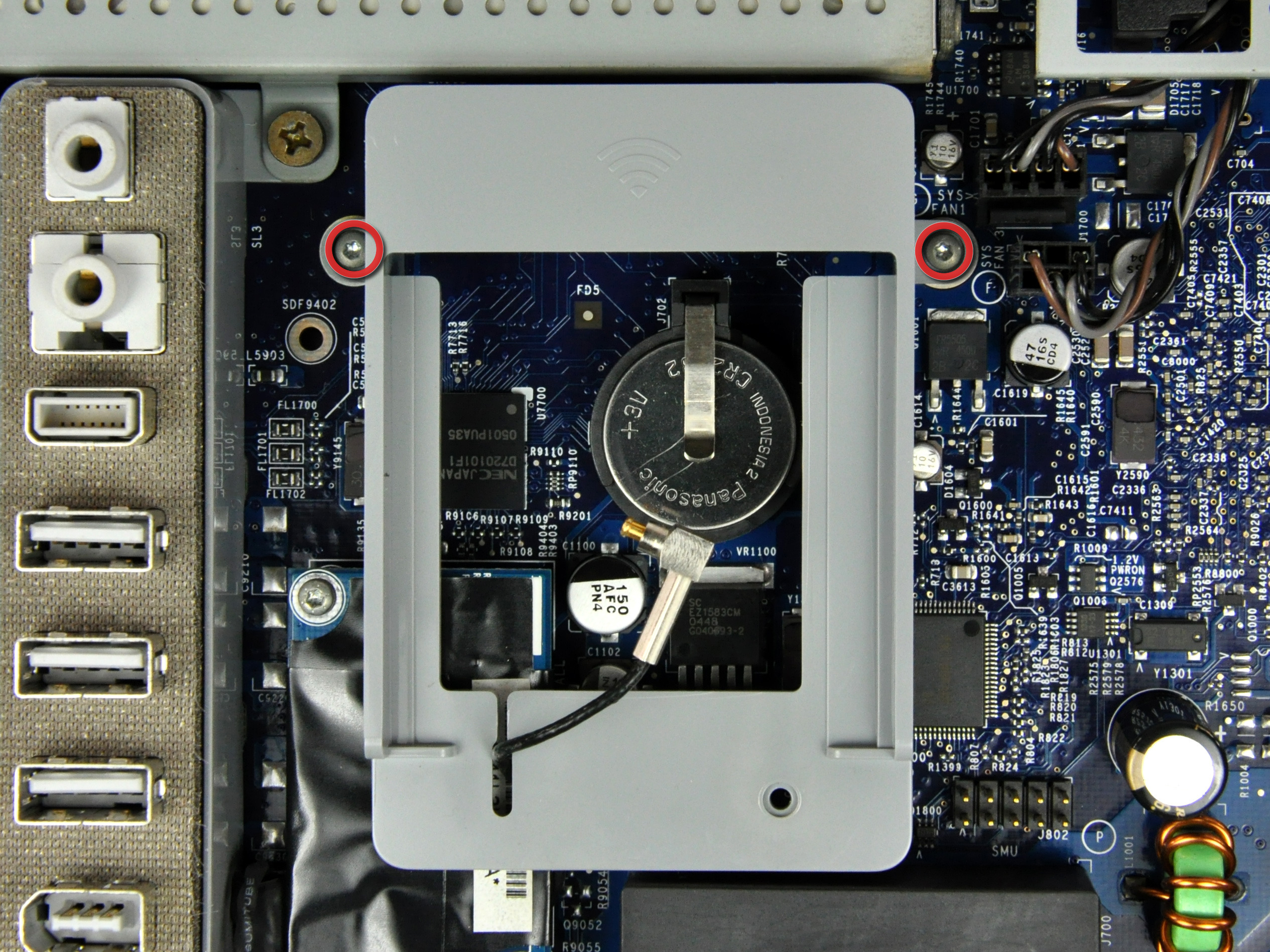

Image 1/1:
  • Remove the two 5.5 mm T6 Torx screws securing the AirPort bracket to the logic board.
Image 1/1: De-route the AirPort antenna through the slot in the AirPort bracket.
  • Slightly lift the AirPort bracket off the logic board.
  • De-route the AirPort antenna through the slot in the AirPort bracket.
