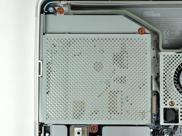

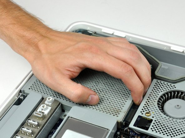

Edit Step 4 Optical Drive  ¶
Image 1/1:

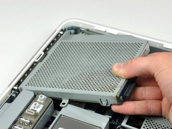

  • Remove the three 8 mm brass Phillips screws securing the optical drive to the midplane.

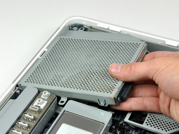

Edit Step 5  ¶
Image 1/3: Lift the free end of the optical drive just enough to clear the fan cover.  Lifting the free end of the optical drive too far may break the plastic positioning pins off the front bezel.
Edit Step 5  ¶
  • Lift the optical drive near the connector to separate it from the logic board.
  • Lift the free end of the optical drive just enough to clear the fan cover. Lifting the free end of the optical drive too far may break the plastic positioning pins off the front bezel.
  • Lift the free end of the optical drive slightly, then pull it away from the edge of the rear case to clear the two plastic positioning pins.
  • Lift the optical drive out of your iMac.
  • When reinstalling your optical drive it may be necessary to set the bezel attached to the open end of the drive on the plastic positioning pins molded into the front bezel of the iMac and pull the connector side of the drive toward the edge of the rear case, bending it outward slightly, to properly seat the connector.

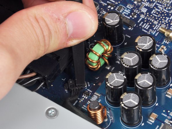

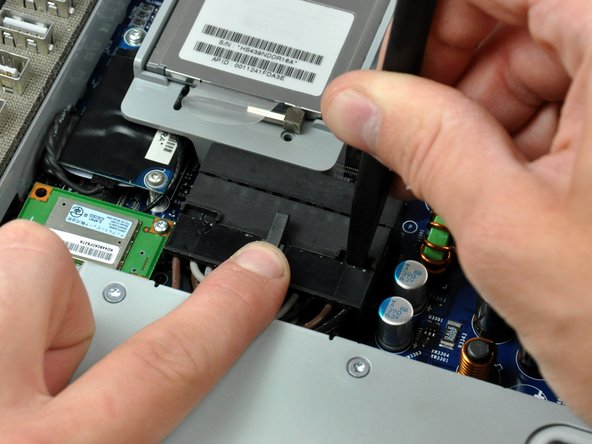

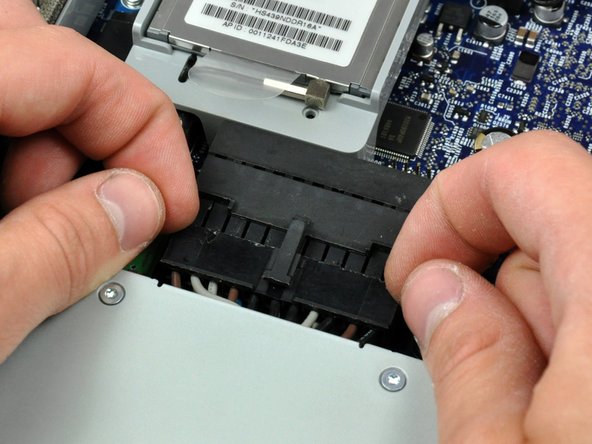

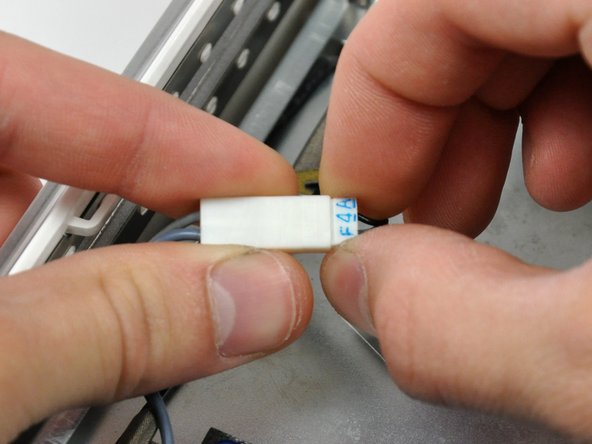

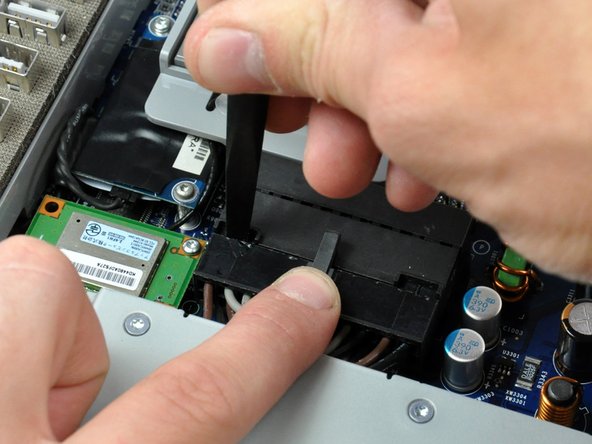

Edit Step 7  ¶
Image 1/3: Twist the heavy duty spudger to slightly separate the connector from its socket.
Edit Step 7  ¶
  • While depressing the connector lock, insert the flat end of a heavy duty spudger into the gap between the power supply connector and its socket.
  • Twist the heavy duty spudger to slightly separate the connector from its socket.
  • It will be necessary to work from alternate sides until the connector is free.
  • Your power supply may have an ambient light sensor cable attached from the power supply to the logic board. If so, carefully use a spudger to push out the cable towards you using the sides of the cable alternatively to help you slide it out.

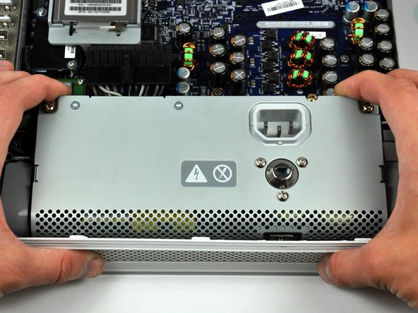

3 Edit Step 10  ¶
Image 1/2: Grab the power supply from each side and rotate its top edge toward yourself until it clears the logic board.
3 Edit Step 10  ¶
  • There are several capacitors mounted to the logic board in close proximity to the power supply. Try not to disturb them, as they are delicate and may break off the board.
  • Grab the power supply from each side and rotate its top edge toward yourself until it clears the logic board.
  • Lift the power supply out of the midplane.
  • The power supply requires a large amount of force to remove. You may need to slightly bend the edge of the front case toward yourself for enough clearance to remove the power supply.

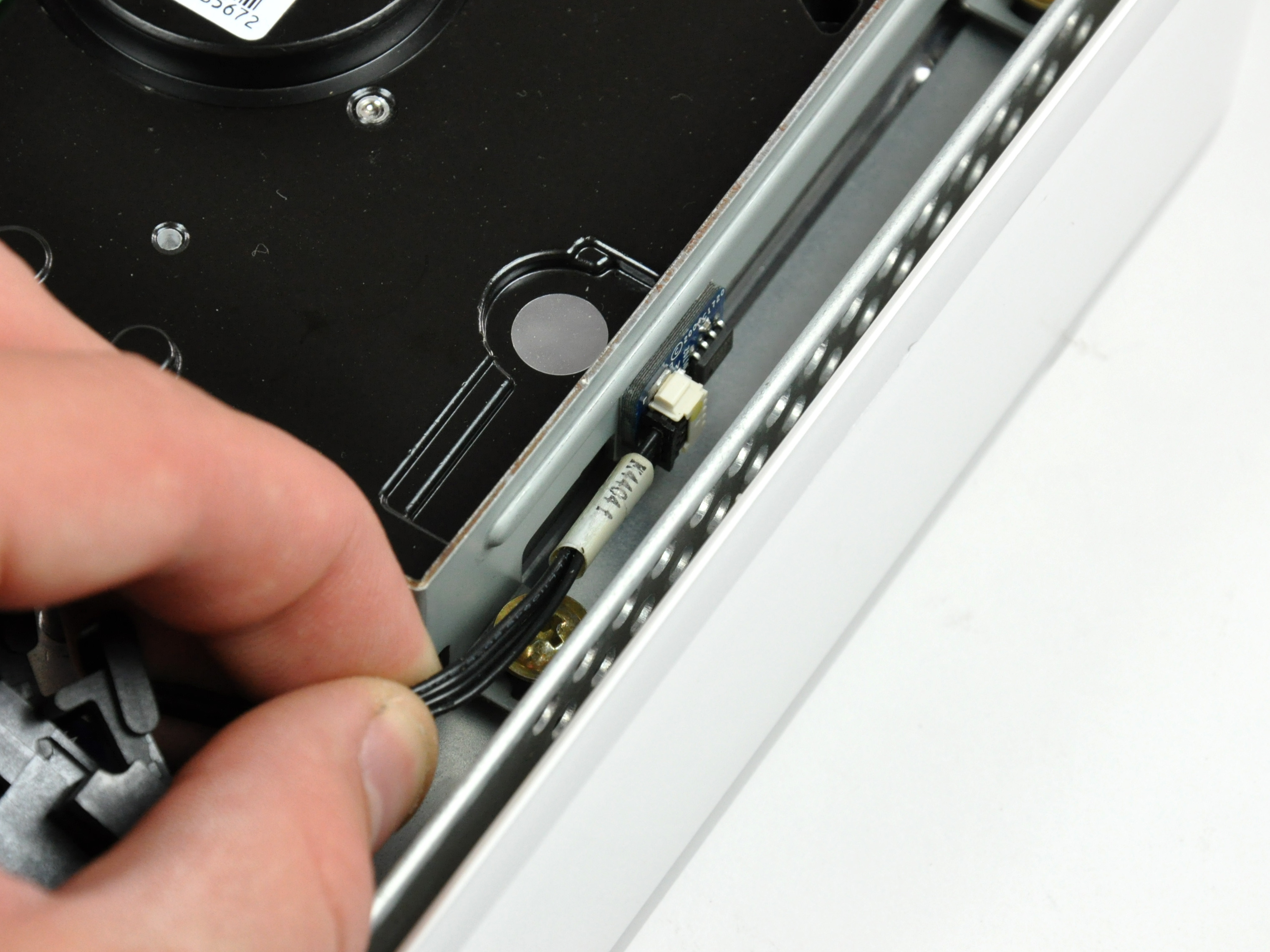

Edit Step 11 Logic Board  ¶
Image 1/1: During reassembly, use the tip of your spudger to plug the hard drive thermal sensor back into the socket on the hard drive thermal sensor board.
  • Disconnect the hard drive thermal sensor cable from the hard drive thermal sensor board.
  • During reassembly, use the tip of your spudger to plug the hard drive thermal sensor back into the socket on the hard drive thermal sensor board.

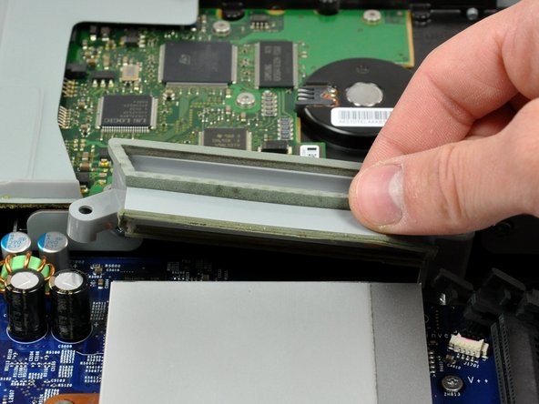

3 Edit Step 12  ¶
Image 1/2: Lift the fan duct out of the midplane.
3 Edit Step 12  ¶
  • Remove the two 13 mm T10 Torx screws securing the fan duct to the midplane.
  • Lift the fan duct out of the midplane.

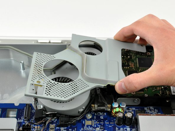

Edit Step 13  ¶
Image 1/2: The shouldered Phillips screw belongs in the lower left corner of the fan cover.
Edit Step 13  ¶
  • Remove the two Phillips screws securing the fan cover to the midplane.
  • The shouldered Phillips screw belongs in the lower left corner of the fan cover.
  • Lift the fan cover out of the midplane.

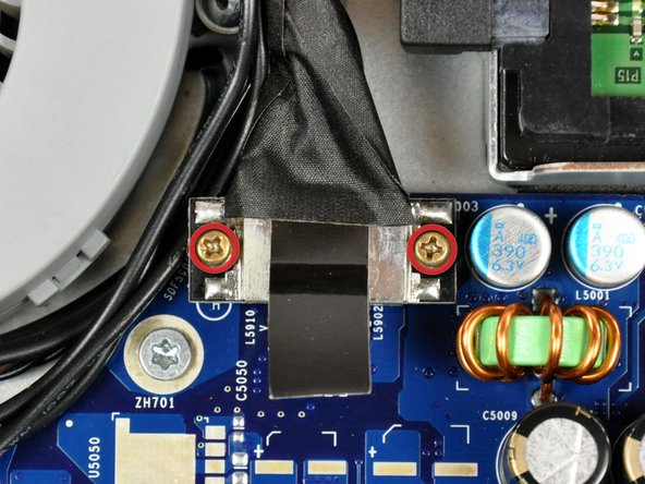

Edit Step 14  ¶

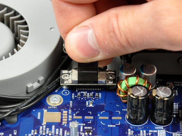

Image 1/2: Using its black pull tab, pull the display data cable connector straight up off its socket on the logic board.
Edit Step 14  ¶
  • Remove the two 7 mm shouldered Phillips screws securing the display data cable to the logic board.
  • Using its black pull tab, pull the display data cable connector straight up off its socket on the logic board.

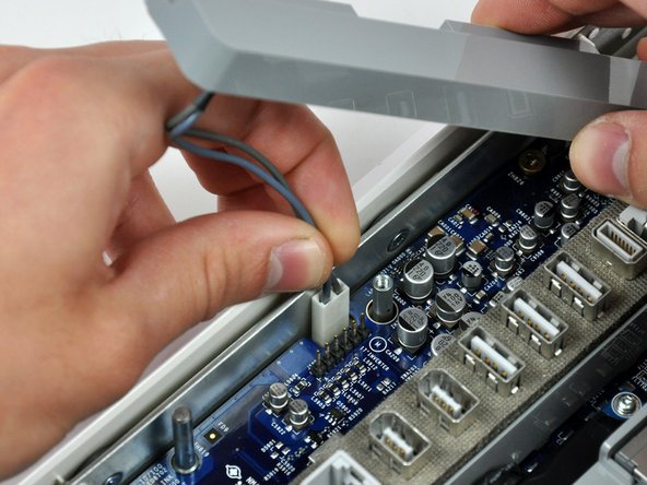

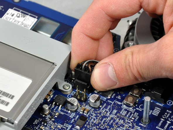

Edit Step 23  ¶
Image 1/1: If you do bend the pins during removal, use the connectors as a guide to bend them back straight.
Edit Step 23  ¶

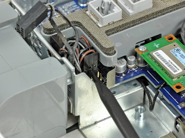

  • The connectors removed in the next few steps slide onto long pins attached to the logic board. Be sure to only pull them straight up from the logic board to avoid bending the pins.
  • If you do bend the pins during removal, use the connectors as a guide to bend them back straight.

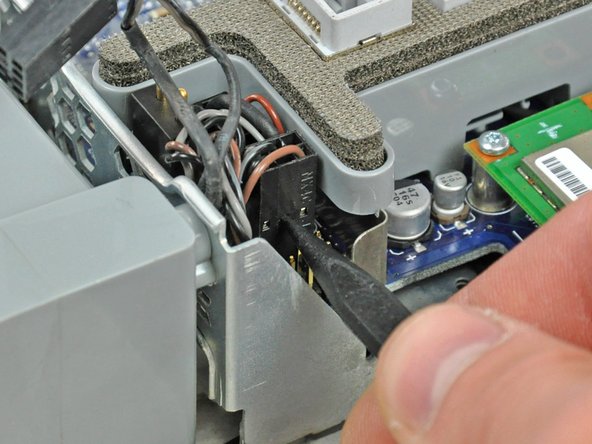

  • Use the tip of a spudger to lift the speaker cable connector from its lower edge straight up off the logic board.

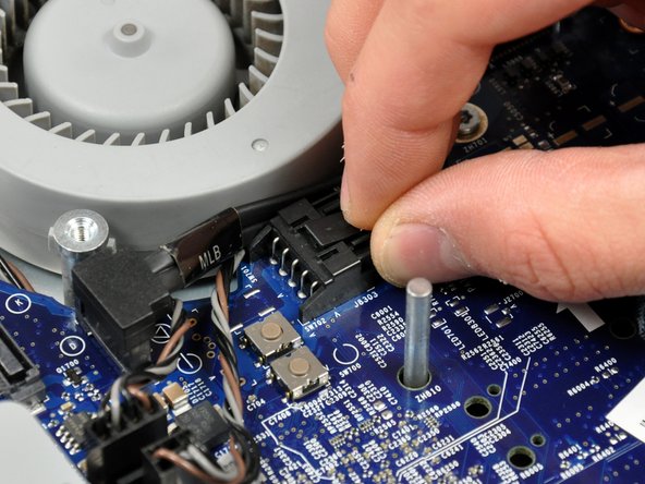

2 Edit Step 24  ¶
Image 1/2: With the spudger still inserted, lift the lower fan connector straight up off the logic board.
2 Edit Step 24  ¶
  • Insert the tip of a spudger into the center hole punched into the side of the lower fan connector.
  • With the spudger still inserted, lift the lower fan connector straight up off the logic board.
  • The speaker cable connector attaches to the pins closest to the power supply. It is the only connector with four wires. The microphone cable attaches to the pins furthest away from the power supply and is the only connector with a dark orange wire.

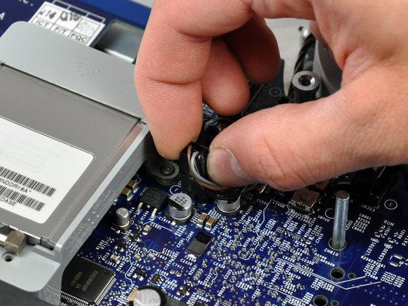

Edit Step 25  ¶
Image 1/1:
Edit Step 25  ¶
  • Use the tip of a spudger to lift the microphone cables enough to grab the microphone cable connector and pull it straight up off the logic board.

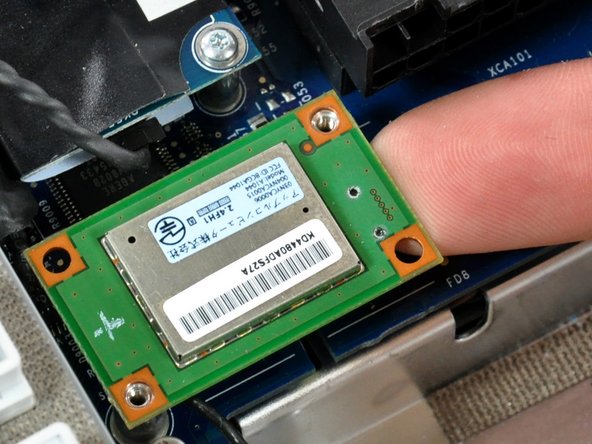

Edit Step 26  ¶
  • Using its attached pull tab, lift the AirPort card slightly and pull it straight away from its socket.
  • This step does not apply to the ALS model; this bracket is not present. The card attaches with a pair of T6 Torx screws and looks slightly different from this picture.

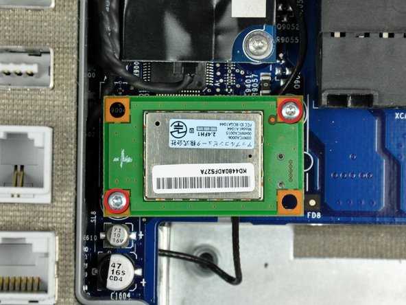

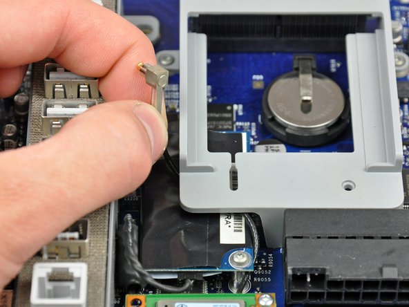

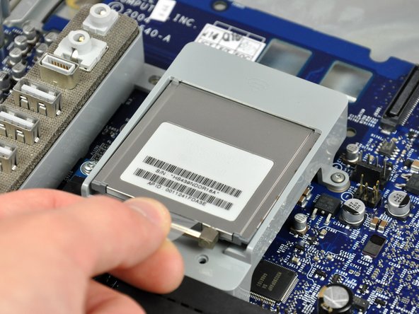

Edit Step 27  ¶

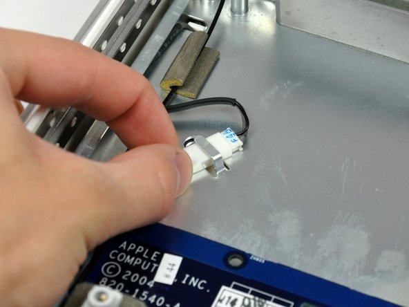

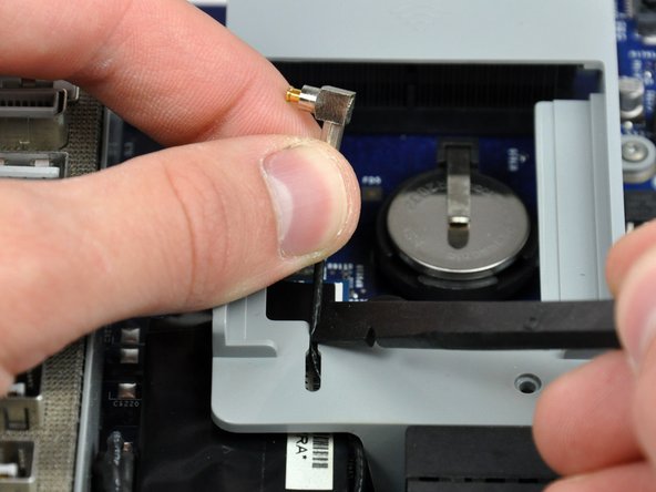

Image 1/1: Push the spudger away from the AirPort card to disconnect the AirPort antenna.
Edit Step 27  ¶
  • Insert the flat end of a spudger between the antenna connector and the body of the AirPort card.
  • Push the spudger away from the AirPort card to disconnect the AirPort antenna.
  • When reassembling your iMac, be sure to insert the AirPort card the way it was before disassembly.
  • This step does not apply to the ALS model.

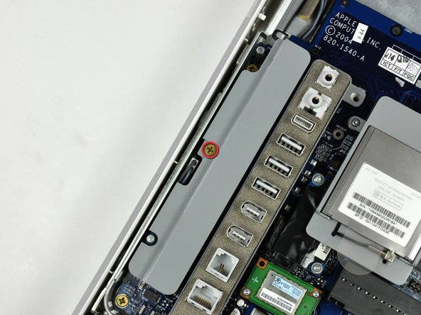

1 Edit Step 29  ¶
Image 1/1: Some models may not have a blue tooth module.
1 Edit Step 29  ¶
  • Remove the two T6 Torx screws securing the Bluetooth board to the logic board.
  • Some models may not have a blue tooth module.

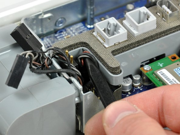

Edit Step 30  ¶
Image 1/2: Be sure to lift the Bluetooth board from its right edge only.  Trying to lift it up from any other side will shear the connector off the Bluetooth board.
Edit Step 30  ¶
  • Depending on your iMac model, the bluetooth board may be blue. Use your fingertip to lift the Bluetooth board from its right edge, disconnecting it from its socket on the logic board.
  • Be sure to lift the Bluetooth board from its right edge only. Trying to lift it up from any other side will shear the connector off the Bluetooth board.
  • Use the flat end of a spudger to pry the Bluetooth antenna connector up off the Bluetooth board.

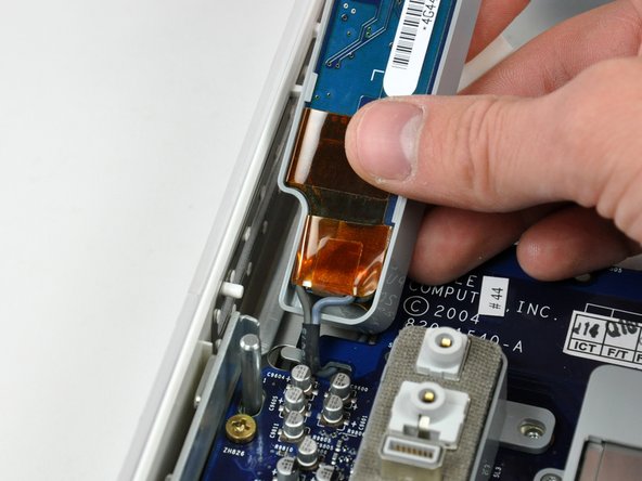

Edit Step 31  ¶
Image 1/1: Six 7 mm T10 Torx.
Edit Step 31  ¶

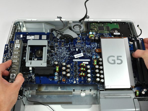

1 Edit Step 32  ¶
Image 1/2:
1 Edit Step 32  ¶
  • Lift the logic board from its left edge to clear the two positioning pins connected to the midplane.

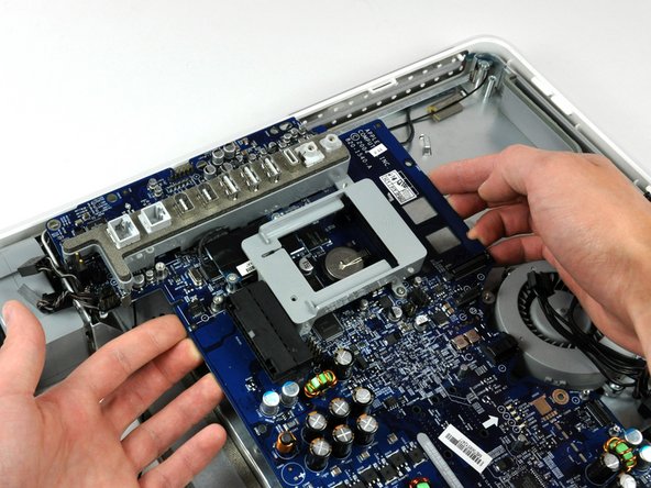

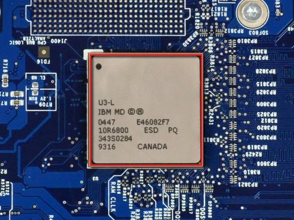

1 Edit Step 33  ¶
Image 1/2: When reinstalling your logic board, be sure to clean and apply a new layer of thermal paste to the U3 chip (highlighted in red) located on the underside of your logic board as well as its copper heat sink attached to the midplane.
1 Edit Step 33  ¶
  • Grab the logic board from both edges and lift it out of the midplane, minding any cables that may get caught.
  • When reinstalling your logic board, be sure to clean and apply a new layer of thermal paste to the U3 chip (highlighted in red) located on the underside of your logic board as well as its copper heat sink attached to the midplane.
  • We have a thermal paste guide that makes applying thermal paste a snap.

James Janota - Reply
Bend the case at the rear panel clamp enough to clear the panel clamp while lifting out the power supply using the two captive screws as handles.
timothychilders - Reply
Rolling the power supply towards you while lifting using the captive screws helps get it past the captive back cover screw from step 4.

My iMac doesn't have the BlueTooth card. Instead, the antenna is connected to the board with a plastic clip which is easy to remove and reattach.
