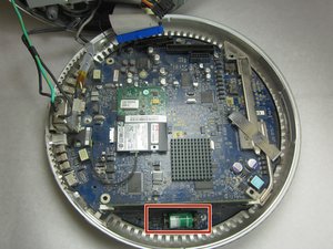

  • Remove the four 25mm T-15 screws.
Image 1/2: Be gentle with the wires still connected to the logic board  so as not to ruin the cables.
  • Open the housing plate.
  • Be gentle with the wires still connected to the logic board so as not to ruin the cables.
  • A fixed plug connector between the logic board and upper unit will cause some resistance. Pull gently but firmly.

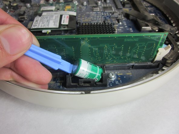

Image 1/2: Insert new battery.
  • Gently remove the battery from its holder using the plastic opening tool.
  • Insert new battery.
