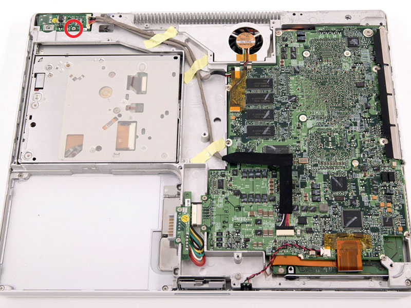

  17. iBook G4 14" 933 MHz-1.33 GHz DC-In Board Replacement, DC-In Board: step 17, image 1 of 1
    • Remove the single Phillips screw securing the DC-In board.
  18. iBook G4 14" 933 MHz-1.33 GHz DC-In Board Replacement: step 18, image 1 of 1
    • Disconnect the DC-In cable from the logic board.
  19. iBook G4 14" 933 MHz-1.33 GHz DC-In Board Replacement: step 19, image 1 of 1
    • Deroute the cable from around the optical drive, removing tape as necessary, and angle the DC-In board out of its compartment.
