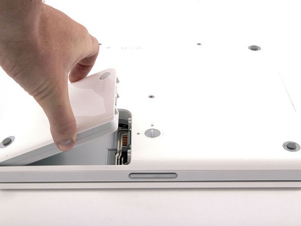

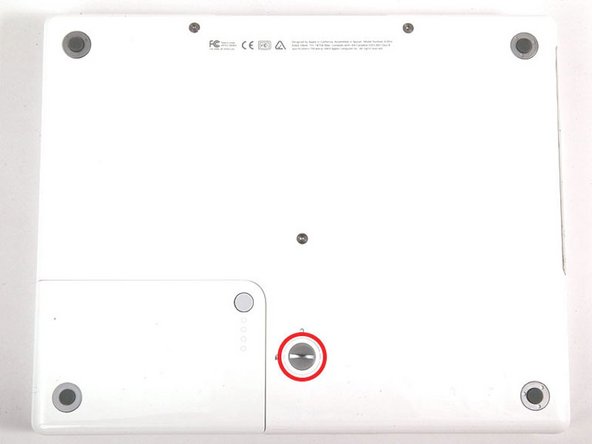

  • Use a coin to rotate the battery locking screw 90 degrees clockwise.

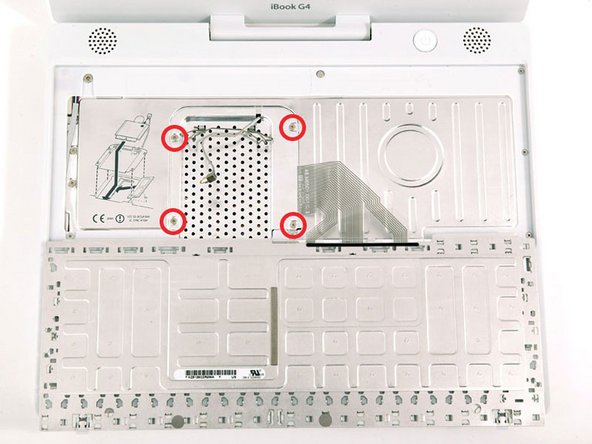

  • Remove the four silver Phillips screws that secure the RAM shield.
very gently magnetizing my small philips screwdriver was a HUGE help when putting all the tiny screws back into place... all said and done, there will be a lot of teeny screws to be taken out and put back. To magnetize the screwdriver, I just rubbed it several times in one direction (similar to sharpening a knife) across a strong refrigerator magnet... you only want it just strong enough to hold a screw, but not so magnetized that it corrupts your new hard drive!
Sean Franzen - Reply

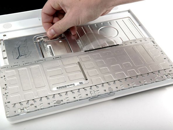

Image 1/1: Make sure that you reconnect the keyboard cable before replacing the RAM shield.
  • Pull the keyboard cable up from the logic board, holding the cable as close to the connector as possible.
  • Make sure that you reconnect the keyboard cable before replacing the RAM shield.

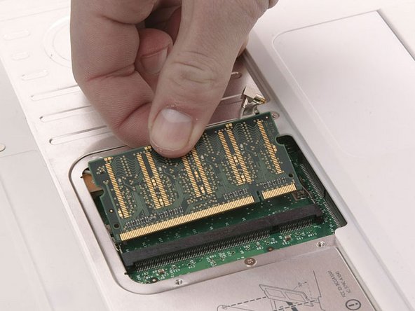

  • Release the tabs on each side of the RAM chip at the same time. These tabs lock the chip in place and releasing them will cause the chip to "pop" up.
Image 1/1:
  • Pull the chip directly out from its connectors.
