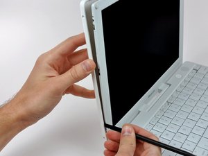

Image 1/1: Carefully lift the upper case slightly and move it toward the front of the computer to reveal the trackpad connector.  Use a spudger or your finger to disconnect the trackpad connector hidden beneath the white plastic tab.
  • Before you can yank the upper case off, you must disconnect the trackpad connector, the blue and white power cable, and speaker cable as described in the next steps. Be especially careful with these cables; never pull directly on the cables, but use a spudger to pry up the connector directly.
  • Carefully lift the upper case slightly and move it toward the front of the computer to reveal the trackpad connector. Use a spudger or your finger to disconnect the trackpad connector hidden beneath the white plastic tab.
  • After disconnecting the track pad connector, carefully rotate the upper case away from you and rest it against the display.

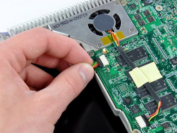

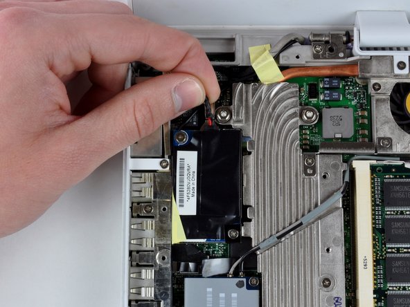

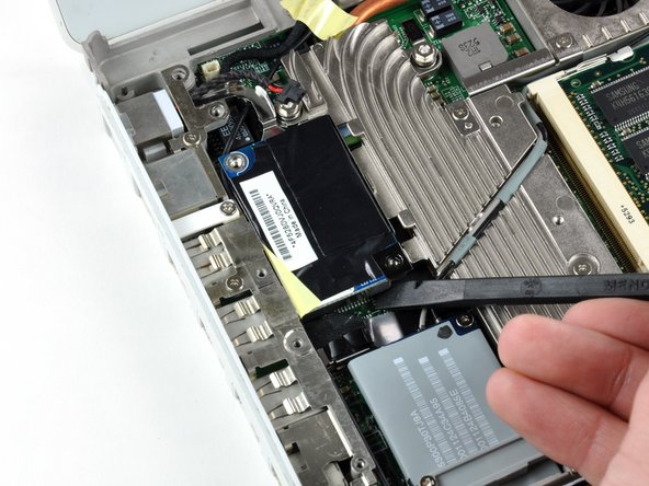

Image 1/1: Use the sharp end of a spudger to disconnect the speaker cable connector.
  • The connectors at the ends of the following cables are attached very firmly to the sockets on the logic board. Pulling directly on the cable will either separate the cable from its connector or the socket from the logic board.
  • Use the sharp end of a spudger to disconnect the speaker cable connector.
The speaker cable connector was very tightly connected into the socket. When I tried to take it out the socket came right off the motherboard. In this case, in order to pull out the connector plug you must hold down the socket at the same time to make sure it isn't pulled from the motherboard.
tbj240 - Reply
i got a used book and opened it to exchange the hd to a bigger one. i found the airport/bluetooth cards connective socket dislocated and the speaker cables' socket as well. now i've led the free end of the speaker cable together with its connector through the opening of the kensington lock outside the case (no easy task but it went through) to fix a jack which goes into the headphones plug.
channy8 - Reply
The male connector came out with the female one right off my logic board. I tied very carefully gluing it back. Appears that isnt enough; will need to be soldered back into place if I aver want to have sound again. USB, Bluetooth or AirPlay/AirTunes seem to be my remaining options.

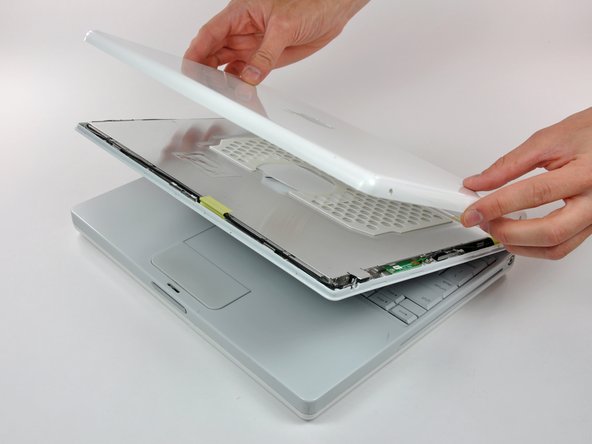

Image 1/2: It is very easy to break the connector from the board, so be careful. Image 2/2: The key is to apply force in two directions, down to keep the surface board connections intact, up to release the connector.
  • Using the sharp end of a spudger, disconnect the connector for the blue and white power cables. Again, be careful to pry up only on the connector.
  • It is very easy to break the connector from the board, so be careful.
  • The key is to apply force in two directions, down to keep the surface board connections intact, up to release the connector.
  • The upper case is now free and can be removed from the computer.
Be careful with this step, when I did I was stuck with glue on the cable connector of the card.
JCarlos19 - Reply
Warning, be extremly carful with this step! I lift the hole socket from the board. :(
Its not cool to have a new "big" HD in a computer without powerbutton!
And belive me it is really a tiny work to solder it in place again.
hugobass - Reply

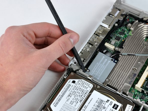

  • Lift the small plastic retaining bracket up and out of the computer.

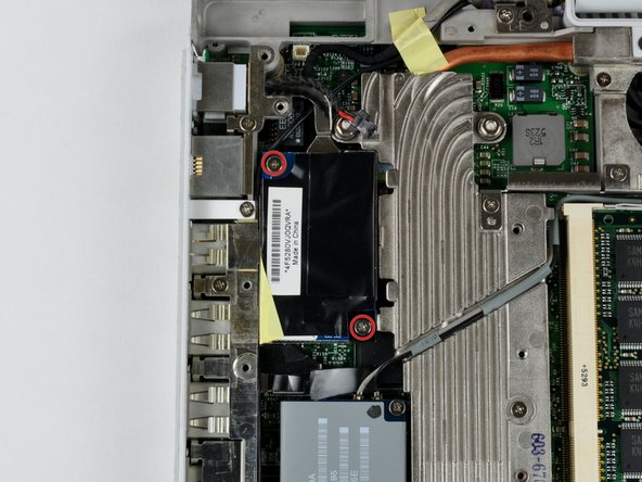

Image 1/1:

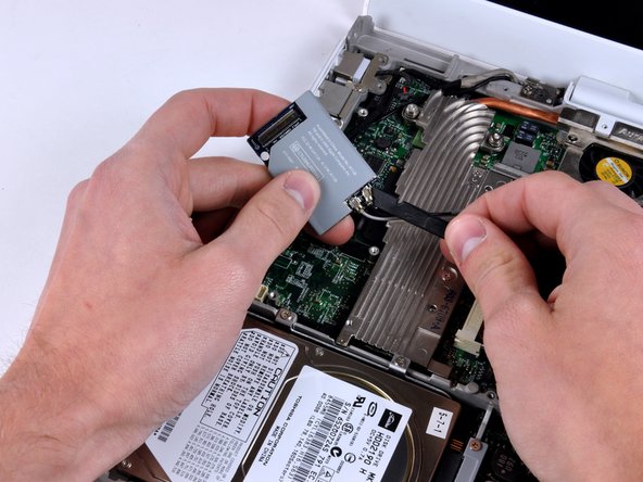

  • Using a spudger, pry up the AirPort/Bluetooth board from the end closest to the hard drive. Be sure to pry against the metal framework, as shown in the picture.
Image 1/1: Remove the AirPort/Bluetooth card from the computer.
  • Hold the AirPort/Bluetooth board in one hand and use a spudger to disconnect the two antenna cables.
  • Remove the AirPort/Bluetooth card from the computer.

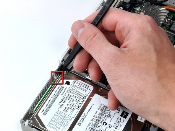

  • The cable you're about to remove is very fragile - do not pull directly on the wires. Instead, try to pry up the connector directly, using a spudger or a small flathead screwdriver if necessary.
  • Disconnect the microphone cable at the front of the computer, between the left side of the hard drive and the metal framework, removing tape as necessary.
  • Although not absolutely essential, removal of the hard drive will give enough space to remove the connector with your fingers.

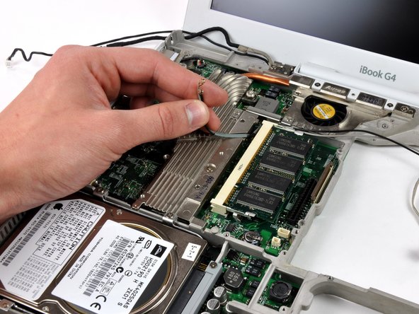

Image 1/1:
  • De-route the AirPort antenna cables from the heat sink.

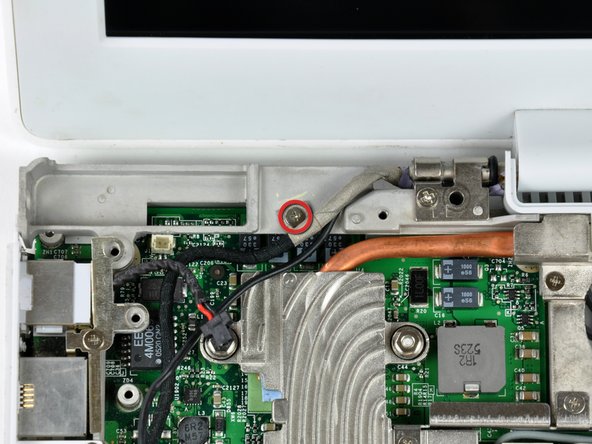

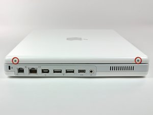

Image 1/1: The screws go in the outer holes on each side (you can see the threads in the correct hole).

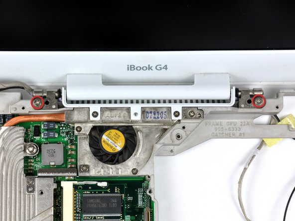

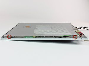

  • Support the display with one hand and remove the single Phillips screw on either side of the hinge (two screws total).
  • The screws go in the outer holes on each side (you can see the threads in the correct hole).
Image 1/1: Display remains.
  • Tilt the display back, freeing it from the two metal alignment posts holding the hinges in place, and lift it from the computer.
  • Display remains.

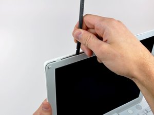

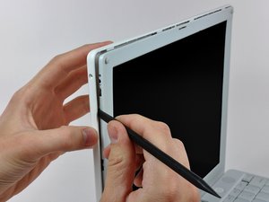

Image 1/2: Rotate the spudger away from the display to pry the rear bezel off the front bezel. Image 2/2: Rotate the spudger away from the display to pry the rear bezel off the front bezel.
  • Insert the flat end of a spudger perpendicular to the face of the display into the gap between the front and rear bezels near the upper left corner of the display.
  • Rotate the spudger away from the display to pry the rear bezel off the front bezel.

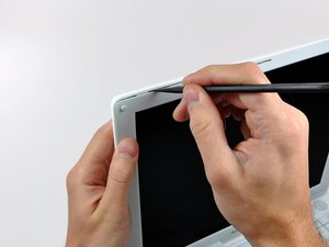

  • Run your spudger along the top edge of the front display bezel to evenly separate the two bezels.

  • Lift the rear bezel off the display assembly.

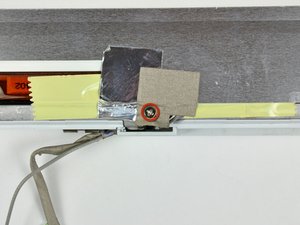

Image 1/2: Use the tip of a spudger to remove the small washer under the screw you just removed. Image 2/2: Use the tip of a spudger to remove the small washer under the screw you just removed.
  • Remove the single screw inserted through the piece of EMI tape near the bottom edge of the display (it's the first of the two clutch cover screws).
  • Use the tip of a spudger to remove the small washer under the screw you just removed.

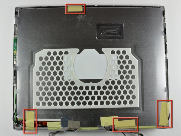

Image 1/1:
  • Remove the pieces of readily removable tape from around the perimeter of the display.

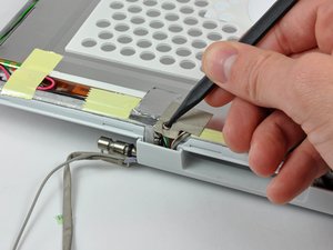

Image 1/2: Peel back the piece of tape securing the display data cable ground loop to the thin steel LCD cover. Image 2/2: Peel back the piece of tape securing the display data cable ground loop to the thin steel LCD cover.
  • Remove the piece of aluminum tape near the center of the LCD cover.
  • Peel back the piece of tape securing the display data cable ground loop to the thin steel LCD cover.

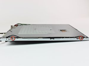

  • Remove the two Phillips screws securing each side of the LCD to the clutch hinge frame (four screws total).
Image 1/1:

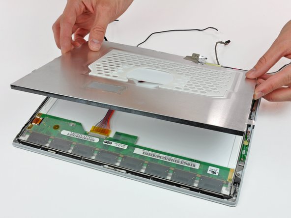

  • Lift the thin steel LCD cover off the LCD.

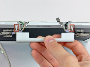

Image 1/1:

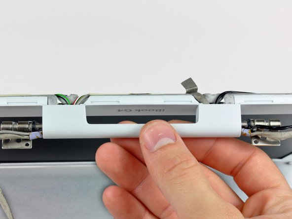

  • Remove the second of the two Phillips screws securing the clutch cover to the cast aluminum frame of the clutch hinges.

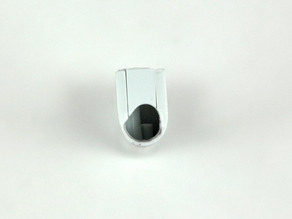

Image 1/3: Keep track of the two covers that close the ends of the clutch cover. The third picture shows their correct orientation on the clutch cover. Image 2/3: Keep track of the two covers that close the ends of the clutch cover. The third picture shows their correct orientation on the clutch cover. Image 3/3: Keep track of the two covers that close the ends of the clutch cover. The third picture shows their correct orientation on the clutch cover.
  • Pull the clutch cover away from the front of the display.
  • Keep track of the two covers that close the ends of the clutch cover. The third picture shows their correct orientation on the clutch cover.
To reinstall the two covers, hold one with tweezers, push clutch cover up. Tilt it and do the other side.
tommalschaert - Reply

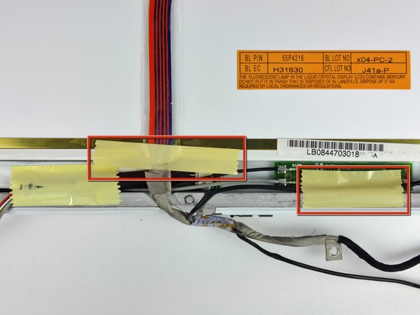

  • Remove the two pieces of tape over the display data/microphone cables near the lower edge of the display.
Check the microphone cable where it enters the display. The outer layer is often cracked and this causes the microphone to short out. Wrap a single layer of the yellow tape around the area where it touches the screen metal frame.

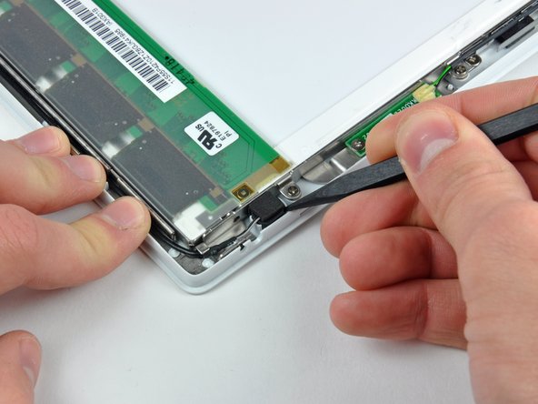

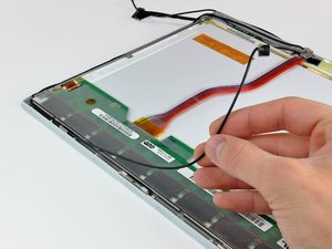

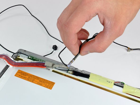

Image 1/2: De-route the microphone cable from around the top and side of the display. Image 2/2: De-route the microphone cable from around the top and side of the display.
  • Use the tip of a spudger to lift the microphone out of the front bezel.
  • De-route the microphone cable from around the top and side of the display.

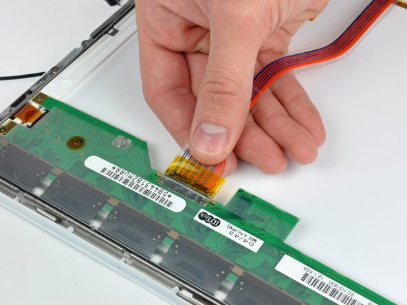

Image 1/2: Pull the connector parallel to the face of the LCD. Image 2/2: Remove the display data cable from the display.
  • Disconnect the display data cable by pulling its connector away from the socket on the LCD.
  • Pull the connector parallel to the face of the LCD.
  • Remove the display data cable from the display.
