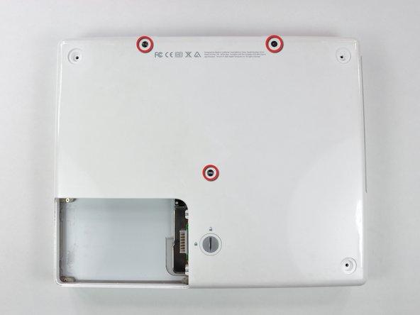

Image 1/1:
  • Remove the three newly-revealed Phillips screws.
Image 1/1:

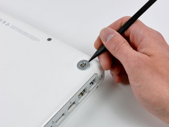

  • Use a spudger or small flathead screwdriver to pry up the three metal rings that housed the rubber bumpers.
I bought & used the tool kit that you sell for this repair. The 3 rings came off when the screws came out--maybe because the screw bit holder is magnetized.
syl57 - Reply
Image 1/1: The shorter screw is in the center of the computer.
  • Remove the three hex screws using a T8 Torx screwdriver.
  • The shorter screw is in the center of the computer.
I found T9's rather than T8's.
gdavids57 - Reply
I found 2mm allen screws in this location
rneumann - Reply

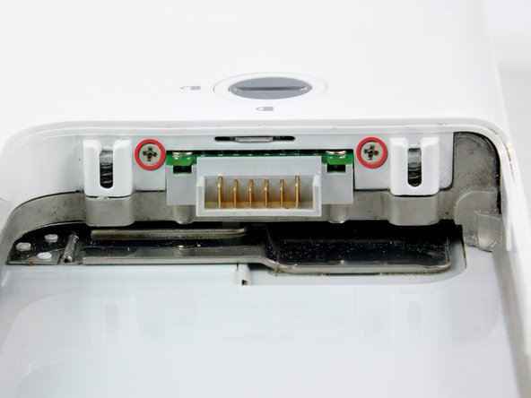

Image 1/1:
  • Remove the two 4.5 mm Phillips screws on either sides of the battery contacts.

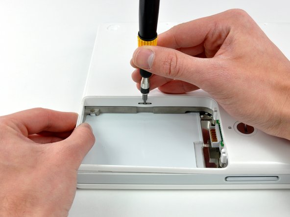

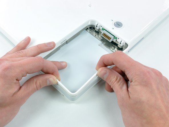

Image 1/1: Push the thin rims of the lower case surrounding the battery compartment in, bending them past the tabs, and then lift up to free that corner of the lower case.
  • Breathe deeply. Trying times are ahead, but we promise the lower case does come off.
  • Push the thin rims of the lower case surrounding the battery compartment in, bending them past the tabs, and then lift up to free that corner of the lower case.
When I did this, it helped to start around the disc drive
kleitscs - Reply
I find that a stiff nylon guitar pick will work if you don't have a spudger.
discodamon - Reply
I didn't find this step difficult at all. I have very short nails. I imagine a woman with long nails might have a problem grasping the rim and pulling up.
syl57 - Reply
Definitely read the rest of the instructions now. I struggled at first... I was using my ipad with the step by step instructions and didnt scroll down past this photo, so I didnt see the sequence of how to loosen the tabs. in fact I didn't know where the tabs might be... Only discovered that part when I reassembled it. The spudger didn't work for me. Too soft, I used mostly a thin very small screwdriver.
manyanelson - Reply

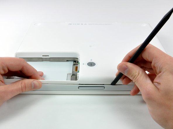

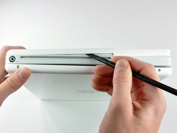

  • Run a spudger along the seam between the lower case and upper case on the front of the computer to free the tabs locking the lower case. Pull up on the lower case and continue to use the spudger as necessary until you hear three distinct clicks.
Steps 7-9 were effortless for me.
syl57 - Reply

  • Continue to run the spudger around the front right corner. There are two tabs on the port side of the computer, one near the front corner and one near the sound-out port.
Image 1/1:
  • There are three tabs over the optical drive that must be released before the lower case can come off. Slide the spudger into the lower case above the optical drive and run it toward the back of the computer until you hear three distinct clicks.
Image 1/1: Turn the computer so that the back is facing you and pull the lower case up and toward you until the back tabs pop free.
  • The front and sides of the lower case are now free.
  • Turn the computer so that the back is facing you and pull the lower case up and toward you until the back tabs pop free.
  • It may be helpful to jiggle the case up and down.
Steps 10-12 were just as easy. I bought & used the Spudger, too.
syl57 - Reply
this required a little more force than I felt comfortable with at first.
Dave - Reply

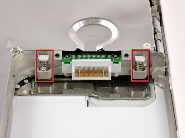

  • Remove the small greasy springs with white plastic caps from either side of the battery contacts.
  • Have patience and follow the directions, the end result is up to you. In my case it worked. But I was a Technician TRW Automotive. and worked on Air Bag modules that was returned from customer's that needed them analyzed. I just retired after 26 years.

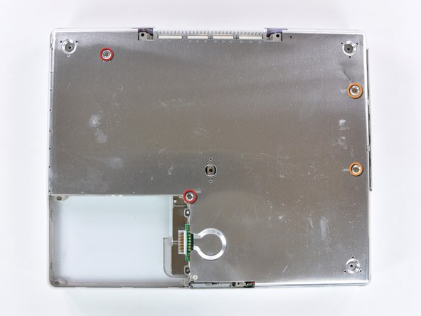

Image 1/1: Two 3 mm Phillips.
  • Remove the following 4 screws from the bottom shield:
    • Two 3 mm Phillips.
    • Two 7.5 mm Phillips.
This is where things got interesting for me. I had 4 missing screws! I don't know if it came from Apple like that (highly doubtful) or if it was returned to me without the screws from the Apple Store repair I had done to replace the Latch (more likely, huh?).
syl57 - Reply

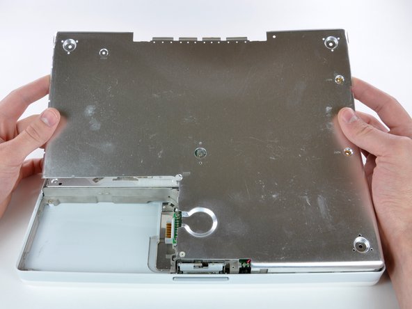

Image 1/1:
  • Lift the bottom shield off.

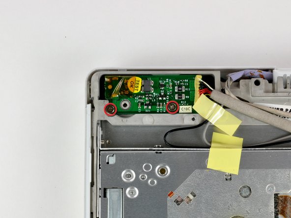

  • Remove the two Phillips screws securing the DC-In board, removing tape as necessary.
Be careful here as the actual DC silver connector is raised from the chipboard so once you remove the screws use the spudger to gently lift out the DC IN board itself. There's some rubber casing around the silver connector too which got caught on the plastic casing of the laptop which required a bit of gentle poking to get free...
loughlin - Reply
Again, I was missing a screw here--the left one! The process of removing this part was not a problem.
syl57 - Reply
Is it necessary to remove DC cable?
rickyzhang - Reply
@rickyzhang Yes, in order to remove the top case, this is required.
CL Johnson - Reply

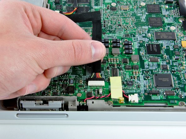

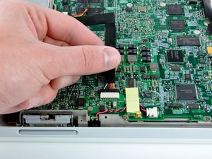

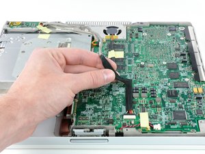

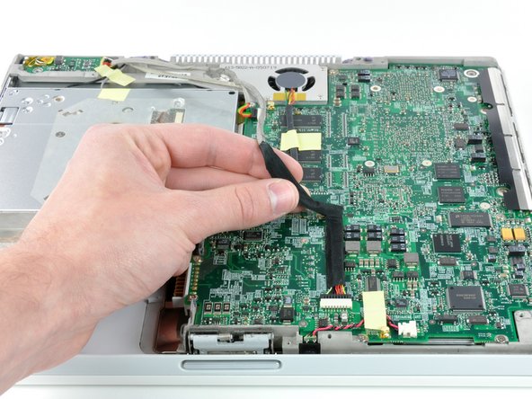

Image 1/2: Disconnect the DC-In cable from the logic board and angle the DC-In board out of its compartment. Image 2/2: Disconnect the DC-In cable from the logic board and angle the DC-In board out of its compartment.
  • Deroute the cable from around the optical drive, removing tape as necessary.
  • Disconnect the DC-In cable from the logic board and angle the DC-In board out of its compartment.
Also, once I removed it, I thought there was more to do. It happened so quickly and effortlessly! I kept wondering when the difficult and trying part was coming. I was kind of disappointed by the lack of the challenge, but that's OK! The difficult part came from reversing the directions and getting the shield back in place. A cable covering on the back edge under the shield slipped out and prevented the metal tabs from seating correctly. Once I figured that out, it was smooth sailing!
syl57 - Reply
