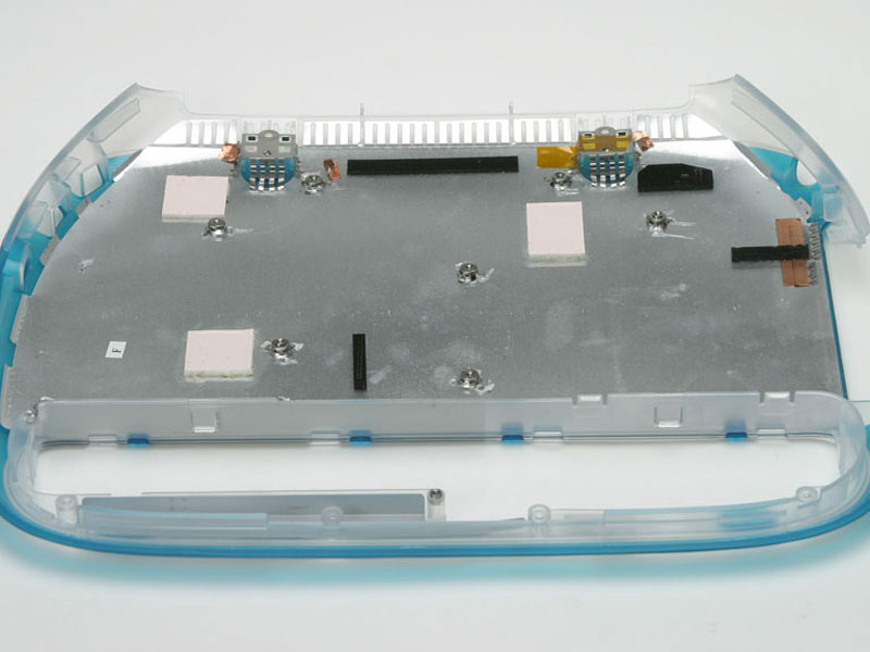

  42. iBook G3 Clamshell Lower Case Replacement, Lower Case: step 42, image 1 of 1
    • Lower case remains.
