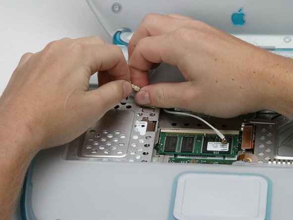

  • Hold the airport card in one hand and use your other hand to remove the antenna cable.

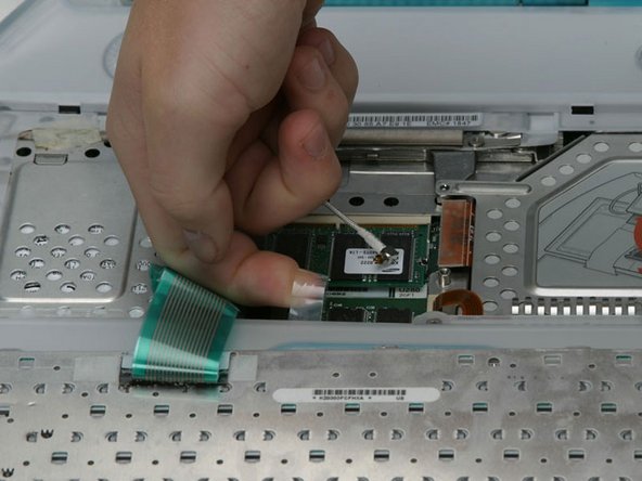

  • Remove the two Phillips screws that secure the RAM shield.
Image 1/1:
  • Grasp the wire metal bracket on top of the RAM shield and pull upward to remove the shield.

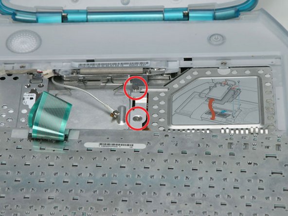

  • Pull up the keyboard connector cable by its clear plastic loop.

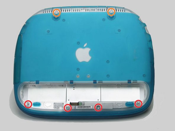

  • Turn the computer over so that the bottom is facing up.
  • Remove the following Torx screws:
    • Four short T8 Torx near the battery compartment.
    • Two long T8 Torx near the hinges.

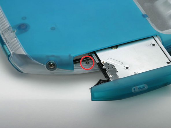

Image 1/1: Remove the silver Phillips screw from the plastic casing.
  • Pull the CD-ROM drive tray partly out.
  • Remove the silver Phillips screw from the plastic casing.

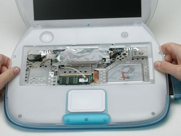

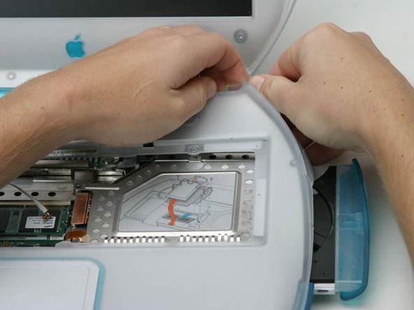

Image 1/1: Push out the rim of the lower case and pull up on the upper case, grasping it just to the left of the optical drive.
  • Do not lift the upper case too far without first disconnecting the audio cable.
  • Push out the rim of the lower case and pull up on the upper case, grasping it just to the left of the optical drive.
  • Repeat the above step on the upper left corner of the upper case, grasping the bottom left corner of the upper case.

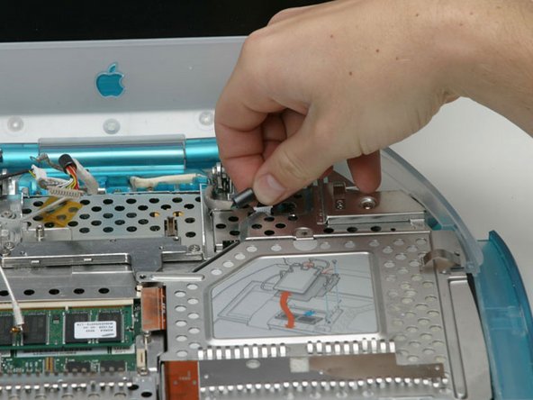

  • Disconnect the audio cable.
Image 1/1: You may be thinking you're about to break your upper case. Not to worry - the tabs holding the upper and lower cases together are very strong. Simply apply even pressure and continue to rotate the upper case up and away from the screen until it comes free.
  • Grasp the upper case on either side of the keyboard space and rotate up and away from the screen.
  • You may be thinking you're about to break your upper case. Not to worry - the tabs holding the upper and lower cases together are very strong. Simply apply even pressure and continue to rotate the upper case up and away from the screen until it comes free.
When replacing the upper case, test the trackpad button to make sure it clicks before proceeding. If it does not operate properly, remove the upper case and reattach it.

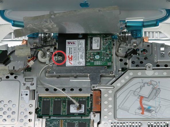

Image 1/1: Remove the longer Phillips screw from the middle-rear of the modem shield.
  • Remove the following Phillips screws:
    • Remove the longer Phillips screw from the middle-rear of the modem shield.
    • Remove the three identical Phillips screws, two on either side of the EMI fingers, and the remaining one on the right side of the modem shield.
    • Remove the larger Phillips screw that secures the EMI fingers to the modem board.
  • Remove the EMI fingers.

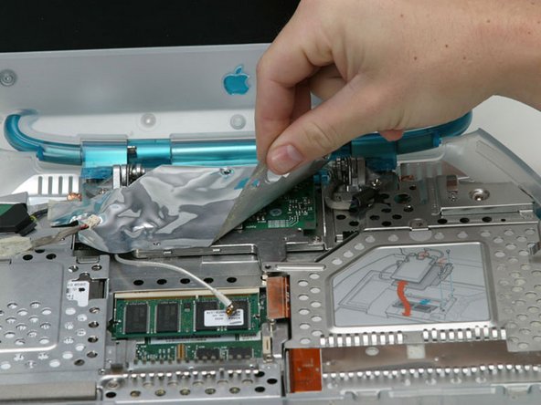

Image 1/1:
  • Peel the modem shield away from the metal framework below, working from the right front and moving to the left.

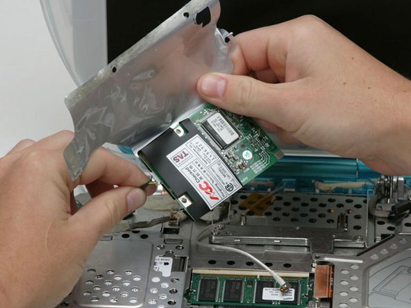

Image 1/1: Pry up the right side of the modem.
  • Remove the Phillips screw from the left side of the modem.
  • Pry up the right side of the modem.
Image 1/1:
  • Lift the modem partially out and disconnect the cable on the left side.

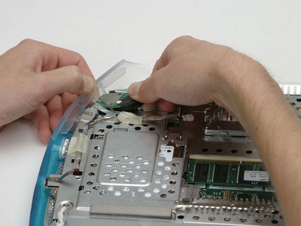

Image 1/1: Peel up the airport cable from beneath the yellow tape.
  • Remove the Phillips screw from the left hinge.
  • Peel up the airport cable from beneath the yellow tape.

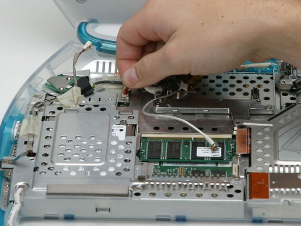

  • Disconnect the large display data cable from the logic board and deroute it from the plastic and metal tabs.
Image 1/1:
  • Disconnect the backlight cable from the logic board and deroute it.

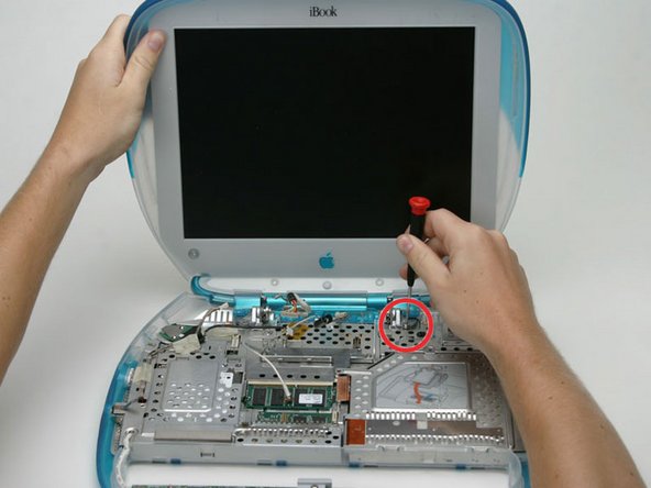

Image 1/1: Remove the display assembly.
  • Finally, support the display with one hand while unscrewing the last Phillips screw from the right hinge (push the display gently down to avoid putting pressure on the screw).
  • Remove the display assembly.

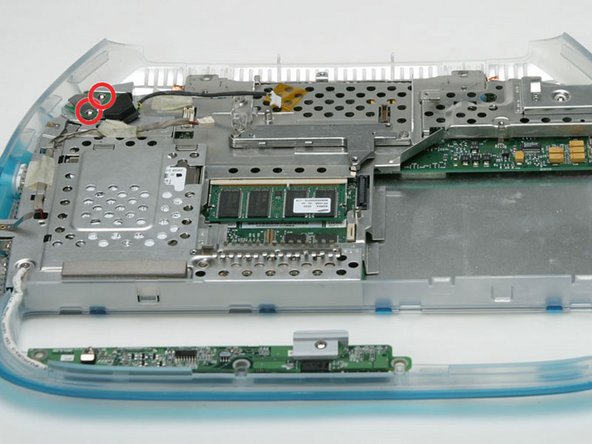

  • Remove the two small Phillips screws from the RJ-11 board.
Image 1/1:
  • Push out the lower case rim and pull the RJ-11 board out of the computer.

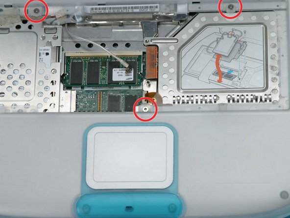

Image 1/1: Two short, flat-headed Phillips screws near the battery compartment.
  • There are six screws to remove (if you have an iBook without Firewire the screw circled in orange will not be present):
    • Two short, flat-headed Phillips screws near the battery compartment.
    • One short, round-headed Phillips near the speaker cable connector. (This is present on some models, but not others - especially the older ones)
    • One short, flat-headed Phillips between the ethernet and USB ports.
    • One short, flat-headed Phillips to the left of the hole-y (polite laughter) area.
    • One long, round-headed Phillips screw near the power receptacle.

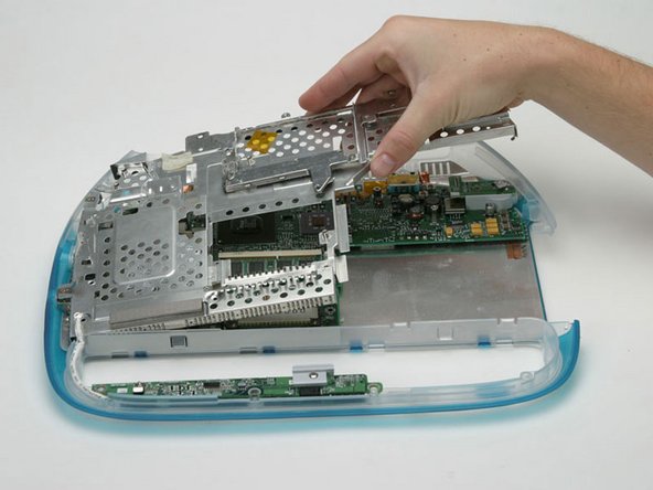

Image 1/1:
  • Lift the right side of the EMI shield up and pull it out of the computer.
Image 1/1:

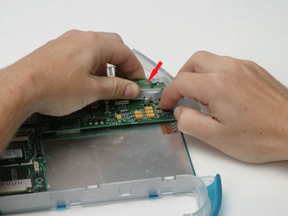

  • Push down firmly on the logic board and pull the DC-In board up from its connectors and then to the left.
