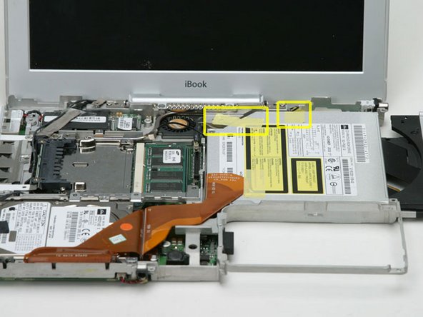

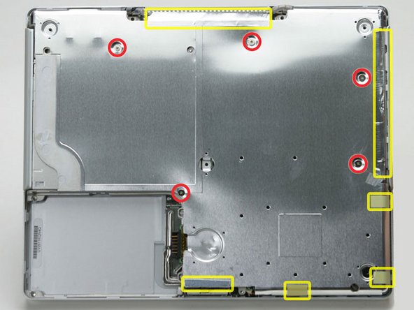

Image 1/1: Peel back the yellow tape and foil shielding outlined in the image.
  • Remove the five 5.8 mm Phillips screws from the bottom shield.
  • Peel back the yellow tape and foil shielding outlined in the image.
Upper left screw is 4.5 mm and has smaller head. The other four are 6 mm.
commenter - Reply
Don't peel back the long foil shielding pictured top right! It should stay attached to the bottom shield that you are removing.
neato - Reply
Quote from commenter:
All of the five screws are the same 6 mm in length (iBook G3 600 MHz)
florguh - Reply

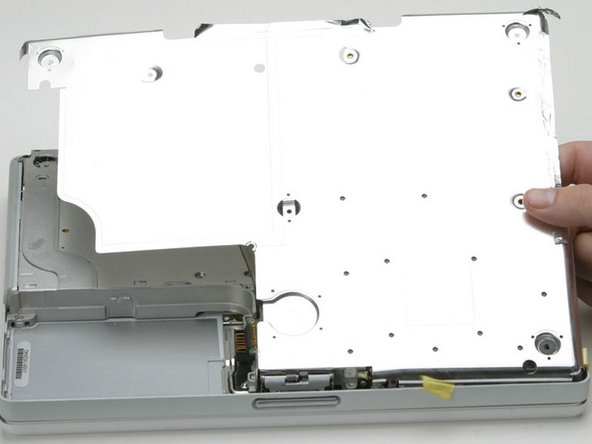

Image 1/1:
  • Lift the bottom shield off.

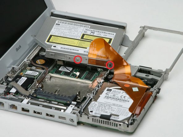

Image 1/1:
  • Use a straightened paperclip to open the optical drive tray.
Image 1/1:
  • Pull the optical drive out just enough so that you can access and remove a Phillips screw near the battery compartment.
this is the most difficult part in the whole repair
karel b - Reply
i think that we can leave that one out on re-assembly
Chris Green - Reply
It's quite hard to get to the screw and loosen it.
florguh - Reply
If you fully extend the tray it's fairly easy to get to the screw by going inside the rails. And grab it with tweezers.
Ty Leavitt - Reply
When re-installing use something sticky on your screwdriver to hold the screw in place, or it's never going in. The sleep magnet is nasty at grabbing your screw and pulling it away. (Doesn't hurt to have something sticky on it for taking it out too...)
Christian Wacker - Reply
There is no way to go in STRAIGHT without risking to damage the tray! The screw head is just too far off to the left and is covered by the tray. So I opened completely the tray and I could barely remove it from inside the try guide.
taf - Reply

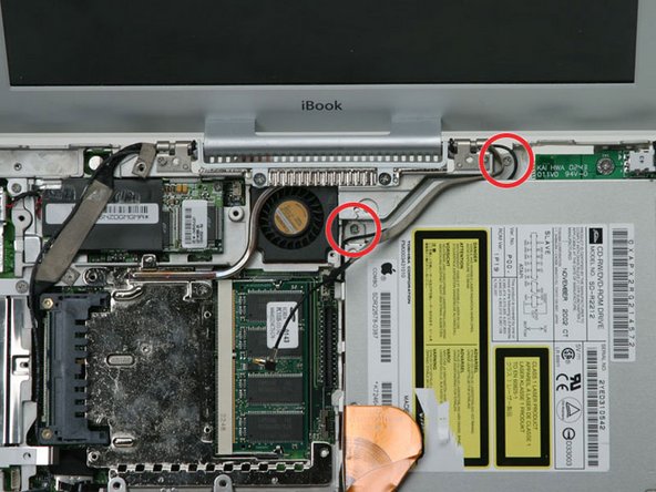

Image 1/1:
  • Pull the optical drive a bit more so that you can access and remove a second Phillips screw near the power receptacle.
This one is tiniest (shortist) so far
Rufleyboy - Reply
Be sure when installing a slot drive to replace these screws before installing the drive!!
steve - Reply

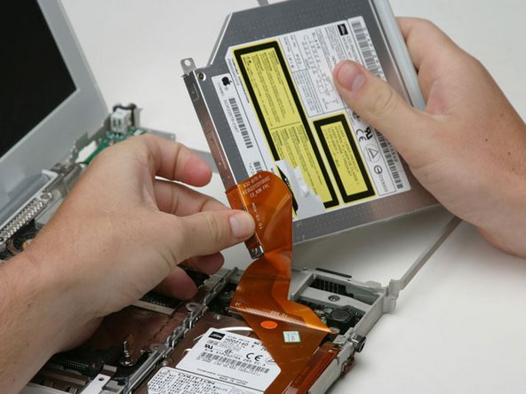

Image 1/1: Lift the upper case from the left side and use your other hand to pull out the right side in order to clear the power receptacle.
  • Before you can jerk the upper case off with joy, you must disconnect both the blue and white power cable and red and black speaker cable as described in the next steps.
  • Lift the upper case from the left side and use your other hand to pull out the right side in order to clear the power receptacle.
  • There may be a thin metal bar fastened to the upper case by the two screws on either side of the optical drive. This bar provides rigidity around the optical drive; don't forget it when reassembling.
Image 1/1: Lift the upper case enough to disconnect the blue and white power cable from the logic board. Using your fingernails or a dental pick, carefully pry the connector from its socket. Make sure you're pulling only on the connector and not on the socket.
  • The connectors at the ends of the cables are attached very firmly to the sockets on the logic board. Pulling directly on the cable will either separate the cable from its connector or the socket from the logic board.
  • Lift the upper case enough to disconnect the blue and white power cable from the logic board. Using your fingernails or a dental pick, carefully pry the connector from its socket. Make sure you're pulling only on the connector and not on the socket.
blue up and white down
edosso - Reply
Not unless you have to! Most parts can be removed with this left in. Don't try pulling on it unless you have to, it can easily break the logic board. Just tilt the upper case up to lean it on the display.
QEII Student IT - Reply
Much easier if you do this after Step 37.
Benn Snyder - Reply
when putting back the connectors I bent the bloody pins, do it when you are relaxed............
bgfra - Reply
Quote from bgfra:
Can easily repair them using a watch repair magnifier (3 euros)
bgfra - Reply
It is alot easier to get at after you pull the speaker cable out. Use something small to pop it out of place though, I broke my extra spare being a little too hasty.
This connector has a small catch on the right. slipping a sharp object (eg: pin) between the connector and it holder will release the catch. The connector should now come off easily.
Lawrence Lau - Reply

Image 1/1: Peel back one strip of foil tape in the upper left corner and another near where the trackpad connects to the logic board.
  • Peel back three strips of yellow tape in the bottom left corner.
  • Peel back one strip of foil tape in the upper left corner and another near where the trackpad connects to the logic board.
The foil tape next to the trackpad connector is not marked in the pic

  • Lift the top shield up from the right side, minding the upper left corner, which may catch on the metal framework.

Image 1/1: Open the optical drive using a straightened paperclip (if it's not already opened).
  • Flip the computer over and open the display.
  • Open the optical drive using a straightened paperclip (if it's not already opened).
  • Peel up the yellow tape from the optical drive.
Image 1/1: Remove the two Phillips screws securing the optical drive to the metal framework.
  • This step may vary on some iBook models. If the screws shown are not on your iBook, you may need to flip the computer over and remove two screws attaching the bottom of the optical drive to the metal framework.
  • Remove the two Phillips screws securing the optical drive to the metal framework.
Image 1/1:
  • Peel back the orange ribbon cable to reveal a single Phillips screw. Remove this screw to free the optical drive from the metal framework.
In my iBook, there was no need to remove the screw under the ribbon cable. It's just a part of the optical drive.

Image 1/1:
  • Lift the optical drive by the edge closest to the screen, minding that the metal bracket at the top left corner doesn't catch on the Airport or inverter cables.
