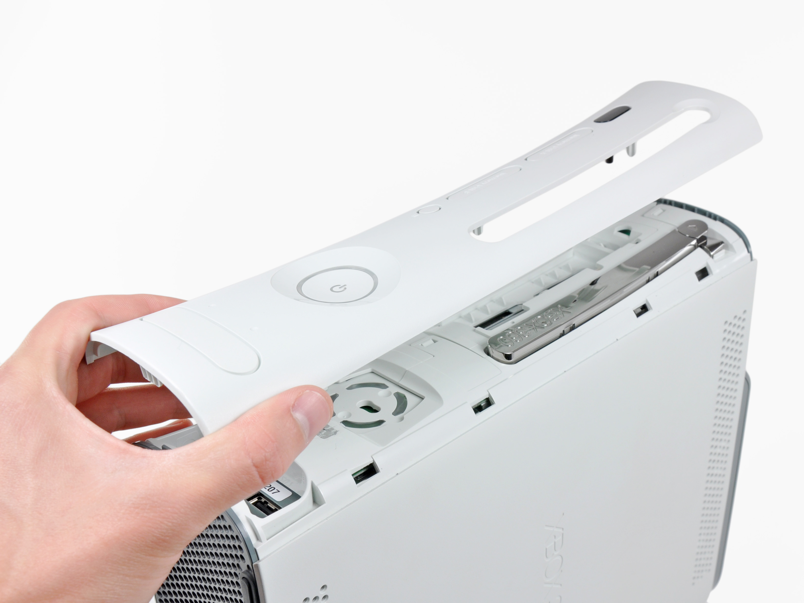

    • Orient the console horizontally with the I/O ports side down.
    • Insert the edge of a spudger between the faceplate and the outer casing near the power button.
    • Run your spudger along the edge of the faceplate to release the clips securing it to the front of the Xbox.
    • Remove the faceplate from the front face of the console.
