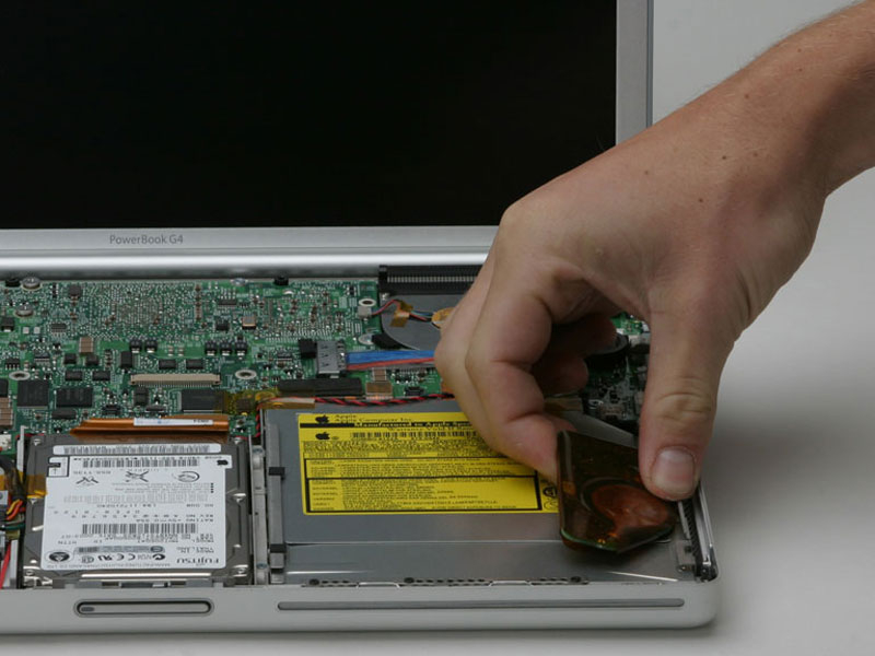

Image 1/1:
  • Use a spudger to pry up the PRAM battery from the optical drive.
Image 1/1:
  • Disconnect the PRAM battery cable from the logic board and pull the PRAM battery out.
If you are going to solder in a new battery, you will have to carefully cut the protective tape with an Xacto blade. It's sticky, so you can just fold it around the PRAM card after you install the new battery.
wcwirla - Reply
