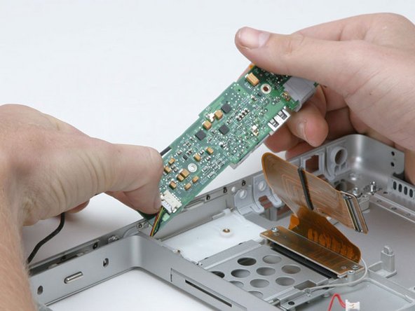

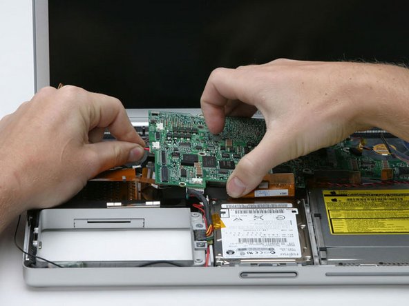

Introduction
This unit provides power to the machine, allows the battery to charge, and provides sound capability.

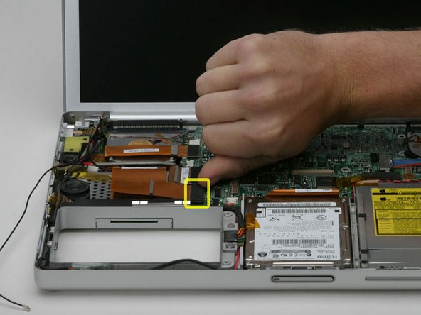

Image 1/1: Disconnect the trackpad ribbon from the logic board.
  • Remove the orange tape securing the trackpad ribbon to the logic board.
  • Disconnect the trackpad ribbon from the logic board.
If you are just replacing a hard drive, you do not need to remove either the trackpad or the keyboard cables! They will not be in the way at all. Save yourself a headache.
dougcabot - Reply
I agree - removing the cables is not necessary. I didn't even have a keyboard cable on my machine.
macbaen - Reply
i agree, too:
steps 12 to 14 are NOT necessary for replacing the harddrive!
neither are 17 and 18!
instead:
after 10 continue with step 15.
instead of 17 and 18: free the hd carefully
from the case disconnect the hard drive cable from the hard drive.
valid - Reply

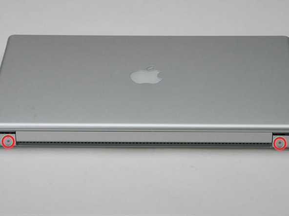

Image 1/1: Close the display and turn the hinge side of the computer to face you.
  • If you have already removed the hard drive or optical drive, your computer may differ slightly from the images in this section. These parts do not affect this procedure.
  • Close the display and turn the hinge side of the computer to face you.
  • Remove the remaining Phillips screw on either side of the hinge (two screws total).

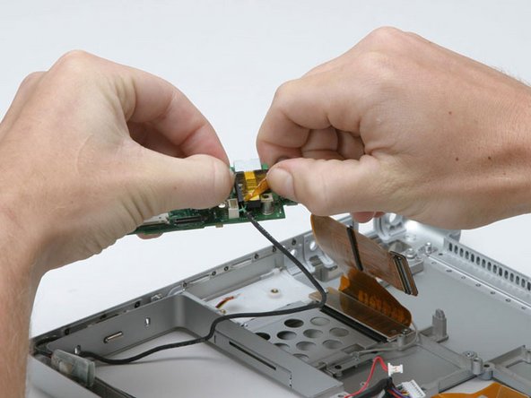

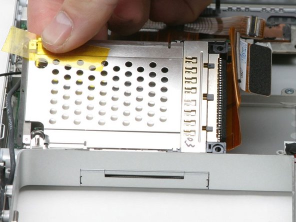

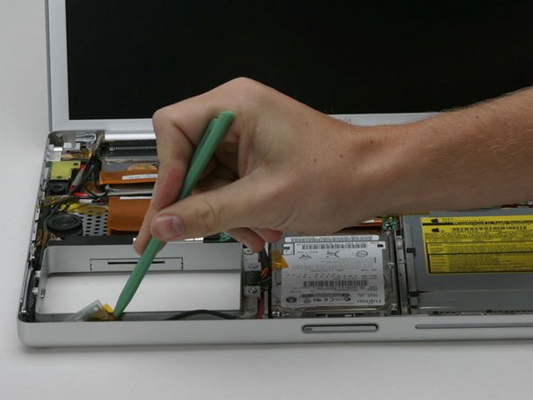

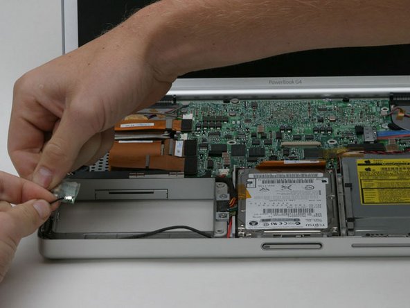

Image 1/1: Use a spudger to pry the bluetooth board from the gap between the battery housing and front of the lower case.
  • Open the computer with the display facing you.
  • Use a spudger to pry the bluetooth board from the gap between the battery housing and front of the lower case.

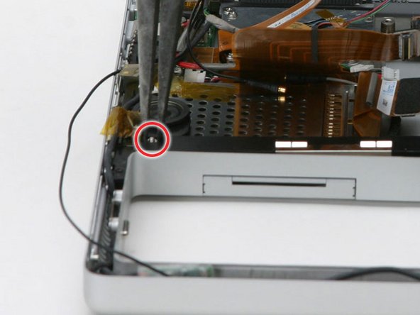

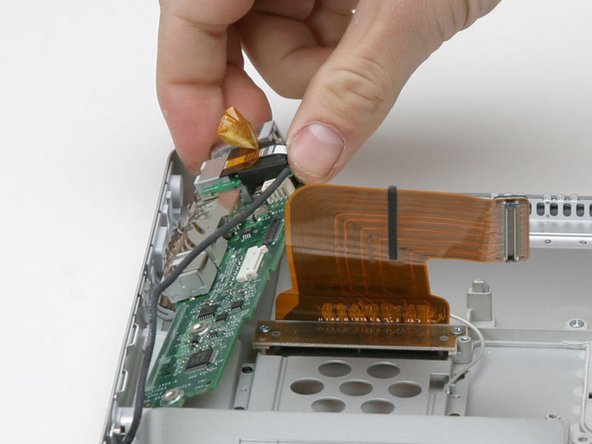

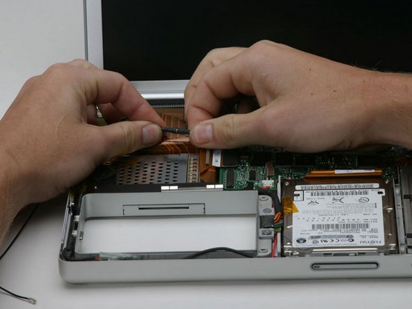

Image 1/1: Deroute the bluetooth antenna cable along the left edge of the computer, removing tape as necessary.
  • Disconnect the bluetooth antenna cable from the bluetooth board.
  • Deroute the bluetooth antenna cable along the left edge of the computer, removing tape as necessary.

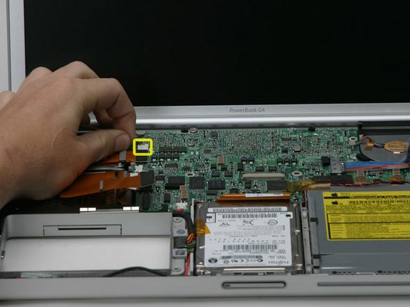

Image 1/1:

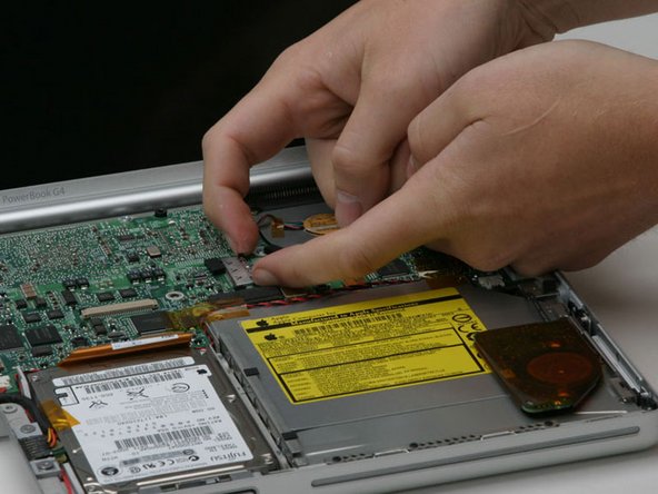

  • Disconnect the large orange Airport ribbon from the logic board.
Image 1/1: Disconnect the Airport antenna cable at the black connector, making sure you pull only on the black rubber portion of the connector.
  • Pull the Airport ribbon cable up in order to access the black Airport antenna connector.
  • Disconnect the Airport antenna cable at the black connector, making sure you pull only on the black rubber portion of the connector.

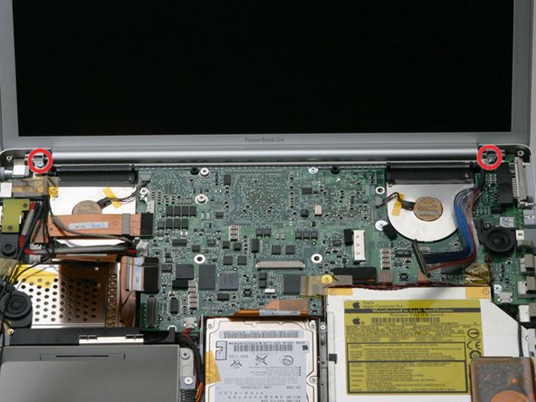

Image 1/1: Remove the T8 Torx screw closer to the display on either side of the hinge (two screws total).
  • Make sure you've freed up all four cables attached to the display assembly, and will pull away easily with the rest of the display.
  • Remove the T8 Torx screw closer to the display on either side of the hinge (two screws total).
bluetooth cable and airport cable pass under other bundle of cables between 0624 and N47822
Denis - Reply
Image 1/1: Remove the longer T8 Torx screw remaining on either hinge (two screws total).
  • Be sure to support the display with one hand while removing the final two screws.
  • Remove the longer T8 Torx screw remaining on either hinge (two screws total).

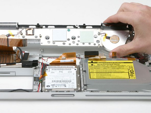

Image 1/1:
  • Lift the display off.

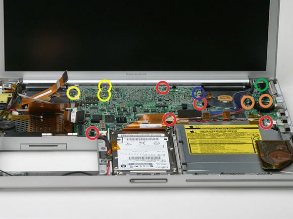

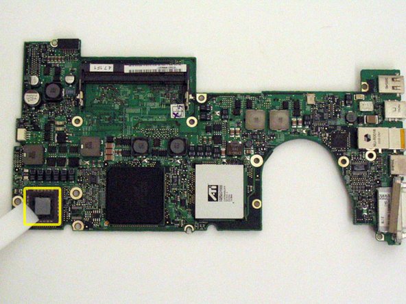

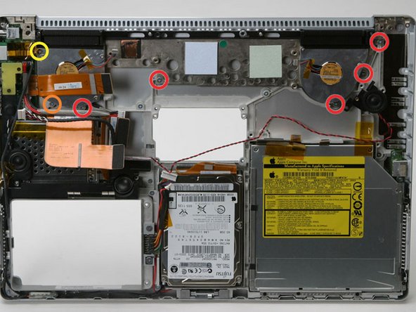

Image 1/1: Remove the following 12 Phillips screws from the logic board:
  • There should be no cables connected to the top of the logic board at this point.
  • Remove the following 12 Phillips screws from the logic board:
    • Six 4 mm around the edges of the logic board.
    • Two 5 mm securing the right speaker to the logic board (move the speaker off of the logic board).
    • Three 6 mm with wavy washers in the upper, left corner of the logic board.
    • One 4 mm underneath a black bumper in the back right corner of the logic board.
    • One 4 mm screw may not be present on some logic boards.
I only found 5 red screws
nic9 - Reply
It really helps to remove the torx that clamps down the display ribbon cable, located on the display hinge. Removing it frees the display ribbon to be moved out of the way a little when you soon pull out the logic board.
stevesontheroad - Reply
Quote from nic9:
Same here, only 5, and also no black bumper covering the 4 mm in the upper right hand corner
I have "professionals" repairing my PowerBook before and i notice missing screws!!
cbeanenyc - Reply
to get the orange screws out had to take of the small board (one small black screw), plastic support held by green screw.
Denis - Reply
Image 1/1: Use a spudger to gently (very gently) pry up the left side of the logic board.
  • Two cables still connect to the logic board and must be removed before pulling the board entirely out of the computer.
  • Use a spudger to gently (very gently) pry up the left side of the logic board.
step 17 very difficult to pry up. logic board seem to be sticked to the fan module

Mine was stuck like that too. I ended up getting a flathead screwdriver and carefully prying up on the edge of the logic board in the back and it came off with an awful sounding pop. It looks like the processor was attached to the heat sink with something that is probably thermal paste. It doesn't seem to be damaged, but I haven't been able to test it yet.
revcompgeek - Reply

You will have to gently work the area next to the fan housing... the key is to do it gently, small movements at a time. If using a flat head, (which you should probably not) make sure not to damage the PCB
eric - Reply

Image 1/1:
  • Disconnect the battery cable from the front, left corner of the logic board.
Image 1/1: Once the logic board clears the ports, slide it out to the left.
  • Grasp the logic board at the left edge with one hand and at the thinnest section with the other hand. Lift the left edge of the board up to approximately a 30 degree angle (if you don't have your protractor handy, just lift until the DVI port clears the right hinge).
  • Once the logic board clears the ports, slide it out to the left.

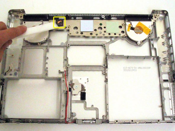

Image 1/1: Use a firm plastic edge to scrape the thermal material off the processor.
  • Important: when you reinstall a logic board, you'll need to replace the thermal paste that goes between the processor on the logic board and the heat sink. Failure to remove the old paste and apply a new layer can cause the computer to overheat and sustain damage. The following steps refer to replacing the thermal paste between the processor and heat sink; follow these steps only when you are ready to place the logic board in the computer.
  • Use a firm plastic edge to scrape the thermal material off the processor.
  • For more advanced instructions on this procedure, see our Applying Thermal Paste Guide.

Image 1/1: When replacing the logic board, make sure all cables are routed around and above - not under - it, and to connect the two cables that do go beneath before pushing the board into place.
  • Apply a new layer of thermal paste to the copper heat conduit.
  • When replacing the logic board, make sure all cables are routed around and above - not under - it, and to connect the two cables that do go beneath before pushing the board into place.
  • Place the logic board back in the computer, trying not to move it around once the processor has come into contact with the newly-applied thermal paste.

  • Remove the black Phillips screw on the bottom corner of the left speaker board.
Image 1/1:

Image 1/1: Lift the speaker board up from the computer so that you can access and disconnect the speaker cable from the sound board.
  • Do not entirely remove the speakers before disconnecting the speaker cable from the sound board.
  • Lift the speaker board up from the computer so that you can access and disconnect the speaker cable from the sound board.
  • Remove the speaker assembly entirely, including the right speaker.

Image 1/1:
  • Lift the PC card cage up from the front, and remove it from the computer.
Card cage disassembly: A black plastic piece along the side of the card cage has a tiny hole that mates with a tiny pin sticking up from an aluminum slider. Gently separate the slider pin from the underside of that hole as you lift out the card cage.

Image 1/1: Remove the following 7 Phillips screws attaching the heat sink to the metal framework:
  • If you have already removed the hard drive or speaker assembly, your computer may differ slightly from the images in this section. These parts do not affect this procedure.
  • Remove the following 7 Phillips screws attaching the heat sink to the metal framework:
    • Five 5 mm screws scattered around the heat sink.
    • One 6 mm on the front left corner of the heat sink.
    • One 10 mm in the back left corner of the left fan.
Image 1/1:
  • Remove the heat sink from the case, minding the left corner, as it tends to catch in the case (the fans will come out with the heat sink).

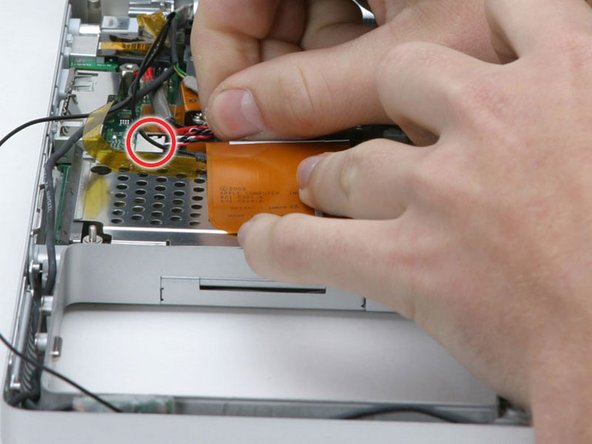

  • Disconnect the 4-pin power cable and orange ribbon from the DC/Sound card.
Image 1/1: Remove the 5 mm standoff that secures the DC/Sound card to the lower case using a nut driver or pliers.
  • Remove the T8 Torx screw from the RJ-11 board.
  • Remove the 5 mm standoff that secures the DC/Sound card to the lower case using a nut driver or pliers.
Image 1/1: Lift the DC/Sound card out of the computer and turn it over.
  • Do not pull the DC/Sound card out entirely. You will be disconnecting the Bluetooth cable in the next step.
  • Lift the DC/Sound card out of the computer and turn it over.
Image 1/1:
  • Disconnect the Bluetooth cable from the DC/Sound card, removing tape as necessary.
Image 1/1:
  • Use your thumbs to slide the RJ-11 board away from the sound card in the same direction you would disconnect a cable. This is your chance to get out some aggression, as the board will most likely be very tight and requires a good deal of force to remove. Don't get carried away though - don't hold onto the power connector and don't put too much actual force on the card itself.
