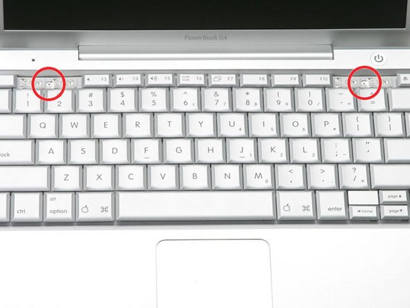

  4. PowerBook G4 Aluminum 12" 867 MHz Keyboard Replacement, Keyboard: step 4, image 1 of 1
    • On the keyboard, remove the F1, F2, F11, and F12 keys.
    • This is scary - take a deep breath before continuing. Place your index finger under the upper left corner of the key and lift up until you hear a click. Then, transfer your finger to the left edge of the key and lift up to pull the key off.
    • You're freeing the two tabs on the left of the key from the two small holes in the plastic scissors mechanism.
    • When replacing the keys in the keyboard, place the key directly over the slot where it will go and press down until you hear the key click into place.
