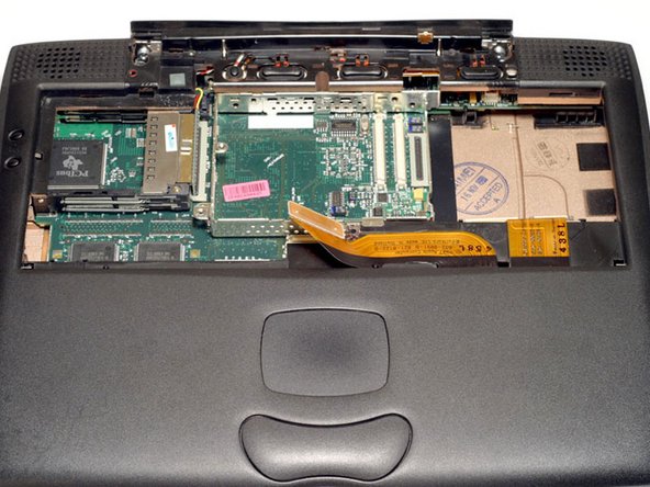

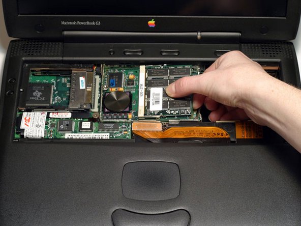

Your laptop should look approximately like this.

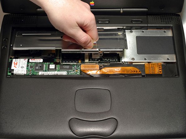

Remove the two Phillips screws from the heat shield.
Grasp the metal handle on the heat shield and pull up and toward yourself.

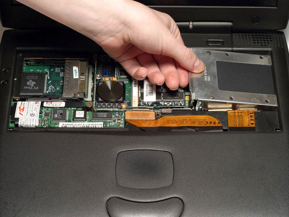

Unscrew, but do not remove, the single Phillips screw from the hard drive bracket.
Grasp the hard drive bracket on the left side and pull up and to the left.

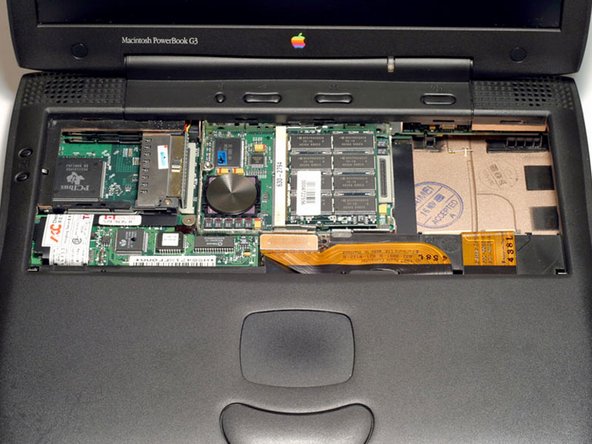

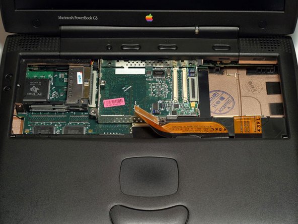

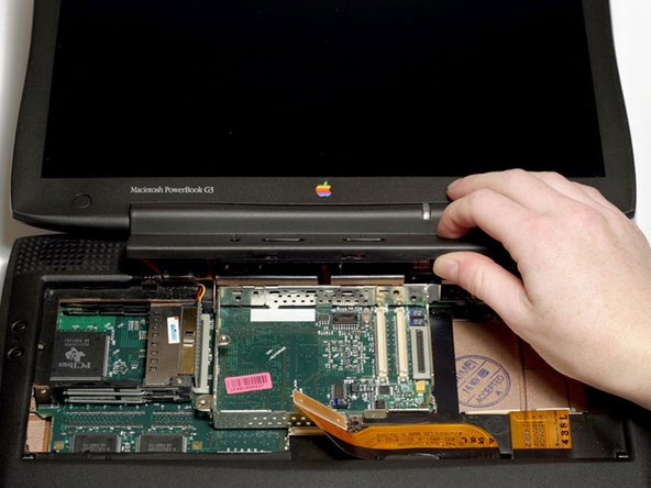

Push the display back so that it lies flat.
Slip a spudger or your index finger under the clutch cover near the power button and pull upward until you feel it come free.
Repeat the previous step on the left side.
Lift the clutch cover off by rotating it up and then toward you.

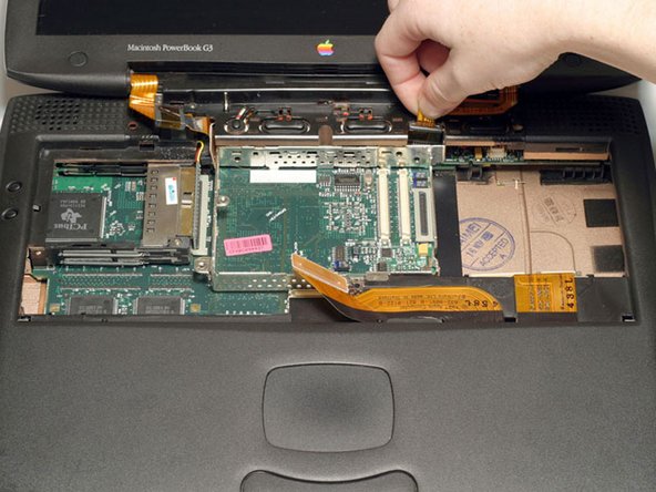

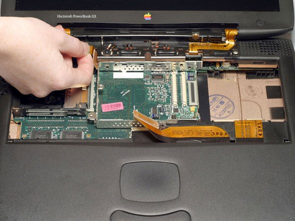

Disconnect the orange display data cable on the left side of the computer. Grasp the cable near the connector and pull directly up.
Disconnect the orange display inverter cable on the right side of the computer. Grasp the cable near the connector and pull directly up.

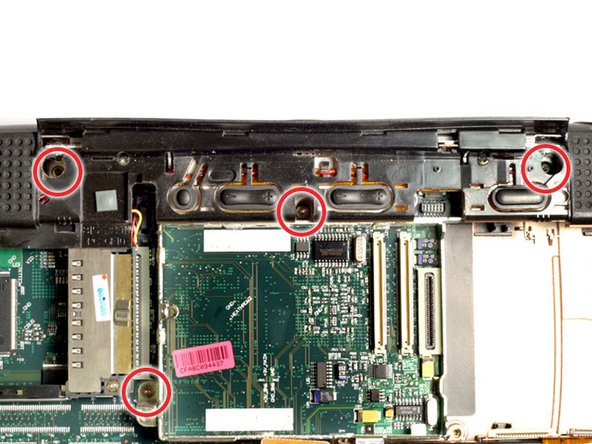

Turn the laptop around so that its back faces you.
Open the port door located at the back of the laptop.
Remove the four black T8 Torx screws.

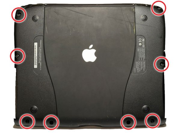

Turn the laptop over.
Remove the eight T8 Torx screws from the bottom casing.

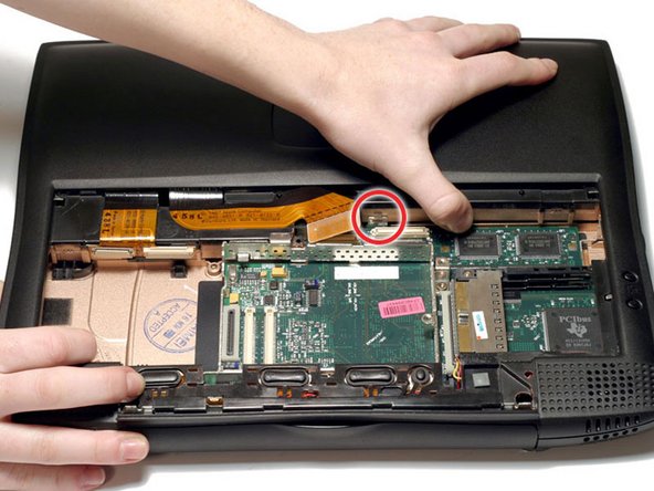

Disengage the small locking tab by pressing in on the upper case to the right of the PMU connector.
Lift the upper case up just enough so that the tab rests on its metal bracket.

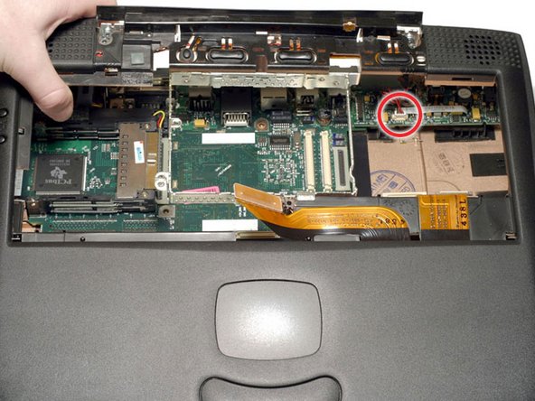

Grasp the upper case near the back left corner and lift up partly so that you can access and disconnect the audio in/out cable from the sound card in the upper right corner of the case.
Remove the upper casing. Note that there are two tabs on the laptop's front that often cause the upper case to stick.

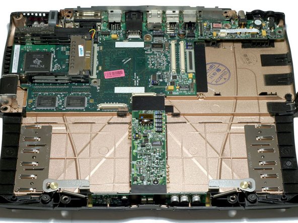

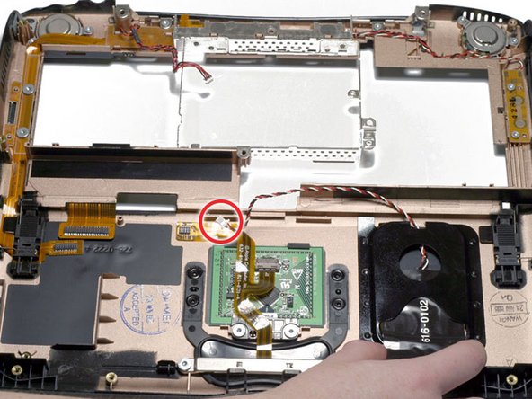

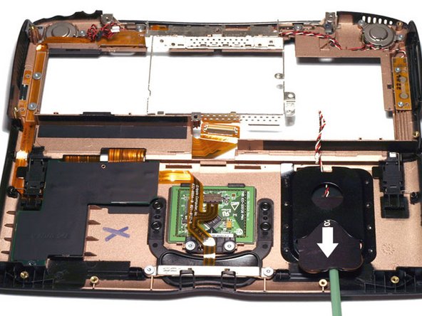

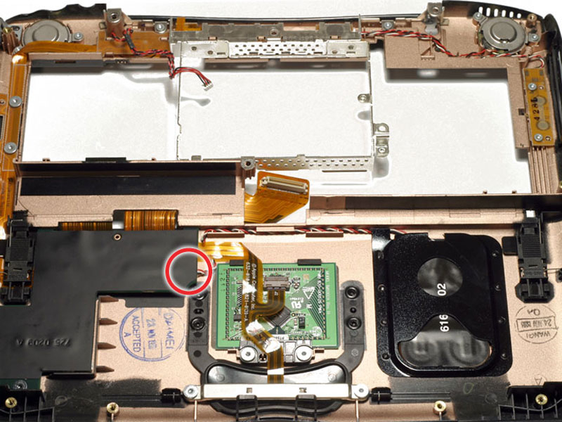

Disconnect the multicolor cable from the right side of the PMU.
Free the battery cable from the upper case.
Use a spudger or the tips of your fingers to pry up the PRAM battery and free it from its housing.
