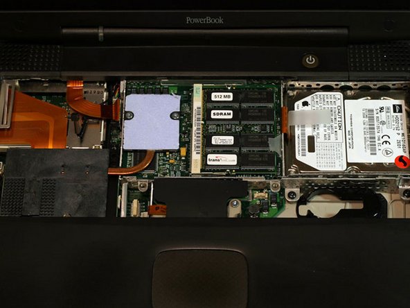

Your laptop should look approximately like this.
Remove the two silver Phillips #1 screws that attach the heat shield to the internal metal framework.
Lift the heat shield up and pull it toward you.

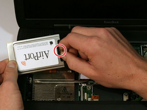

Firmly grasp the plastic tab attached to the Airport card and pull up and then to the right.
Disconnect the antenna cable from the Airport card.

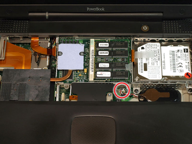

Pull the battery cable directly up from the logic board.

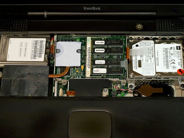

Remove the battery from its holder by pulling up and to the left.

Frankly speaking I do not have idea why do I need steps 2-7 to replace battery? Why I can't go directly to step 8 if it is possible? BTW - the battery seems to be composed from 4 standard batteries. Is anyone aware how to assembly new battery? It is not available as spare part (616-0108)
Agreed, I just successfully removed my PRAM battery skipping all those steps, just popped the keyboard out, removed the DVD drive from the right-hand out and popped that bad boy out, no problemo.
I read that you "removed the DVD drive from the right-hand out...." I'm baffled as to what you mean or how that is done. Can you explain that step?
Why do I need to remove the airport card? It's just like telling somebody to remove their shoes to take off their hat?
