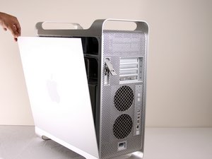

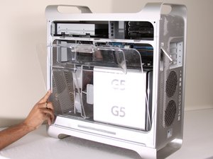

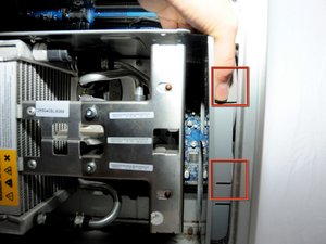

Image 1/2: The panel should fall out. If the panel does not fall out by itself pull a little from the edges.
  • Lift the tab to unlock the side panel.
  • The panel should fall out. If the panel does not fall out by itself pull a little from the edges.
Image 1/3:

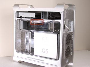

  • Remove the air deflector (the clear plastic cover) by pulling on the handle.
Image 1/1:

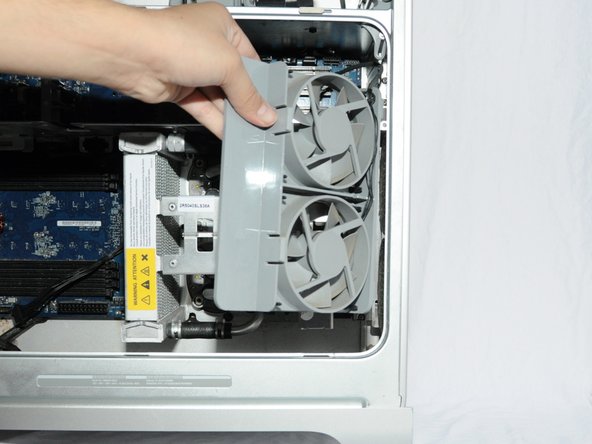

  • Locate the front fan assembly.
Image 1/1:
  • Pull the fan assembly out; it should slide out easily.

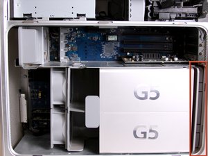

  • The cooling fan unit is located on the bottom right of the Apple G5 Desktop.

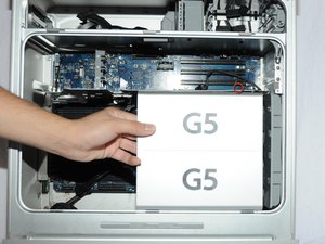

Image 1/2: Pull the metal plate to the left and outward to remove the plate from the processing/cooling unit.

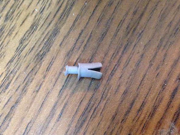

  • Remove the G5 metal cover from the processing/cooling unit of the computer. NOTE: Apple inserted a rather fragile plastic pin that inserts through the top divider shield and clips into a tab on the hidden ledge of this CPU shield. Removing this pin, certainly voided Mac's warranty - but more appropriate for now, voids most after-market insurance plans. A replacement pin (new) is hard to get ahold of, and very few are talented and patient enough to remove this pin without damaging it. Just something to keep in mind. If you have no warranty any longer or don't care, please continue...
  • Pull the metal plate to the left and outward to remove the plate from the processing/cooling unit.
The whole pin assembly acts like a miniature toggle bolt. The inner part of the pin assembly is actually a short stubby cylinder. When the pin is inserted into the sleeve, it presses on the sleeve and expands it slightly in the processor shield, locking it to the top divider shield.
I took a tiny drill bit and spun it into the center of the pin just enough so that I could insert a small sharp screw (I used a cup hook) into the pin. All it needed was just a slight tug, and the pin came out of the outer locking sleeve. I used the same screw to remove the outer sleeve.

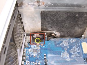

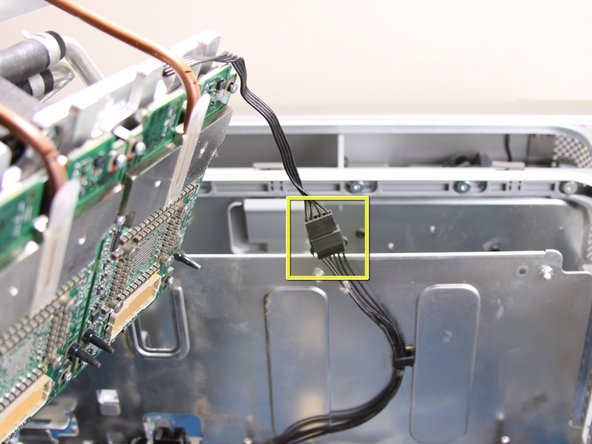

  • Unplug the fan's power cable from the upper rightmost corner of the motherboard (connection J45). If there is a video card in place, carefully pull the cable plug down between the back edge of the video card and the motherboard. Note, the photo shows the unplugged cable and the area it plugs into outlined in yellow. No video card is shown in this photo.
To disconnect the cable, it's easier to remove all the cards. I had filled up all 4 slots and I need to space to get my hand in there to disconnect the cable.
Lawrence - Reply

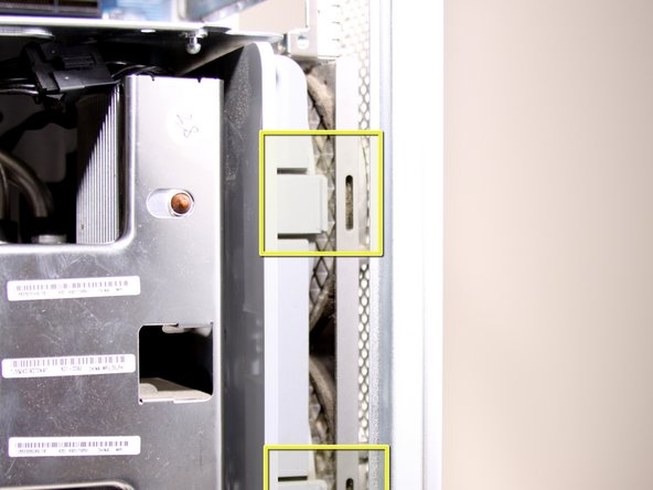

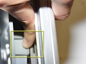

Image 1/2: While pushing in on the tabs, highlighted in yellow, pull the fan back towards the cooling unit.
  • Locate the tabs on the fan unit.
  • While pushing in on the tabs, highlighted in yellow, pull the fan back towards the cooling unit.
Image 1/2:
  • After the latches are out, pull the fan out.
Before pulling fan, you must unplug fan power cable from upper right-most corner of mother board (connection J45). Carefully pull cable down past the video card's back-side.
Sam Taylor - Reply
Thank you for this mention. It seems important, do you have a snapshot of it?
Is it hard to find/reach?
And plugging it back in with the new one, any problems?
Thanks!
Diana -

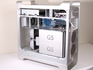

Image 1/1: Put the CPU case on its back with the opening facing up to make the next steps easier.
  • Locate the Cooling Unit on the Apple G5.
  • Put the CPU case on its back with the opening facing up to make the next steps easier.

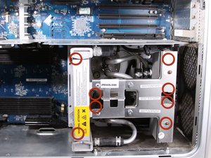

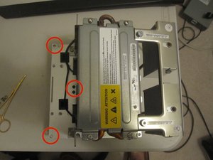

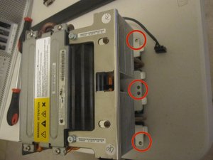

Image 1/3: The screws are somewhat hidden, so they cannot be see in the picture.
  • Unscrew 8 T10 screws from the cooling unit. NOTE: these screws are acctually allen keys. The prefered tool will be long handled allen keys. t10 are 2.74mm (closest allen key is 2.5 or 3mm) and t15 are 3.27mm(closest allen key is 3mm and 4mm). You may strip your tool or the actual screws themselves. Use a set of high quality long handled allen keys.
  • The screws are somewhat hidden, so they cannot be see in the picture.
  • To visualize the location of the screws look 3 steps ahead.
  • The screws will loosen but will not come out, they are designed to loosen the unit, but remain in place.
  • The last two images show another version of the LCS (out of the computer) in the G5 with off-center views to show the 8 screw holes.
that looks completely different and I can't unscrew it :/
grze - Reply
Did you find a solution for yours? I may have the same problem.
jaesonk -
Very difficult on some models.
Nate Aguilar - Reply

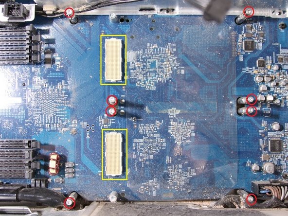

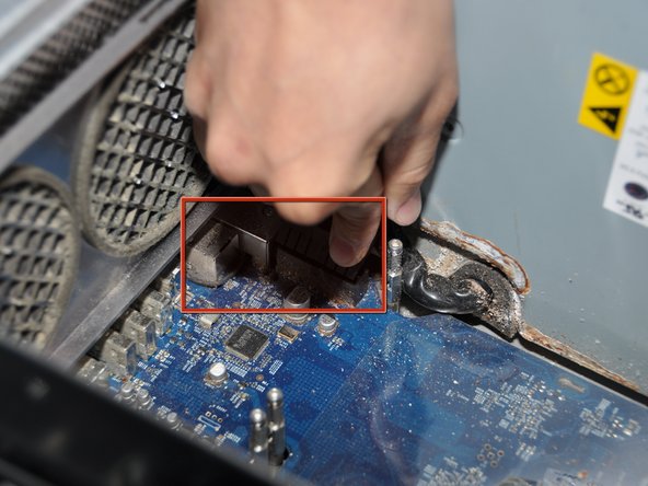

Image 1/1: Check the pin connections for any damage. All the pins highlighted in yellow should appear straight up and not appear bent. DON'T TOUCH THE PINS. A bent pin will result in your computer not powering on.
  • NOTE: Here are the standoffs without the cooling unit installed to make it easier to understand where the screws are located. Remove the bottom 2 standoffs so it is easier to remove the power supply.
  • Check the pin connections for any damage. All the pins highlighted in yellow should appear straight up and not appear bent. DON'T TOUCH THE PINS. A bent pin will result in your computer not powering on.

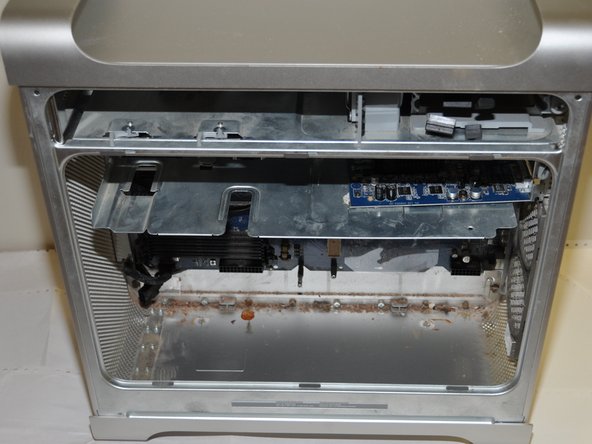

  • Locate the power supply in the Apple G5 computer. It is located under the metal plate at the bottom of the computer case.

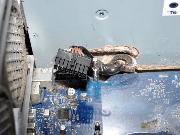

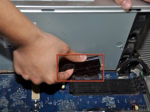

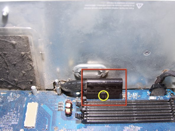

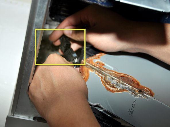

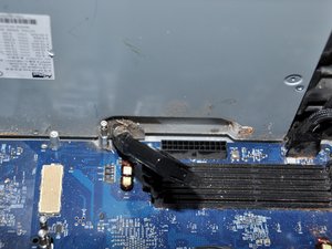

Image 1/3: Unplug the black rectangular plug with a rounded top by pulling outwards.
  • Undo the clip shown by pulling up on the edge closest to the RAM slots.
  • Unplug the black rectangular plug with a rounded top by pulling outwards.

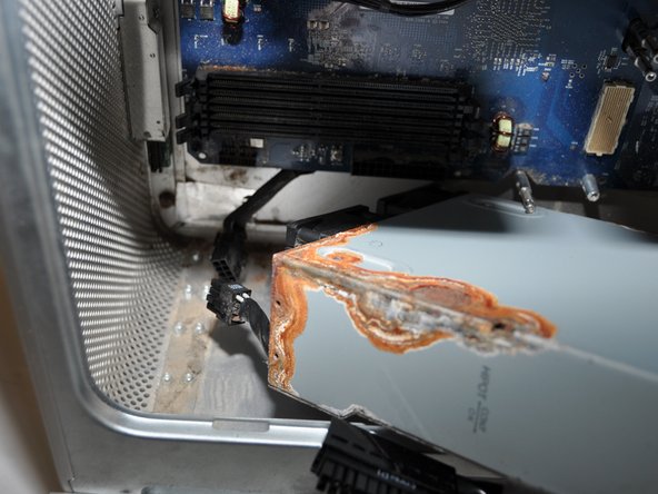

Image 1/3: Unplug the cord that is located below where the cooling unit was. To do this, pull outwards.
  • Undo the clip shown by pulling up on the edge.
  • Unplug the cord that is located below where the cooling unit was. To do this, pull outwards.

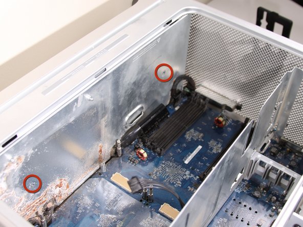

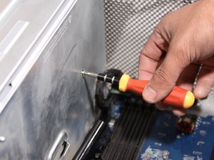

  • Remove the 2 Philips screws holding the power supply cover on.

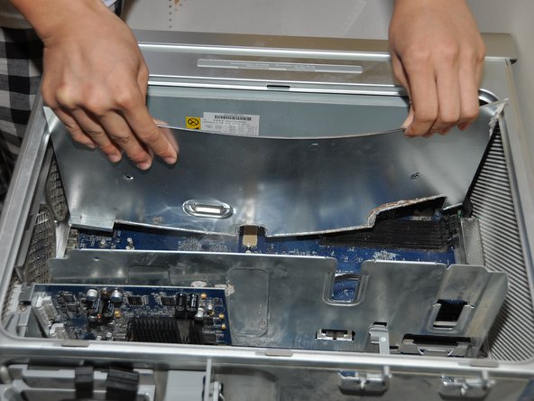

Image 1/1: This will require some bending, be sure not to bend the metal too much to prevent damage to the metal
  • Remove the power supply cover.
  • This will require some bending, be sure not to bend the metal too much to prevent damage to the metal
  • Pull the metal cover up slightly and out of the computer to prevent damage to the logic board.
You don't need to bend anything if you unscrew the lowest studs. The one with pozidrive head is an easy one, but the two round ones which hold the heat sink are quite a challenge. You need to put a nail into the hole which is perpendicular to the stud and turn everything left. You'll unscrew it and the shield comes out without any bending. Step #24 will be easier too.
Do Mel - Reply

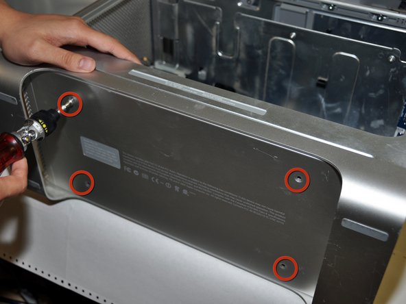

Image 1/1:
  • Remove the 4 Philips screws on the underside of the computer case.
Image 1/2: Do not completely remove the power supply since it is still attached to a cable.
  • Carefully pull the power supply out of the case.
  • Do not completely remove the power supply since it is still attached to a cable.
Having issue taking out the PSU after removing cover and screws from bottom. It's loose, but the toggle bolts for the LCS seem to be in the way. Did anyone figure a way around this?
Lawrence - Reply
ok a little more brute force and i got it out and was able to disconnect the last power cord in the front lower corner.
Lawrence - Reply

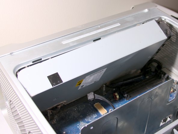

Image 1/2: Now the power supply should come out of the computer freely.
  • Unplug the final cable attached to the power supply from the computer.
  • Now the power supply should come out of the computer freely.
Image 1/1:
  • The bottom of the computer should look like this when removal of the power supply is complete.
