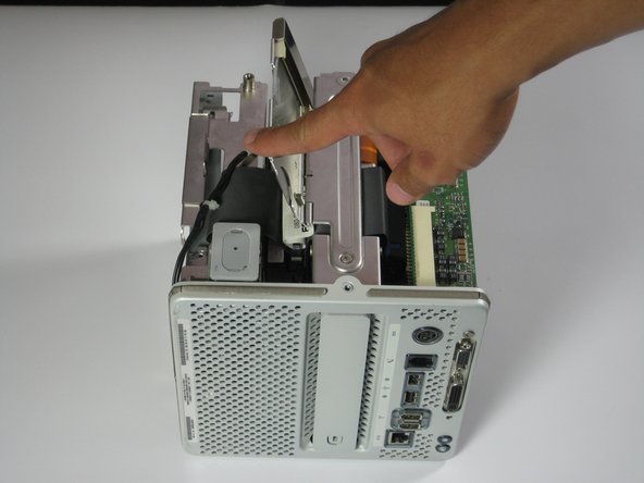

    • Grip the sides of the hard drive and slowly pull outward.
  7. Power Mac G4 Cube Hard drive Replacement: step 7, image 1 of 1

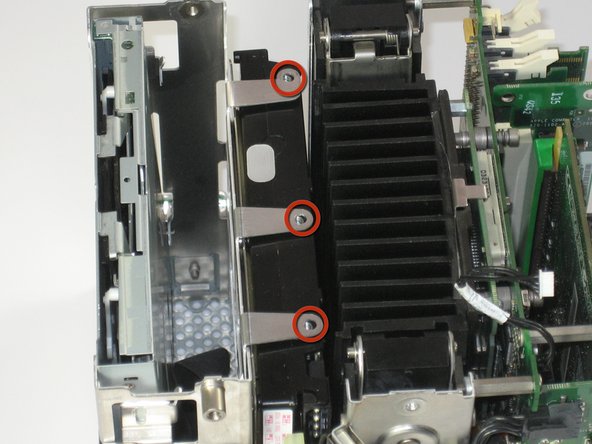

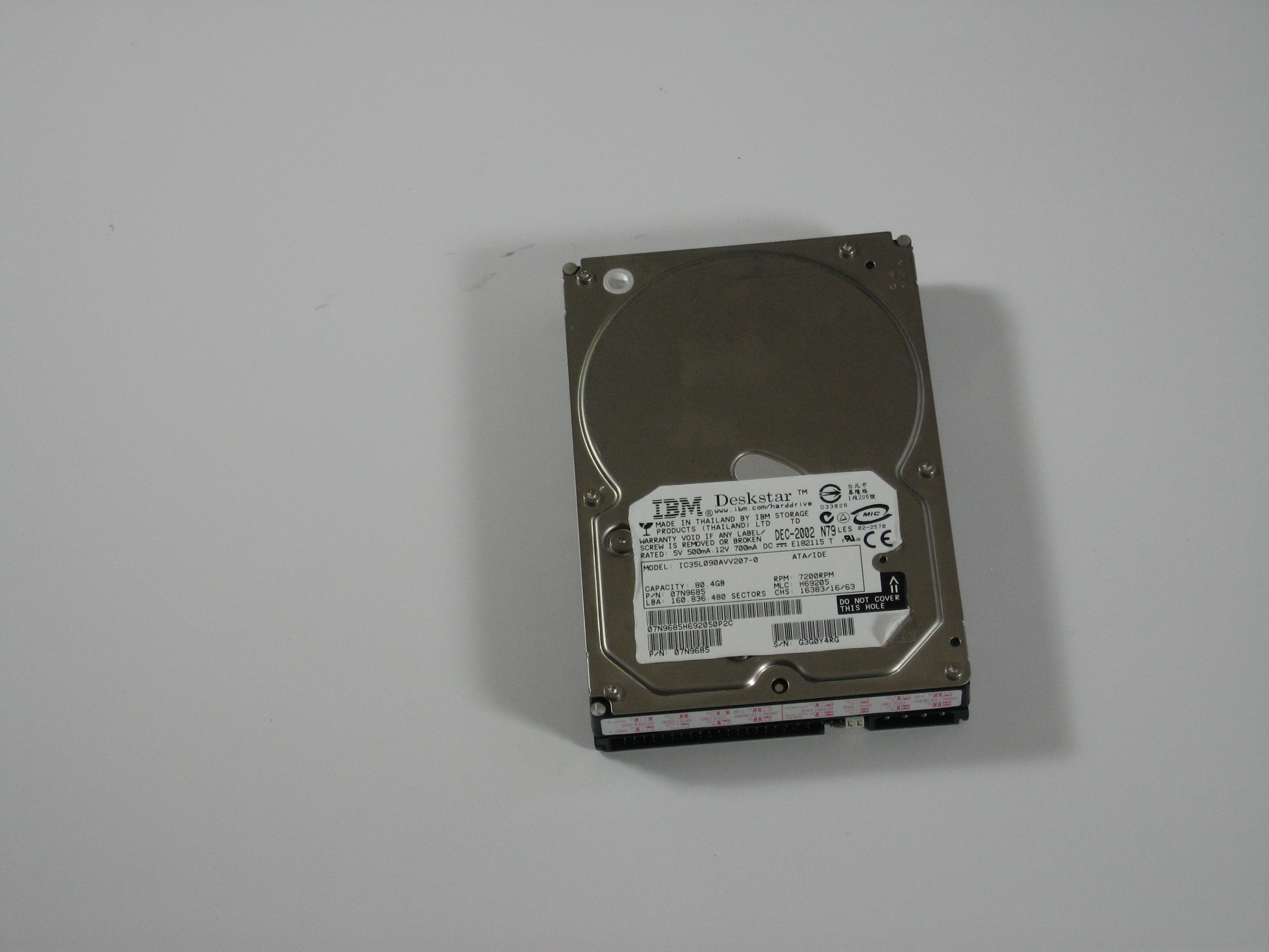

    • Remove the three top screws of the hard drive use a T8 bit and remove the heat sink.
    • Carefully slide the hard drive to the open side (side without the IDE and power cables) to remove the drive.
    • Turn the drive over, remove the sled rail with a T10 driver for its two screws. Transfer the rail to the same side on the new drive.
    • Insert new hard drive.

Strictly speaking, steps 2 through 4 aren’t necessary: you can just unscrew the heatsink from the hard drive, as in step 7, and carefully lift it out (I found that tilting it toward the optical drive and then pivoting it out worked).
