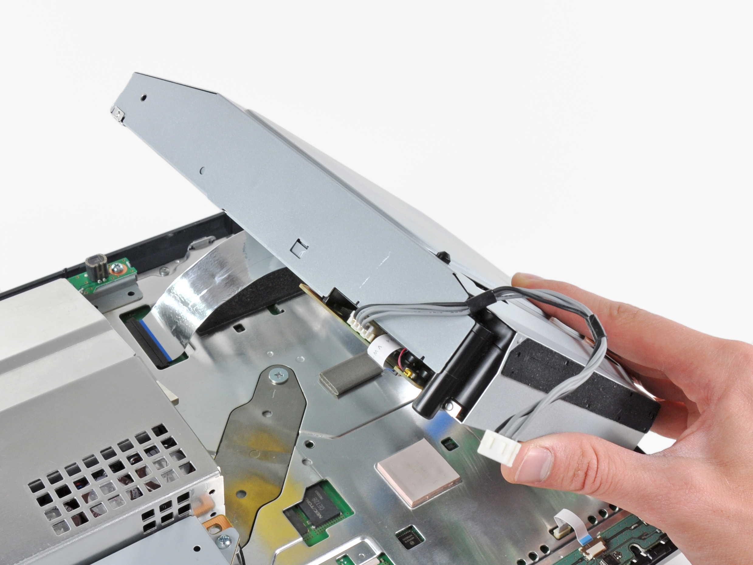

  7. PlayStation 3 Blu-ray Disc Drive Replacement, Blu-ray Disc Drive: step 7, image 1 of 1
    • Disconnect the Blu-ray power cable from the motherboard.
    • Pull the connector straight up and out of its socket.
  8. PlayStation 3 Blu-ray Disc Drive Replacement: step 8, image 1 of 1
    • Lift the Blu-ray drive from the edge nearest the power supply and rotate it away from the chassis enough to access its ribbon cable.
  9. PlayStation 3 Blu-ray Disc Drive Replacement: step 9, image 1 of 3 PlayStation 3 Blu-ray Disc Drive Replacement: step 9, image 2 of 3 PlayStation 3 Blu-ray Disc Drive Replacement: step 9, image 3 of 3
    • Use your fingernail to flip up the retaining flap on the Blu-ray ribbon cable socket.
    • Be sure you are prying up on the retaining flap, not the socket itself.
    • Pull the ribbon cable out of its socket.
    • Remove the Blu-ray drive from the PS3.
    • If replacing the Blu-ray drive, transfer the power cable to your new drive.
