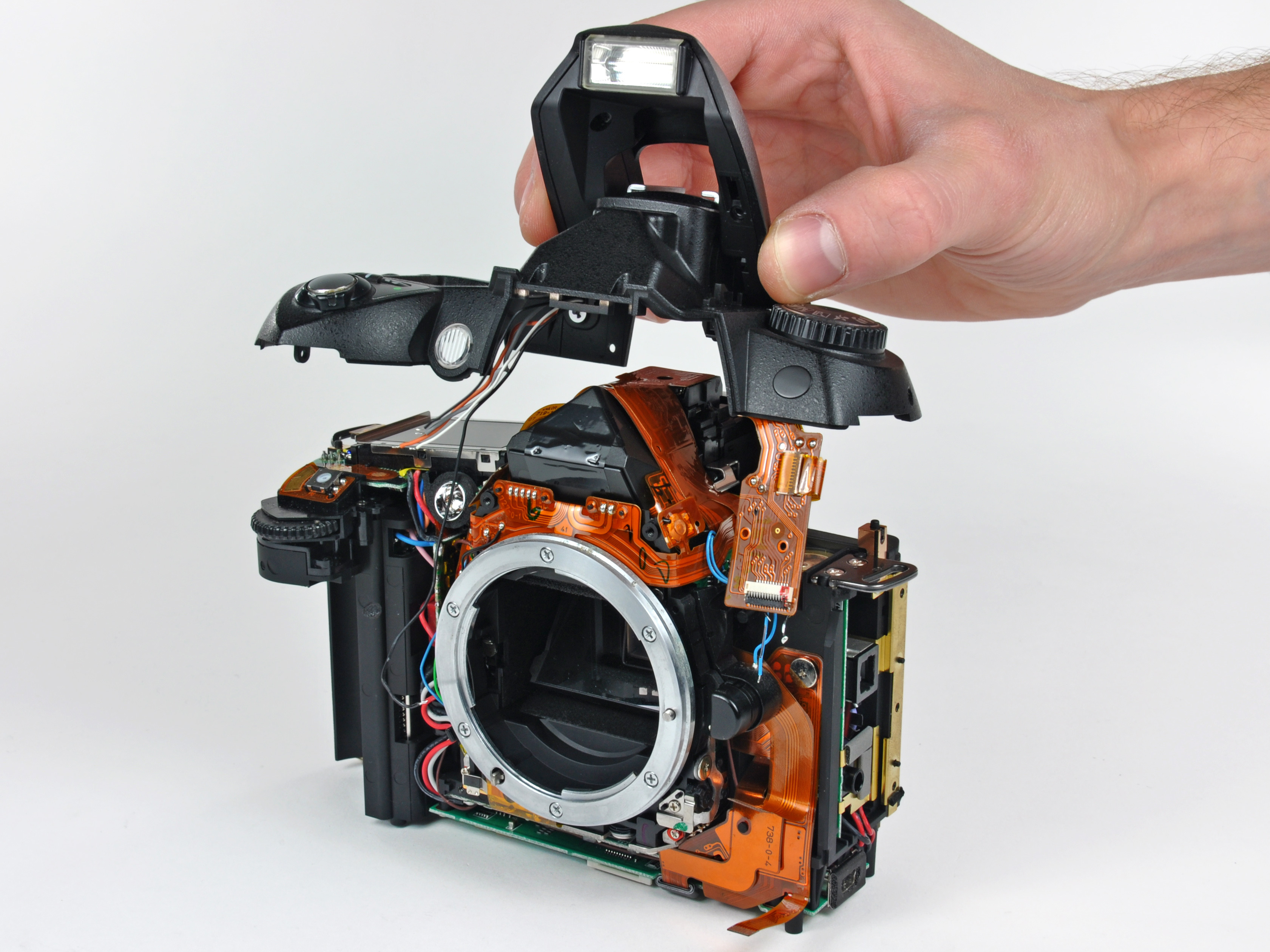

    • De-solder the thin black wire (boxed in red) from the DC/DC board.
    • Do not heat up the DC/DC board too much during the process.
  31. Nikon D70 Top Cover Replacement: step 31, image 1 of 2 Nikon D70 Top Cover Replacement: step 31, image 2 of 2
    • Carefully lift the top cover near the mode dial as you pull the mode dial ribbon cable away from the lens base.
    • Remove the top cover from the D70, minding any cables that may get caught.
