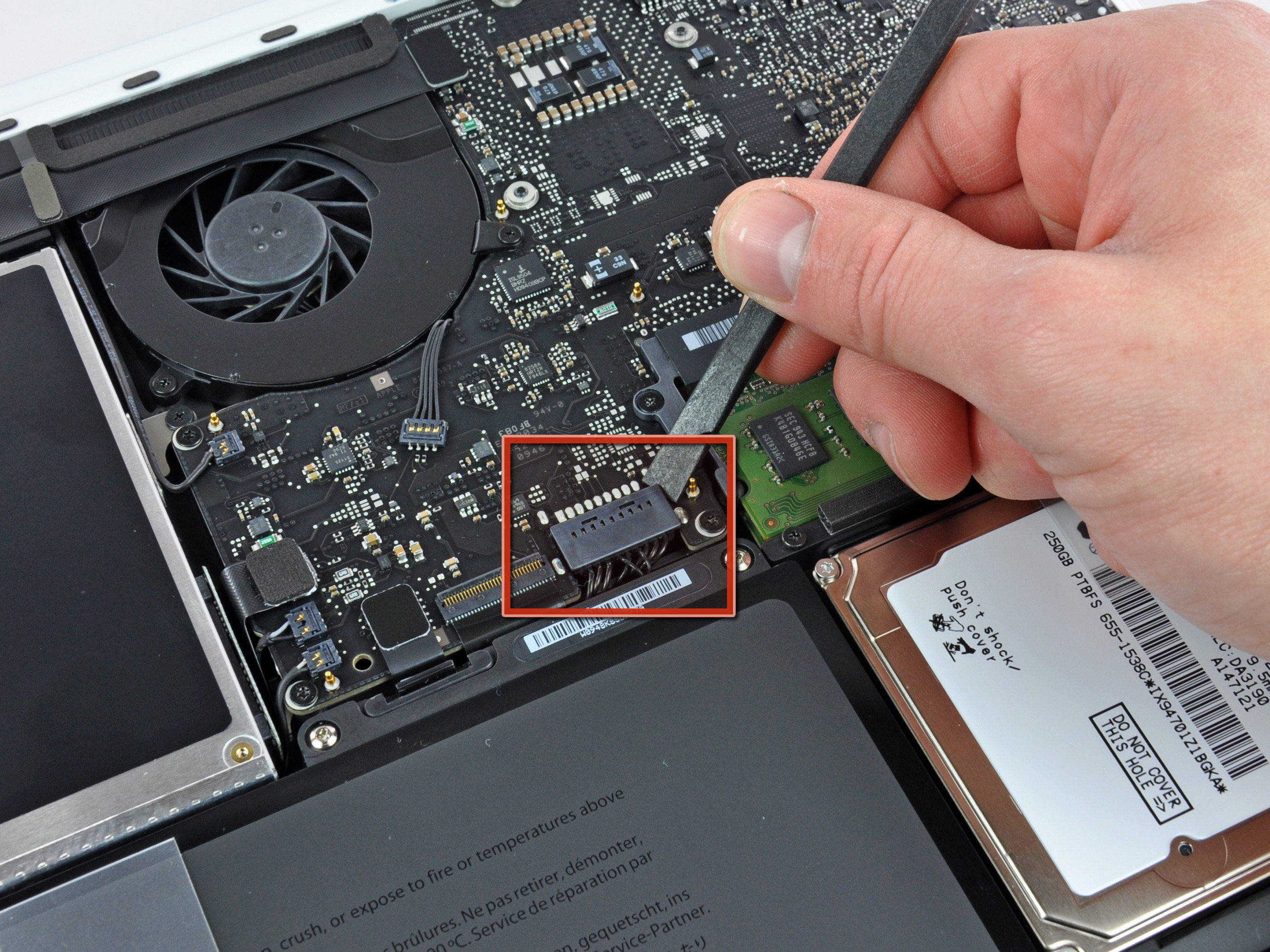

Use the flat end of a spudger to lift the battery connector up out of its socket on the logic board.

Update: I took the computer to an Apple Authorized Repair Center. They first diagnosed the problem as the incorrect battery being installed, and after further examination determined the logic board was malfunctioning. They wanted well over $350 to replace the board; I will take care of this at a later date for a lower price! Be sure to disconnect the battery cable carefully, using your fingernails or a nonconductive spudger...I believe that's where I went wrong with the disassembly.

But: Be Careful with the battery connector - you have to peel it from one side , then the other side - otherwise you´ll damage it!
nm - Reply

When I re-installed the battery, I inadvertently ripped the ribbon between the Trackad ribbon and the battery ribbon. Be Careful!
Joel Gilbert - Reply
