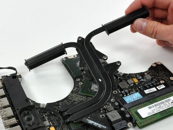

The heat sink helps keep the processor cool and happy. Be sure to replace the thermal paste before reinstalling the heat sink.

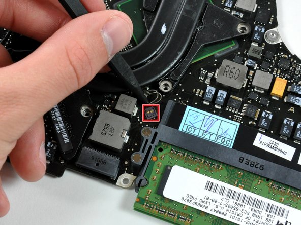

Image 1/2: Using the tip of a spudger, flip up the keyboard backlight ribbon cable retaining flap. Image 2/2: Pull the keyboard backlight ribbon cable straight out of its socket.
  • Locate the keyboard backlight ribbon cable (near the left fan space).
  • Using the tip of a spudger, flip up the keyboard backlight ribbon cable retaining flap.
  • Pull the keyboard backlight ribbon cable straight out of its socket.

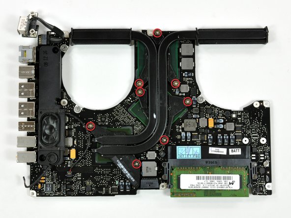

Image 1/1: Do not remove the logic board yet! There are connectors attached to the underside of the logic board that must first be disconnected.
  • Remove seven 3.2 mm Phillips screws securing the logic board to the upper case.
  • Do not remove the logic board yet! There are connectors attached to the underside of the logic board that must first be disconnected.

Image 1/1: A spring is held under each of these screws.
  • Remove eight 8.4 mm Phillips screws securing the heat sink to the logic board.
  • A spring is held under each of these screws.
Image 1/1: This connector is especially delicate, so be sure to use extreme caution when removing it.
  • Use the tip of a spudger to pry the thermal sensor connector up off the logic board.
  • This connector is especially delicate, so be sure to use extreme caution when removing it.
I broke this connector!!! Help! What can I do? Do I have to buy the whole heat sink?
The problem is that the cable broke, and the connector remained inside the socket... and now I can't pull it off.
Francesco Zhu - Reply
UPDATE: Pulled the connector out. Any change I can reconnect it to the cables?
Francesco Zhu -
Image 1/1: If you need to mount the heat sink back into the laptop, we have a [guide|744|thermal paste guide] that makes replacing the thermal compound easy.
  • Gently lift the heat sink off the logic board.
  • If you need to mount the heat sink back into the laptop, we have a thermal paste guide that makes replacing the thermal compound easy.

Wonder why there are springs on the heat sink screws? Do not over tighten them, the springs are there to help you apply the correct amount of pressure on to the CPU and GPU. If you tighten them all the way, it may not be the correct pressure! Leave maybe 1 mm of space, just before the screw stops turning. iFixit forgot to mention this important part, and also in the heat paste guide!!
m3kw - Reply
