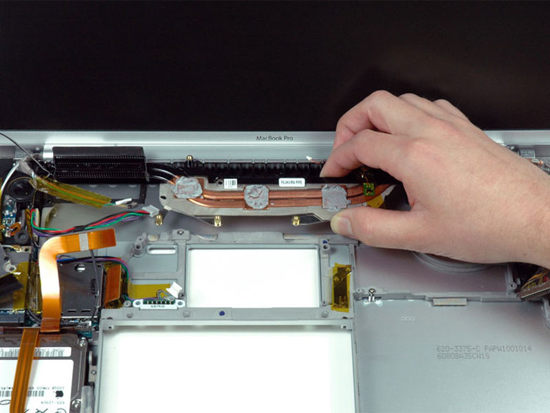

  29. MacBook Pro 15" Core Duo Model A1150 Lower Case Replacement, Lower Case: step 29, image 1 of 1
    • Lift the heat sink out of the computer.
    • If you need to mount the heat sink back into the laptop, we have a thermal paste guide that makes replacing the thermal compound easy.
