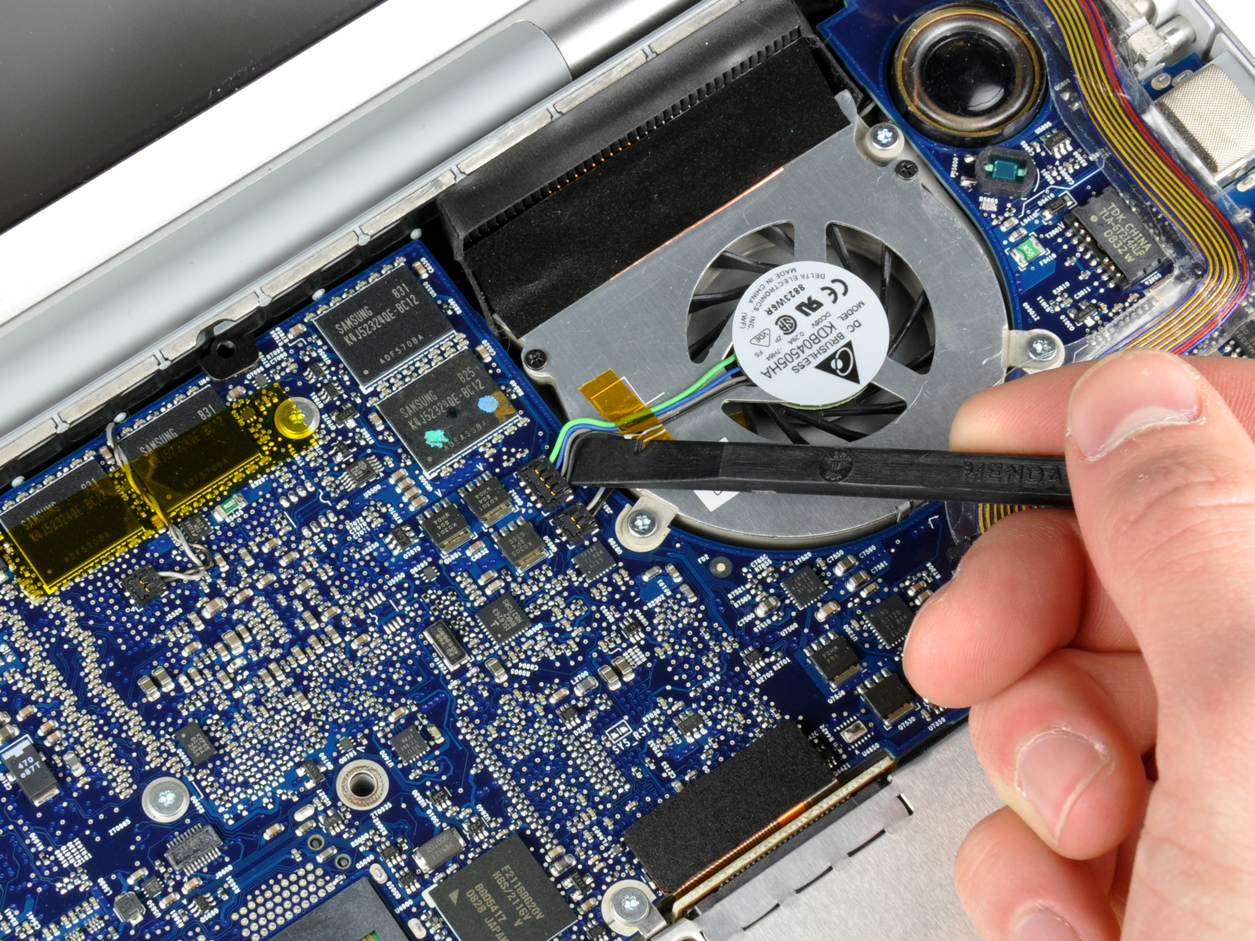

  10. MacBook Pro 15" Core 2 Duo Models A1226 and A1260 Right Fan Replacement, Right Fan: step 10, image 1 of 1
    • Disconnect the right fan cable from the logic board by placing a spudger beneath the cable and lifting up. Be sure to lift up on the right side as shown.
  11. MacBook Pro 15" Core 2 Duo Models A1226 and A1260 Right Fan Replacement: step 11, image 1 of 2 MacBook Pro 15" Core 2 Duo Models A1226 and A1260 Right Fan Replacement: step 11, image 2 of 2
    • Remove the three silver T6 Torx screws securing the right fan to the logic board and lower case.
    • Lift the right fan up and carefully peel up the tape securing the fan to the heat sink as you go.
