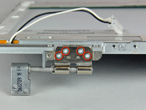

If you have a Core Duo machine, refer to picture 1 and remove three Phillips screws connecting the clutch assembly to the lower edge of the front display bezel near the display data cable.

De-route the display data cable from around the right clutch hinge and remove it from the front bezel.
Remove the four T6 Torx screws securing the right clutch hinge to the front display bezel.
