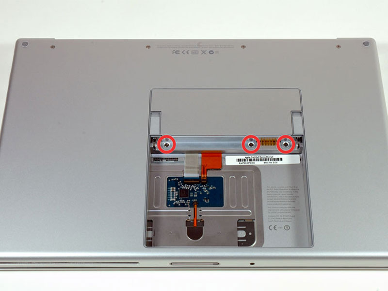

Remove the three identical Phillips screws from the memory door.
  • Remove the three identical Phillips screws from the memory door.

Lift the memory door up enough to get a grip on it, and slide it toward you, pulling it away from the casing.
  • Lift the memory door up enough to get a grip on it, and slide it toward you, pulling it away from the casing.
