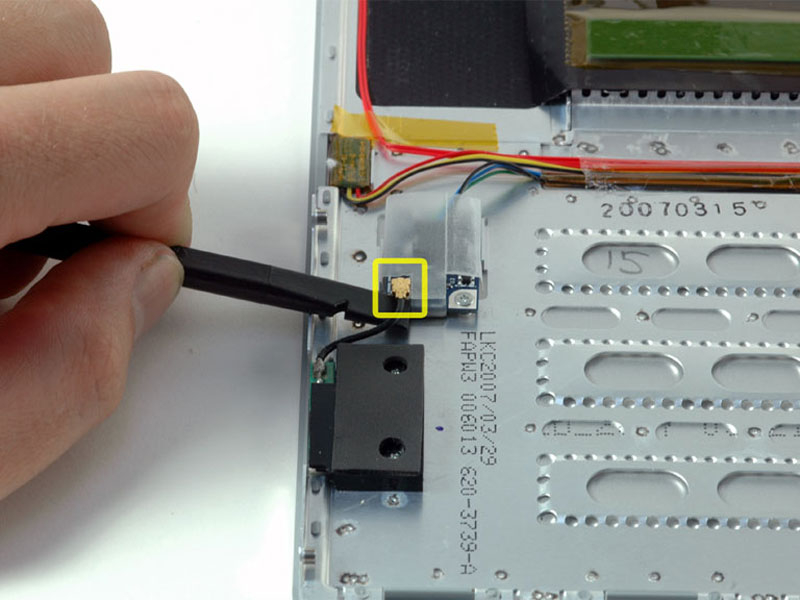

Disconnect the Bluetooth antenna cable from the Bluetooth board.
Remove the single Phillips screw securing the Bluetooth board to the lower case.
Peel up the Bluetooth data cable from the adhesive on the upper case.
Disconnect the Bluetooth data cable from the upper case.
Lift the Bluetooth board and attached cable off the upper case.
