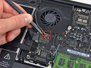

Use the flat end of a spudger to lift the battery connector up out of its socket on the logic board.
why is step 3 necessary?
Quote from gansodesoya:
Removes the possibility of any current flow. This is especially important if you are trying to mitigate the damage to the circuitry due to a spill on a keyboard.
$@$@. Don't use an non-isolated screwdriver for this. I just shorted-out my battery :(
You are absolutely right, never use a screwdriver on the logic board or any connector! Delicate use of fingernails or a credit card will get you through most situations if you lack a spudger.

I neglected step 3 and now my computer won't turn on. Could I have shorted out my logic board?
I had the same problem , my macbook doesn't switch on working

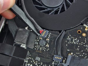

Use the flat end of a spudger to pry the subwoofer/right speaker cable connector up off its socket on the logic board.
You must first separate the little foam pad to see better how to pry the cable
connector up. You must be
careful not to root up also its socket
stuck on the logic board
My subwoofer/right speaker connection seemed to be soldered on the main board. Of course, I pried this off..realizing right after that there was no reconnecting it (&^$%^@!). There's really no reason to even disconnect this wire on the MacBook pro 13 mid-2009
Glad this is my "project" Mac
Please Be Carefully With This Step, Because I Had To Resolder It Back To The Logic Board. But There Is A Black Foam Piece Over The Cable You Have To Pry Up, Lift The Foam Piece And Then Try To CAREFULLY Pry Cable Connector
A better description would have been worth a lot....
I accidently pried off the socket aswell... gonna have to go to the computer/robotics lab at my college to resolder it -.-
CAUTION!! Note is required here! First off step is truly unnecessary! Secondly, just don't do it!

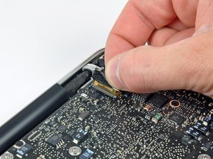

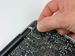

Disconnect the camera cable by pulling the male end straight away from its socket.
that's not only the camera but the wifi and bluetooth too. Be extremely careful!

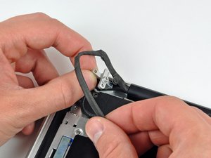

De-route the camera data cable from the channel in the optical drive.

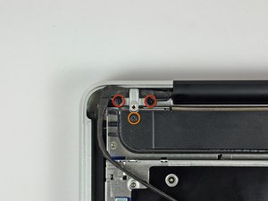

Remove the following screws securing the camera data cable and right speaker to the upper case:
Two 8 mm Phillips screws.
One 4mm Phillips screw.
Slide the camera cable bracket out from under the subwoofer and remove it from the computer.
For my mid-2010 mbp, removing the 4mm screw is not enough as the camera cable bracket is under the black cover. I need to unscrew another screw (see the dark cover in step 6). However, the speaker (dark circle in step 6) is a strong magnet and the little screw flew onto it and crack the speaker slightly. You need to be very careful of this. The sound wasn't as clear when I turn on loud volume after that.

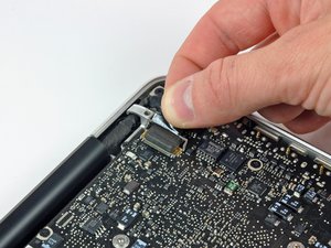

Grab the plastic pull tab secured to the display data cable lock and rotate it toward the DC-in side of the computer.
Pull the display data cable connector straight away from its socket.
Well, my display ended up looking like this after the repair:
http://i1106.photobucket.com/albums/h366...
As you can see, there was a light/dark banded pattern along the bottom of the screen, corresponding to the LCD's backlight. In my case it was also accompanied by a constant high pitched whistling noise. I swear to anything that's holy, it was not coming from the fan or the speaker, but rather the motherboard itself.
Anyway, both these problems went away when I disconnected and reconnected the connector at this stage. I'm saying this on the off chance it helps someone else.

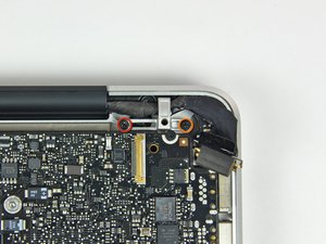

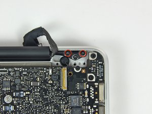

Remove the following two screws securing the display data cable bracket to the upper case:
One 7 mm Phillips screw.
One 5 mm Phillips screw.
Lift the display data cable bracket out of the upper case.

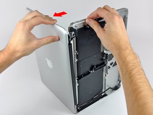

Open your MacBook so the display is perpendicular to the upper case.
Place your opened MacBook on a table as pictured.
While holding the display and upper case together with your left hand, remove the remaining 6.5 mm Torx screw from the lower display bracket.
Remove the last remaining 6 mm T6 Torx screw securing the display to the upper case.
Grab the upper case with your right hand and rotate it slightly toward the top of the display so the upper display bracket clears the edge of the upper case.
Rotate the display slightly away from the upper case.
Lift the display up and away from the upper case, minding any brackets or cables that may get caught.

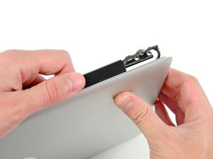

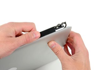

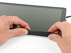

Grab the clutch cover as shown and slide it toward the right side of the display.
i've found this impossible to get back on correctly.
i cant get the plastic to slide back that 1/4" it needs to fit properly
Does anyone know any tricks? :(
This is a great guide but it's lacking one thing - where can I get a replacement clutch? I don't have a donor machine available, can I order just the plastic piece somewhere?

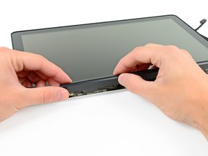

Gently rock the clutch cover back and forth on its long axis while pulling it away from the display.
Do this action along the length of the clutch cover until you can lift it off the framework attaching it to the display.
Remove the clutch cover from the display.

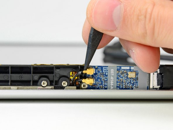

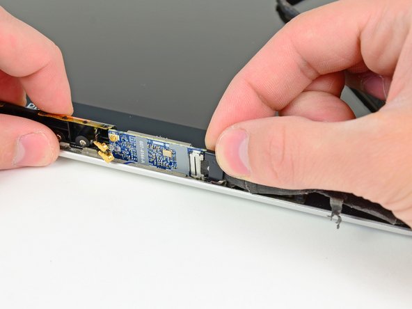

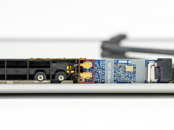

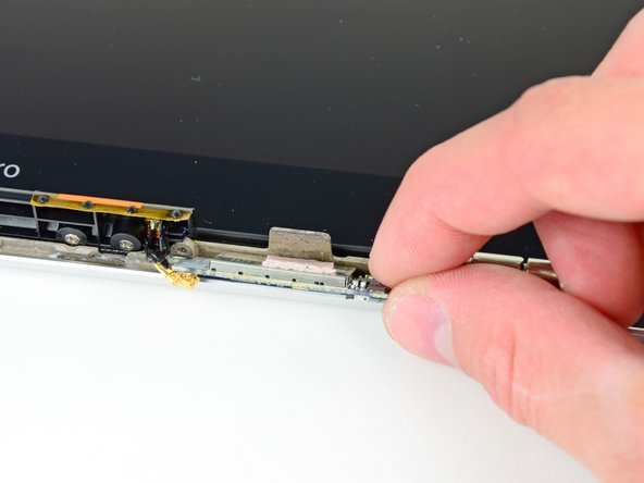

Use the tip of a spudger to pry both AirPort antenna connectors out of their sockets on the AirPort board.

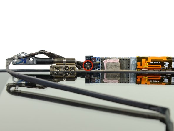

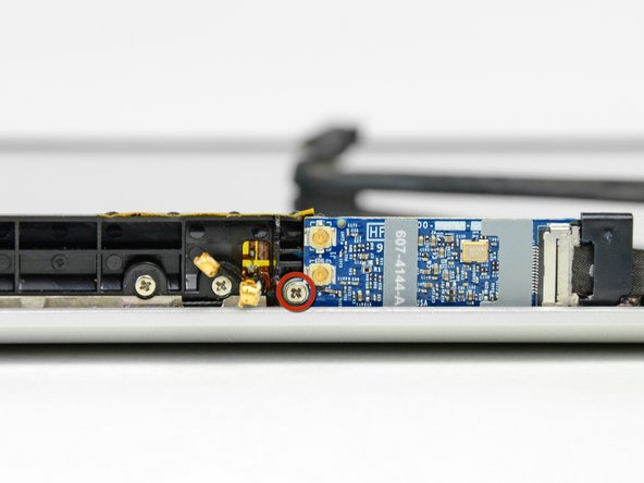

Remove the single 3 mm Phillips screw securing the AirPort card to the display nearest the AirPort antenna.

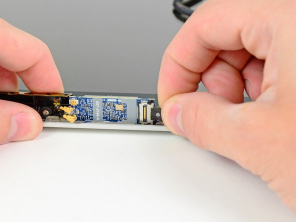

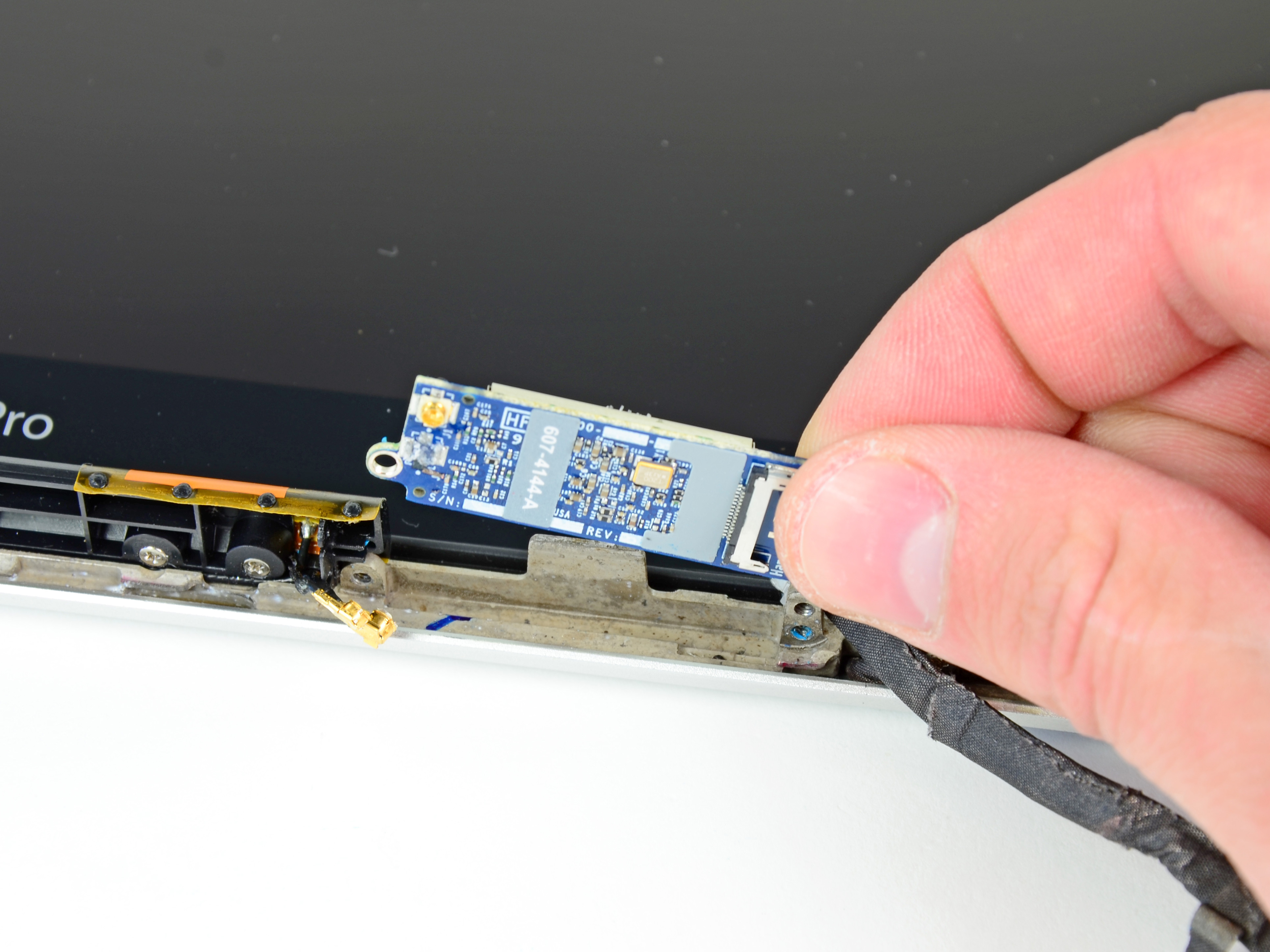

In the second picture for this step the U notches on the wifi connector are facing out when in the socket, and this is quite misleading. Putting them in like this will not work and could potentially cause some serious damage to wifi card or motherboard. Be wary of this guide, and make sure you take pictures of how things are before you touch them.
Carefully pull the camera cable connector toward the right side of the display and out of its socket on the AirPort card.
I fried both of my Airport cards, couldn't figure out why, and came back here and read about these little U-shaped notches. I had to bring the computer into my office to compare both sides of this cable. I would be nice to make sure that this tid bit of information is very noticeable for those who are following along.
Yea, I fried two motherboards before I came back here and re-read that the U notches must face the airport card.
wcking -
Remove the remaining 3 mm Phillips screw securing the side of the AirPort card closest to the right clutch hinge.
This photo can be slightly misleading if you're not careful. It appears that unlike my cable, the pictured cable has the gray dot on both sides. In this photo you can see the 2 little sideways U notches that should be on the OTHER side. In photo 22 you can see that there are NO such notches as he is sliding the cable out of the connector.
My gray dot is only on the underside (not visible when the cable is plugged in correctly. When I first took the cable out to replace my Airport board, I thought maybe it had been inserted the wrong way which will damage the motherboard. So the gray dots are not a good indicator, just look for the sideways U notches as indicated in the iFixit directions.
Pull the AirPort card away from its heat sink and remove it from the display.
