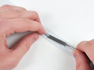

Starting near the display and working around to the front of the computer, pry up on the upper case. It is held with clips on the right above the optical drive. These will release with some firm lifting pressure.
Be careful when prying up the upper case. It's very easy to slice open a fingertip and thus provide the blood sacrifice the Mac gods sometimes require of those who insist on doing their own repairs.
Danger Will Robinson!! My upper case did NOT want to come out on the right side. I just trusted to cameronmoll and kept lifting straight up. Finally, it came loose, but it wasn't easy. Meanwhile, while I was dealing with the cable -- just had to pull up a black tab hooked to it -- I somehow managed to chip the front, top edge of the upper case -- the edge farthest from the screen -- in two places, one on the right, one on the left. So, watch that edge, it is thin!
Regarding the right side, there is a series of 3-4 plastic snap in locks on that side along the optical drive, holding the case down in lieu of screws. It takes serious pressure to remove the snapped in pieces (just lift straight up). You should also make sure to line them up when you put the casing back on. Another picture might help show that portion better
My upper case also came off with a little difficulty. There are some plastic tabs that hold the case down (4 of them). They sorta "pinch" onto 4 little bars that are part of the upper case (note, the bars appear to be metal). I worked my upper case to the left a little and it came out easier. One of the these tabs was really tight. Note: if you do this, one or more of the tabs may stay on the upper case, you'll need to move them back in place before putting the upper case back on (pry it off the upper case with a spudger, or very carefully with a flat screwdriver as to not damage it). It will slide back into a slot on the body.

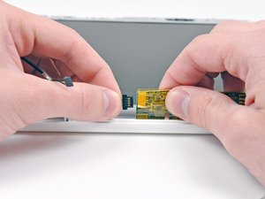

Use a spudger to carefully disconnect the microphone cable from the logic board. You'll want to work from side to side, and slowly wiggle the connector out of its socket.
VERY IMPORTANT!!!! The plug backs out of its jack along the plane of the logic board, away from the front of the computer, toward the screen. YOU DO NOT PULL IT STRAIGHT UP FROM THE BOARD! The photo is ambiguous, and I ended up ripping away from the logic board the jack the microphone cable plugs into. I doubt I'll be able to solder it back on again, so bye-bye internal mic.

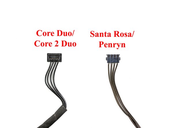

Disconnect the two antenna cables from the Airport card, and the black inverter cable from the logic board. (Pull vertically on all three.)
(carefully 'lift up' on each antenna cables and on the black inverter cable to to disconnect them from the logic board)
Quote from John098:
seems my laptop has 3 antenna cables... a black, blue and grey cabled one. Does this mean I have a 'Penryn/Santa Rosa MacBook' and do I need to look at a different guide..?
on the back cover there should be in small print that should tell you the model type of ur mac. its right between the two screews and shouldnt be that hard to find unless you somehow scratched it off
%%@^. I ripped out one of the antenna's connectors. Any idea how to fix this?
Make sure to pull vertically on the inverter cable to remove it from the motherboard.

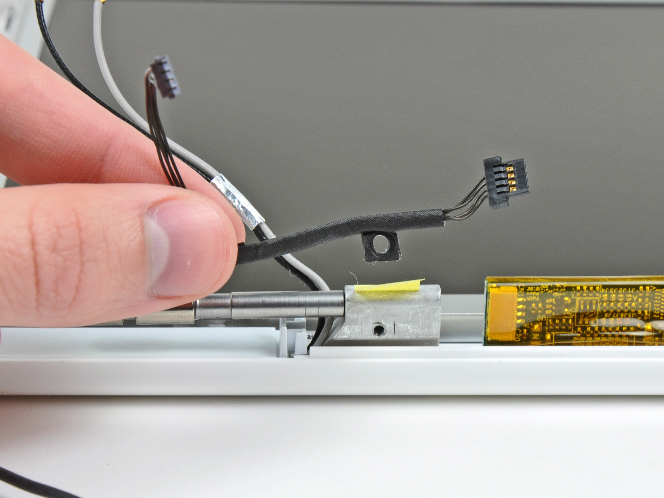

Take a good look at where all the cables and wires are routed in the next couple steps! You might even want to take a few pictures. They must be routed exactly the same way going back together. Either stuff will not fit, or you'll get intermittent video.

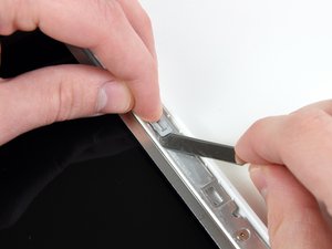

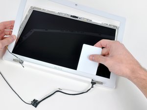

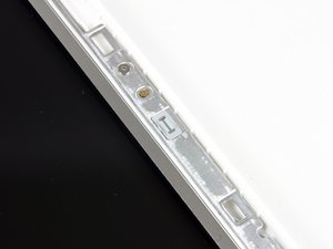

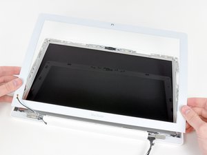

Use a thin plastic card to release the tabs holding the front display bezel to the display assembly. There are five tabs along the left side of the display bezel.

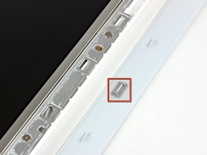

When you go to replace the bezel, look at the back side and disconnect any of the little snap-on tabs that may not have stayed in the metal bracket around the LCD. On a white MacBook they were grey, about 4mm x 8mm. They work best if you put them into the metal frame separate from the bezel and then snap the bezel into them.
The best way to remove them seemed to be by placing my thumb over one edge (so they didn’t fly off) and prying with a thin, flat screwdriver flat against the bezel tab.
Hello I've seen a video on Youtube where the guy skipped all the previous steps and got to the inverter without taking the screen off. Seems like it saves a lot of time and potential problems, since I have never done anything like this. Does anyone recommend doing it? I see it's more accessible to just try to get to the inverter without taking the screen off first.
Continue to free the tabs along the the top edge of the display assembly.
Next, free the five tabs securing the display bezel on the right side.
Lift up the front display bezel from the top and use your plastic card to free the tabs along the bottom edge of the display bezel.
After freeing all holding tabs, lift the front display bezel away from the display assembly.
A note for anyone panicking because they can't get their front bezel back on:
It is common for the grey clips holding the bezel to the display to come up along with the bezel. If you have ANY grey clips attached to the back of your bezel, in order to replace the bezel you need to first remove the clips from the bezel and reinsert them into the holes in the display panel manually first! Once all of these clips are back in place, the bezel can be reattached.
These clips are very fragile and if you are having this problem odds are you have already severely bent some of them. Check the tiny plastic clasps and if they are squashed down, gently pry them back up with your fingernail. Again these grey clips are very fragile, so use care in reattaching them.
This was a very helpful tip. I made the mistake at first when reading your note, thinking that the gray clips were supposed to be on the bezel, not the display, but quickly corrected that.
For anyone confused, the bezel is the thin plastic part surrounded the display, and the display of course houses the LCD.
Another note:
The easiest way to remove the clips from the bezel is from the side and pry up. To reattach them to the display, put one end of the clip in first, and then use tweezers to poke in the other end of the clip.
Quote from WillyDavidK:
Use a metal spudger or another thin tool to carefully pry the gray plastic clips off the tabs molded into the front display bezel. A 0.8mm flat screwdriver may be useful for this step.
I found that an easy way to remove the clips from the bezel is to use a plastic knife (knife as in the utensil). Sliding the knife under one of the clip's long sides and prying upwards worked well for me. Thanks MC25 and WillyDavidK for the tips, they worked great!
Insert the longer end of the retaining clip beneath the edge of its recess cut into the LCD bracket.
Use the edge of a metal spudger to push the shorter tab on the other side of the retaining clip into the recess cut into the LCD bracket.

Pay attention here. I missed the part about pinching the cable and that's exactly what I did. It helps to pull the video and mic cables tight to fit the clutch cover on. I also had to make sure the pink/white cables were up and out of the way. When I did it correctly, it slid in pretty easily. It would help to really look at how things are arranged when you are taking it apart, too. There's some tabs that interconnect with the plastic sliding things you removed in steps 46-47.
Lift the inverter slightly out of the display.
Disconnect the inverter cable from the left side of the inverter board.
Set the inverter board back down into its recess molded into the rear display bezel.
Gently peel back the strip of tape covering the inverter cable.
Remove the single 3.2 mm Phillips screw securing the inverter cable to the left clutch hinge.
Remove the inverter cable from the display.
