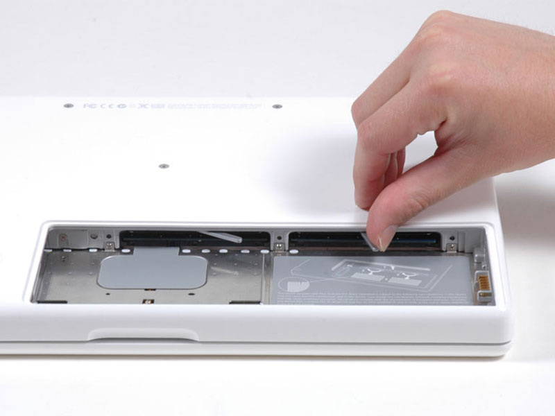

    • Use a coin or spudger to rotate the battery-locking screw 90 degrees clockwise.
  2. MacBook Core 2 Duo RAM Replacement: step 2, image 1 of 1
  3. MacBook Core 2 Duo RAM Replacement, Memory Cover: step 3, image 1 of 1
    • Unscrew the three evenly-spaced Phillips screws from along the rear wall of the battery compartment.
    • The screws are captive to the metal memory cover so you cannot lose them.
    • Using The Flexible Extension sold by iFixit will help with this step.
  4. MacBook Core 2 Duo RAM Replacement: step 4, image 1 of 1
    • Grasp the right end of the L-shaped memory cover, then pull it towards you so it clears the battery compartment opening.
    • Lift the memory cover up and out of the computer.
  5. MacBook Core 2 Duo RAM Replacement, Pull the RAM out: step 5, image 1 of 1
    • Pull back on the metal lever and slide the RAM chip out from its compartment.
    • Unlike the iBook line, the MacBook has two SO-DIMM RAM slots.
    • When installing RAM, be sure to push the chips in firmly or else the computer will not register them.
