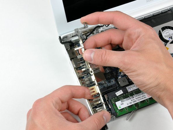

Image 1/1: Starting near the display and working around to the front of the computer, pry up on the upper case. A [product|IF145-000|plastic opening tool] or a medium hard guitar pick may help you to do this.
  • There's a trackpad and keyboard ribbon connecting the upper case to the logic board, so don't pull the upper case off entirely just yet.
  • Starting near the display and working around to the front of the computer, pry up on the upper case. A plastic opening tool or a medium hard guitar pick may help you to do this.
  • The upper case is likely to stick at the connection above the optical drive. If this is the case, first free all other sides, then proceed to pull upward on the upper case from either side of the optical drive opening.
  • If you stand the base on end to get a better look you may displace the total of 4 grey plastic clips that hold the keyboard in place. Don't panic. They slide into slots at the top right-most edge near the CD drive.
There will be 4 grey plastic clips just right of the DVD drive. Note their position as they will fall out in the next steps.

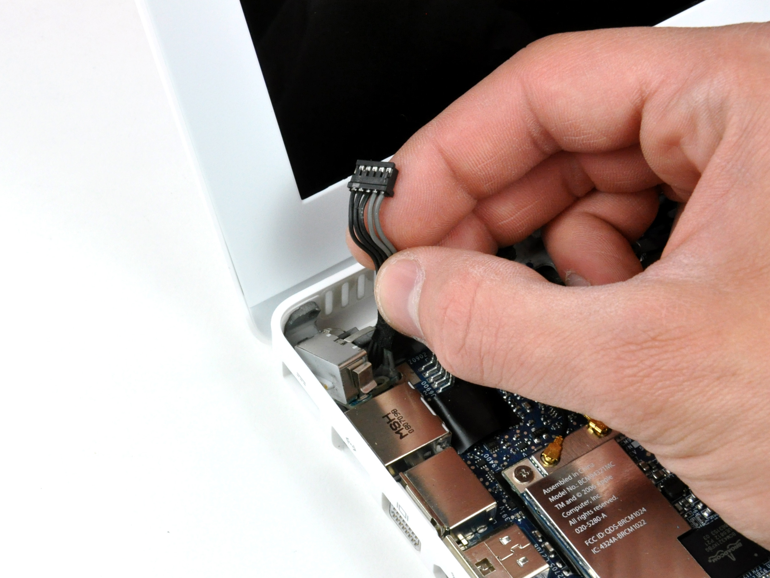

Image 1/3: If there is no black tab, you can also use a spudger to gently pry the connector from its housing.  This connector is tall, so be sure to pry straight up.
  • While holding up the upper case, pull up the black tab of the silver cable away from its connector.
  • If there is no black tab, you can also use a spudger to gently pry the connector from its housing. This connector is tall, so be sure to pry straight up.

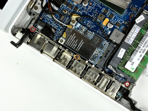

Image 1/1: One 3.25mm Phillips #000 (Head: 4mm dia. x  .5mm thick)
  • Remove the left 3 mm and right 8 mm (right screw is unnecessary to remove on some models)
    • One 3.25mm Phillips #000 (Head: 4mm dia. x .5mm thick)
    • One 8.5mm Phillips #000 (Head: 4mm dia. x .75mm thick
  • The Phillips screws securing the MagSafe board and the left speaker to the lower case. The next two speaker steps are unnecessary one some models as are steps 16 and 17 as the magsafe will drop in without removing these.

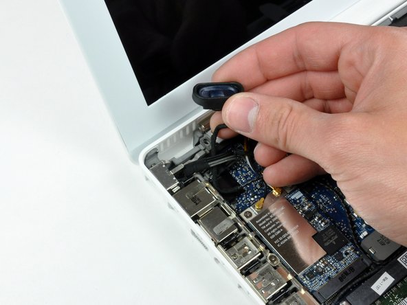

Image 1/3: Use a spudger to lift the left speaker out of its housing. Grasp it with your fingers and move it out of the way.
  • Gently de-route the speaker cable from the left I/O frame.
  • Use a spudger to lift the left speaker out of its housing. Grasp it with your fingers and move it out of the way.
  • Do not attempt to fully remove the speaker from the laptop, it is still attached the the logic board.

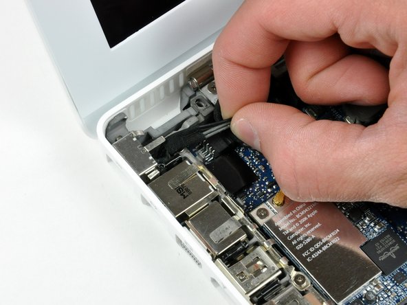

Image 1/1: Disconnect the MagSafe board connector from the logic board.
  • The MagSafe board connector is underneath the wires, be sure to pull on the connector itself pulling parallel to the socket.
  • Disconnect the MagSafe board connector from the logic board.

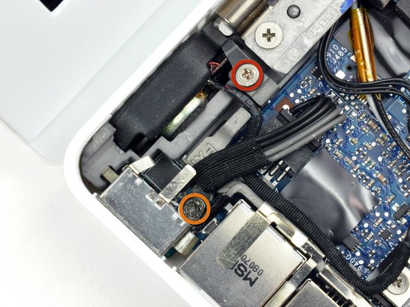

Image 1/1: Two 7.5 mm Phillips screws from the top and bottom end of the left I/O frame.
  • Remove the following three screws securing the left I/O frame:
    • Two 7.5 mm Phillips screws from the top and bottom end of the left I/O frame.
    • One 9 mm Phillips from the middle of the left I/O frame.
    • On some models, all three screws may be the same size.
  • If present, remove the black plastic spacer at the bottom of the left I/O frame.

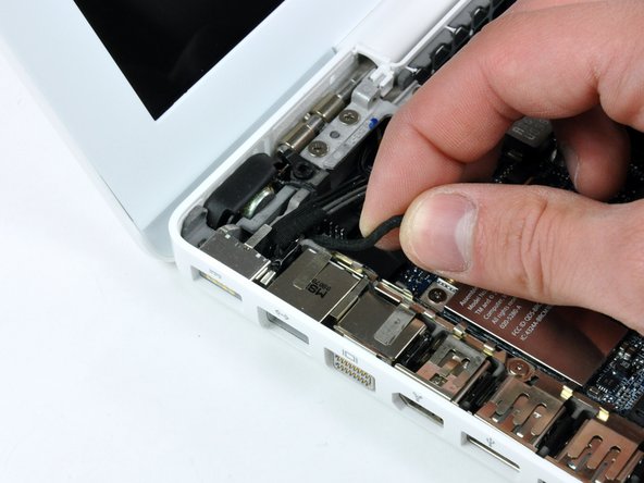

Image 1/1: Pay attention to the thin metal EMI fingers, as they may catch as you remove the left I/O frame.
  • Lift the left I/O frame up and out of the computer.
  • Pay attention to the thin metal EMI fingers, as they may catch as you remove the left I/O frame.
two of the emi 'fingers' on the outboard edge are bent to clasp the metal below (this can be seen in the photo) and it required special attention on dis- and re-assembly
David A - Reply

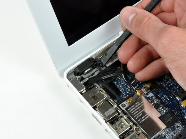

Image 1/1: Using your fingers, pull out the MagSafe board.
  • The MagSafe board is now free of all connections and can be detached freely from the logic board.
  • Using your fingers, pull out the MagSafe board.
carefully transfer the EMI shield to the new part
David A - Reply
Clean out corrosion here (if present) while the board is removed if you can. My "patient" was covered with the stuff, even over onto parts of the logic board connecting port's leads, creating a dangerous environment!
shomizu9 - Reply
