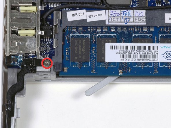

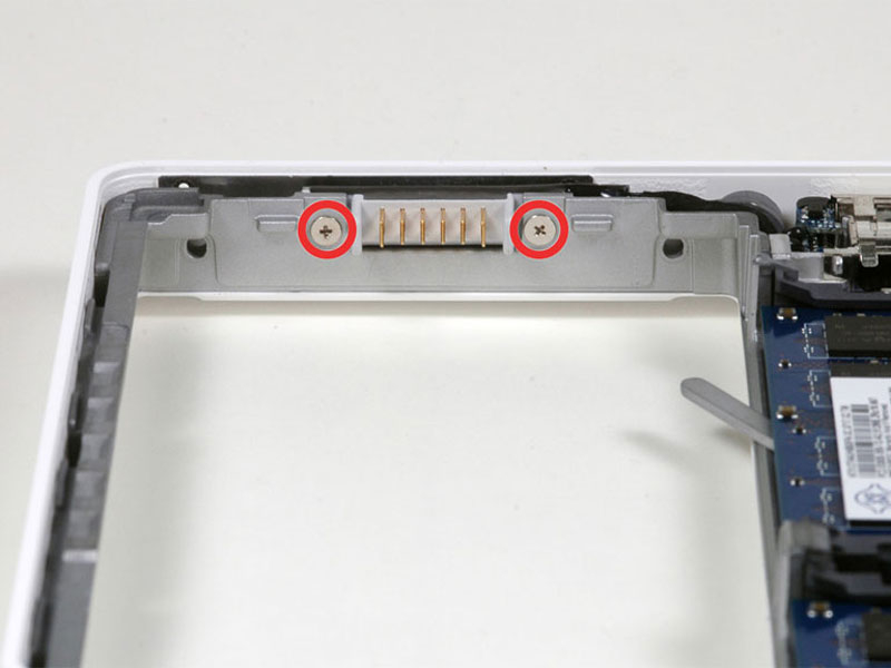

Image 1/1: Two 6.25 mm Phillips #000. (Head: 4 mm. dia. x .5mm thick)
  • Remove the two Phillips screws from either side of the right wall of the battery compartment (not the ones closest to the battery connector).
    • Two 6.25 mm Phillips #000. (Head: 4 mm. dia. x .5mm thick)
The steps do not tell you what length screw that is needed to be here. What I can tell you that is the screw needs to be 5mm or 6mm, NOT 7.5 or 8mm or 9mm.

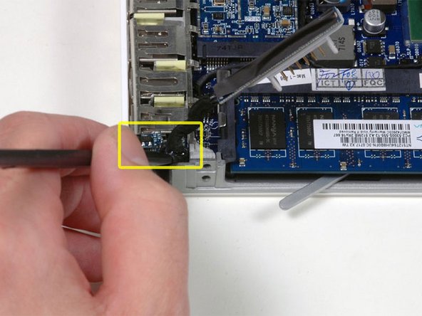

Image 1/3: If there is no black tab, you can also use a spudger to gently pry the connector from its housing.  This connector is tall, so be sure to pry straight up.
  • While holding up the upper case, pull up the black tab of the silver cable away from its connector.
  • If there is no black tab, you can also use a spudger to gently pry the connector from its housing. This connector is tall, so be sure to pry straight up.
  • If you happen to break your upper case cable when removing the upper case, we stock the cable individually and we have a guide that makes replacing it easy.
  • While you have the upper case removed, you may want to take the opportunity to remove dust, hair, etc. It's best to use a can of compressed air, though if you use a brush, make sure that its bristles are made of a material (usually animal hair) that doesn't generate static electricity, which can destroy electronics.

Image 1/1:
  • Remove the single Phillips screw near the battery connector.
Image 1/1: Penryn models do not have a removable spacer, and instead, an extra screw must be removed from the USB backing plate, and the plate lifted up to allow clearance for step 16.
  • Remove the small black plastic spacer from the computer.
  • Penryn models do not have a removable spacer, and instead, an extra screw must be removed from the USB backing plate, and the plate lifted up to allow clearance for step 16.
Image 1/1:
  • Remove the two Phillips screws attaching the battery connector to the lower case.
What size are these screws?
wbgowdy336 - Reply
Image 1/1:
  • Use a spudger to carefully pry the battery connector up and disconnect it from the logic board.
