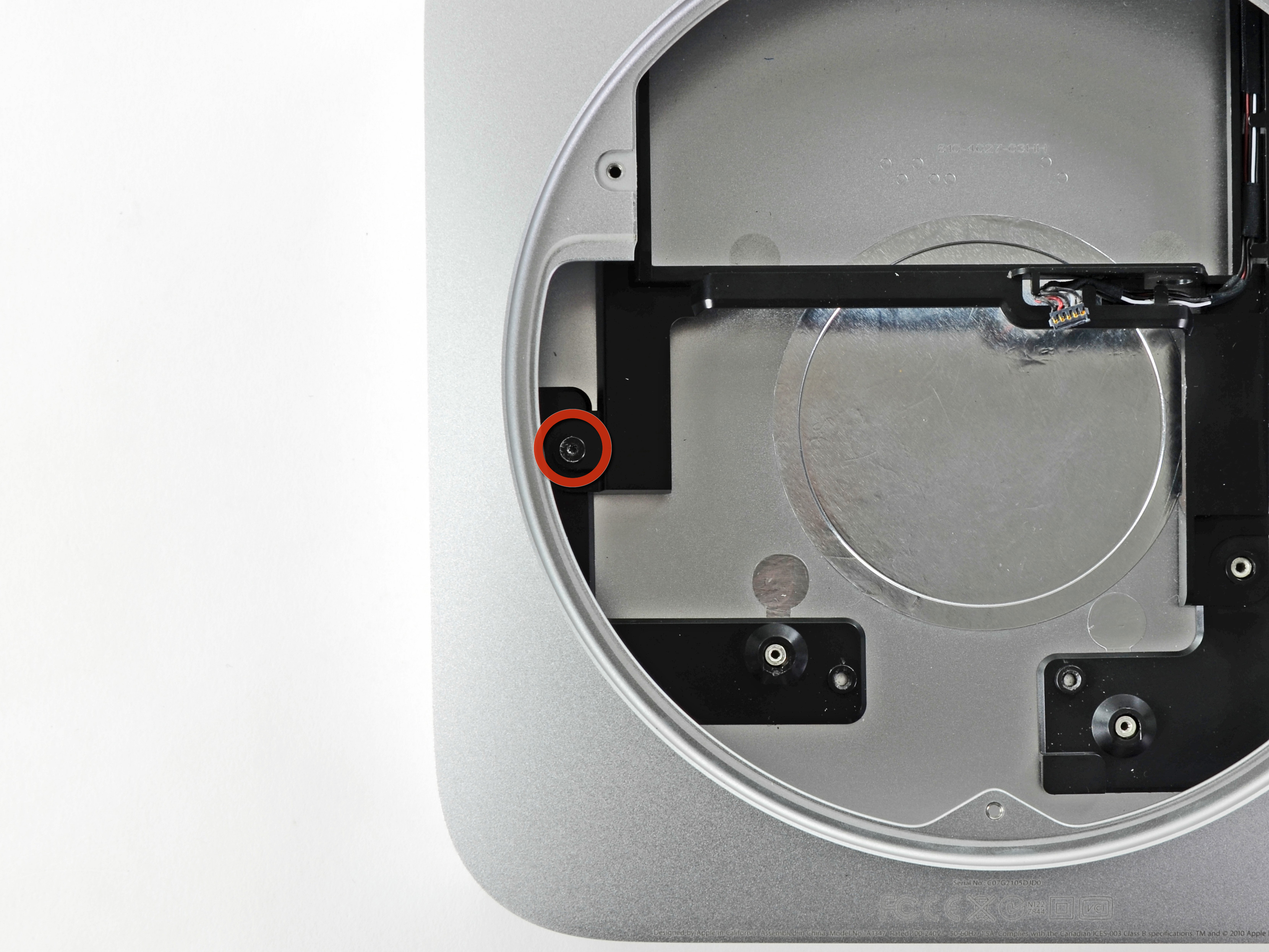

Remove the 7.9 mm T6 Torx screw securing the power supply and hard drive tray to the outer case.
Remove the 7.9 mm T6 Torx screw securing the hard drive tray to the outer case.
