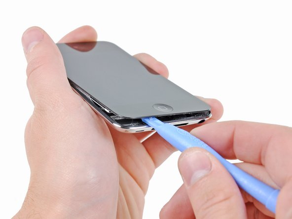

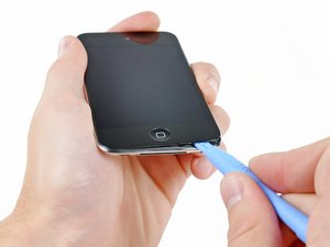

With the heat gun set on "low", begin heating the lower portion of the Touch near the home button.
Insert the edge of an iPod opening tool between the front glass panel and the plastic bezel near the home button.
Pry the bottom edge of the front panel upward, being careful not to bend the glass excessively.
There should be (in general) better notes about the reassembly process. Getting the thing glued back in is WAY harder than just "reverse this step." Getting it to sit flush with any kind of adhesion is pretty difficult. No real advice other than make sure the edges of the metal thing at the top of the back of the digitizer are in the right slots and use judiciously placed pieces of 3M 300LSE adhesive.
I actually just figured it out. I had the ribbon cable for the digitizer running under the LCD and that wasn't allowing the LCD to sit down far enough. By re-folding the digitizer cable so it was triple-folded (when you do it you'll see what I mean) and only under the glass where there is no LCD, you'll get the glass to sit right.
Glue is under the black part of the glass, not under the clear part of the glass.
The Glue is mostly around the top and bottom about 1/2 inch in or so, around both left and right edges the strip of glue is very thin about 1/8 inch or so.
I had success with heat and sliding the tool or pick up and down the side where there is less glue until it started separating being careful that I was between front glass panel and the black plastic bezel.

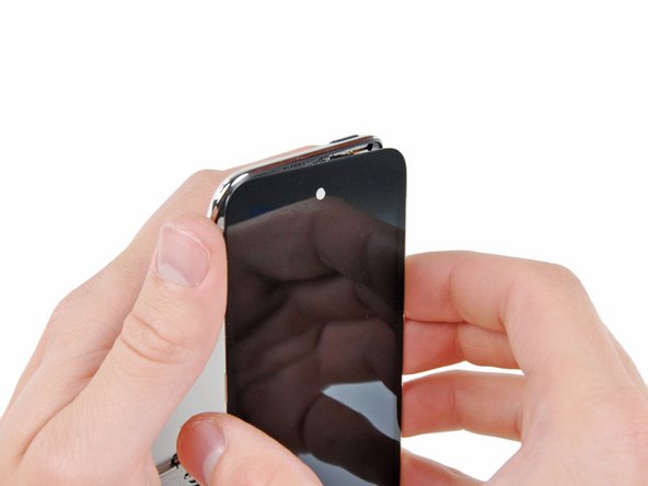

When there is enough room to grab the bottom edge of the front panel, lift it away from the body of the Touch to peel up the adhesive along its left and right edges.
Carefully pull the top of the front panel assembly away from the adhesive holding it to the Touch, minding the short digitizer cable connecting the two components.
The LCD cable which attaches to the logic board, is, indeed, very short. When reassembling the iPod, you may only be able to leave a small crack between the glass and the body to allow for enough space to reattach this cable. A plastic opening tool works well, but be warned: it takes quite a bit of patience.
Indeed the LCD cable which attaches to the logic board is short and I spent a good 30 minutes trying to get it to seat. When I finally did I realized I broke the right side and that is why my display is not working now. When they say difficult, they mean difficult - I have experience with electronics and I recommend you first practice on an older unit if you can.

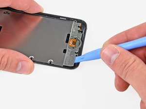

The antenna cable will almost always stick to the digitzer and often the glass is broken there. You can use a knife to pick out broken glass around the edges elsewhere but use ONLY PLASTIC tool to separate the antenna cable from the old digitzer. This cable is very thin and a metal tool can easily cut the cable which you cannot then repair but must buy a replacement.
If you are removing broken glass be sure to recover the steel plate glued to the top of glass as well as the home button at the bottom of the assembly.
This steel plate or bracket has been discussed many times here. My best experience is to NOT move it to a new screen. Without the bracket and using enough adhesive in fact brings the new screen closer to the chassis and a snugger fit. Read more here: What parts to move from the broken screen?

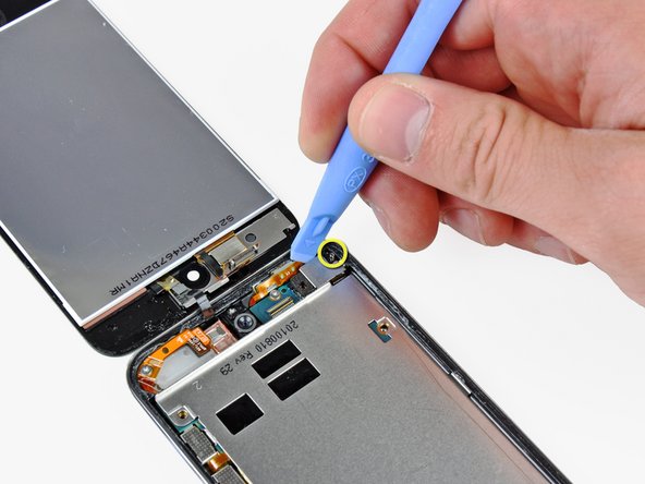

Use the edge of an iPod opening tool to pry the thin steel cover up from the rear-facing camera.
Remove the steel cover from the iPod.
Be sure to get the tool down deep when removing the rear camera. If not, you can accidentally snag the mid-section of the camera and it will come apart -- and you'll end up buying a replacement.
I have snagged that part of the camera several times. Easy to fix with super-glue along the edges of the cover. Works great. Sometimes no matter how carefully you pry up it falls apart.
asle -
This metal plate fits under plastic near RHS edge, and other side drops between the camera and a circuit board - to refit, you may need to loosen a nearby screw to allow you to move the circuit board a little to let this metal plate clip onto the side of the camera.
I had to press down hard with a plastic tool to get this metal plate to clip on.
Don't forget to re-tighten it later (I forgot).
A strip metallic cover, glued to display isn't mentioned in this guide.
Note that most new front panels are going without this part and you would need to remount it.

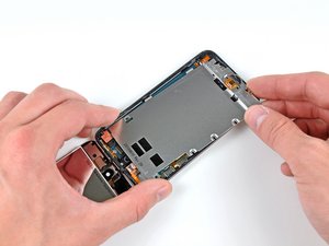

Insert the edge of an iPod opening tool under the steel mid plate near the bottom left corner of the Touch.
Pry upward to separate the plate from the adhesive securing it to the plastic inner case.
If the plate is still attached to the logic board re-warm the area to loosen the adhesive, then separate the plate from the logic board using the opening tool
There is a very thin ribbon cable here that connects the volume and power buttons to the logic board. Try to work around this area like shown so not to rip the cable. Be sure to hold down this cable when lifting the plate. It could stick to the plate due to residual glue. It is extremely fragile.
There is also adhesive under the area shown in red.
I couldn't get a spudger in-between this space, so I went to the side where the three screws were on the left hand side and worked my way towards the bottom to separate the glue...
The power and volume wire on the logic board were covered with adhesive. Be careful! While trying to remove the steel mid plane I found that the adhesive will rip the ribbon!
Here is where you take it easy. Two things can be broken here.
-Use time to carefully separate the bottom left part of the midplane. It sticks to the speaker which you tear the speaker leads if you are to hasty to lift it up. And remember the mid plane must not be bended up here since it needs to be 100% aligned so the new digitizer does not bulge here when in place.
- The second picture. The black visible adhesive sticks to the volume cable. Use time to carefully separate the mid plane here so the cable is not ripped when you lift up the midplane. Pry a plastic tool like the picture or/and a spudger slowly in until you see/feel the midplane loosening. A broken volume cable is no fun.
That small ribbon cable ripped, be sure to really watch this - look at the second picture in this step and try to make sure you understand where it is on the board under it.
This was difficult during both disassembly and reassembly. I used a thin guitar pick to separate the ribbon cable by the volume buttons from the steel midplane. Reassembly was tough because I didn't have the ipod dock connector seated correctly, AND more importantly, the speaker has a part that needs to be inserted into a black part on TOP of the dock connector-- it looks almost like a tiny air duct that has a foam gasket around it.
I was able to replace the home button ribbon cable without having to fully remove the steel mid plane. It lifted up enough from the iPod's body that I was able to slip the ribbon in around the support it sticks to and hold it in place until the adhesive set.
Much simpler, and didn't cause any problems -- the mid plane didn't deform, and snapped right back into place.

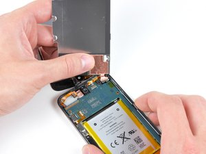

Slightly tilt the steel mid plane to dislodge it from the rear case.
Lift the steel mid plane up off the rear case and peel off the piece of copper tape stuck to the rear-facing camera.
I was able to stop at step 8 for the battery replacement.
Once you remove the metal shield, desolder the 3 leads. Then use your heat gun to warm the battery. Use plastic pry tool between copper backing and battery and separate them (two adhesive strips on the sides of the battery). Once done with this, you can snake the battery ribbon cable from between the logic board and aluminum casing. Not as easily, but still very doable, snake the new battery ribbon back through the same slot; solder 3 points and reassemble. Much easier than removing the entire board. Good luck!
Oh also, not mentioned in this guide - there is a plastic/silicon substance covering the 3 leads. Prior to desoldering remove this as much as possible with metal or plastic spudger (if metal, be sure not to bridge the connections).
I stopped dismantling here as well and was able to replace the battery and everything works on the ipod. tricky parts for me were the copper adhesive on the rear camera and getting the data display cable reconnected
I used plenty of heat first heating the ipod in an industrial oven to about 150 F and then as needed heating a heat gun.

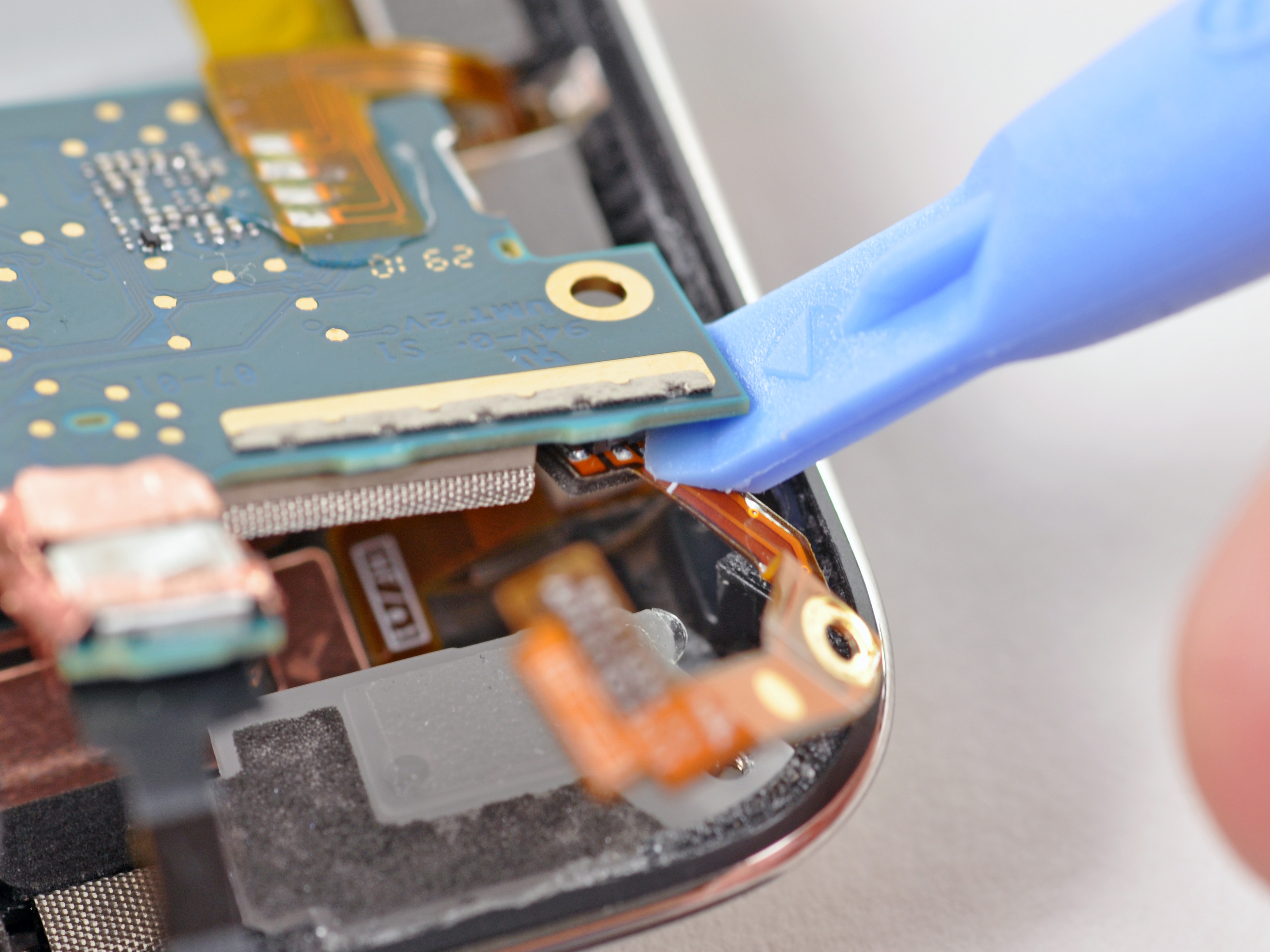

While carefully lifting the top edge of the logic board, use the edge of an iPod opening tool to pry the Wi-Fi antenna connector away from the logic board.
Remove the Wi-Fi antenna from your iPod.
So now what. I have the case open and the antenna off. How do I actually plug-in the new antenna. I have tried pushing up with a screw driver with no success. Once I do plug it in, how do I get it to fit. I can see in the picture there are some crazy bends in the original cable. What are those bends, and how do I make them on the new antenna without breaking it?
