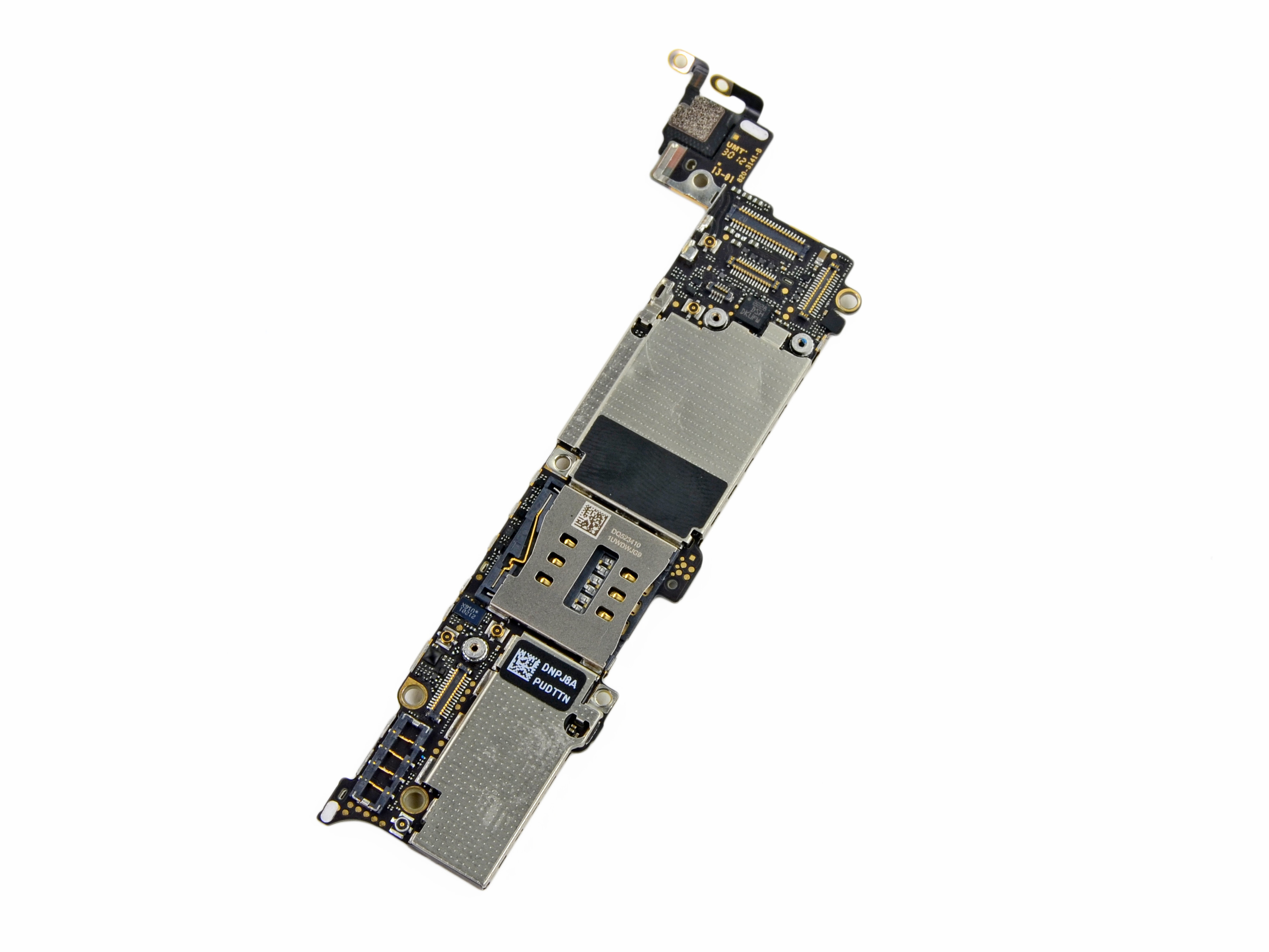

  30. iPhone 5 Logic Board Replacement: step 30, image 1 of 3 iPhone 5 Logic Board Replacement: step 30, image 2 of 3 iPhone 5 Logic Board Replacement: step 30, image 3 of 3
    • Rotate the logic board assembly toward the battery side of the rear case.
    • Do not attempt to completely remove the logic board assembly from the rear case, yet; there is still one cable connected to the underside of the logic board.
    • The flash surround is adhered to the flash unit and the rear case. If it stays on the rear case remove with tweezers and mount it back on the flash unit.
    • Note: when reassembling your device, be sure that the lower interconnect cable is not tucked underneath the logic board.

    • Remove the logic board assembly from the rear case.
    • While your logic board is out of your phone, keep it on a grounded anti-static mat to prevent any damage to the circuitry.
  33. iPhone 5 Logic Board Replacement, Rear-Facing Camera: step 33, image 1 of 1
    • Remove two 1.1 mm Phillips screws securing the rear-facing camera bracket to the logic board.
  34. iPhone 5 Logic Board Replacement: step 34, image 1 of 2 iPhone 5 Logic Board Replacement: step 34, image 2 of 2
    • Remove the rear-facing camera bracket from the logic board.
  35. iPhone 5 Logic Board Replacement: step 35, image 1 of 1
    • Use the flat end of a spudger to disconnect the rear-facing camera cable from its socket on the logic board.
  36. iPhone 5 Logic Board Replacement: step 36, image 1 of 2 iPhone 5 Logic Board Replacement: step 36, image 2 of 2
    • Remove the rear-facing camera from the logic board.
    • Your replacement part may not come with the flash surround—if not, remove it from the old camera and transfer it to your replacement.
  37. iPhone 5 Logic Board Replacement, Logic Board: step 37, image 1 of 2 iPhone 5 Logic Board Replacement, Logic Board: step 37, image 2 of 2
    • Use the flat end of a spudger to disconnect the bottoms of the interconnect cables from their sockets on the logic board.
  38. iPhone 5 Logic Board Replacement: step 38, image 1 of 1
    • Remove the two interconnect cables from the logic board.
  39. iPhone 5 Logic Board Replacement: step 39, image 1 of 1
    • The bare logic board remains.
