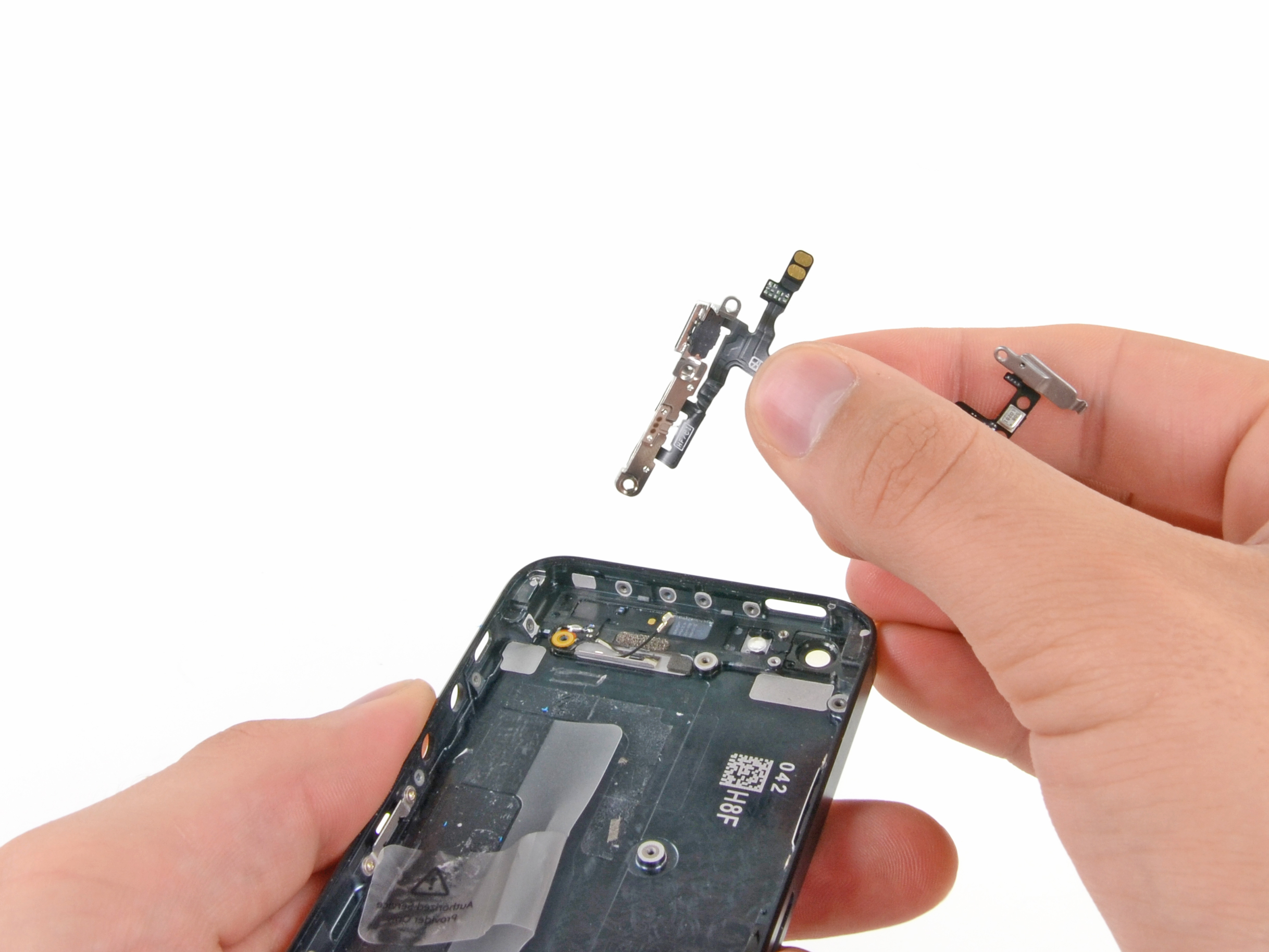

  20. iPhone 5 Audio Control and Power Button Cable Replacement, Logic Board Assembly: step 20, image 1 of 1
    • Use the tip of a spudger to pry the cellular data antenna cable connector up from its socket on the logic board, just above the speaker enclosure.
  21. iPhone 5 Audio Control and Power Button Cable Replacement: step 21, image 1 of 1
    • Remove the following two screws securing the top logic board bracket to the rear case:
    • One 1.5 mm Phillips screw
    • One 2.3 mm Phillips screw
  22. iPhone 5 Audio Control and Power Button Cable Replacement: step 22, image 1 of 2 iPhone 5 Audio Control and Power Button Cable Replacement: step 22, image 2 of 2
    • Remove the bracket from the top of the logic board.
    • Be sure not to break off the tiny grounding tab that sticks up off of the bracket next to the rear facing camera.
    • On newer models, the bracket may be attached to the camera housing and will not come completely out.
  23. iPhone 5 Audio Control and Power Button Cable Replacement: step 23, image 1 of 3 iPhone 5 Audio Control and Power Button Cable Replacement: step 23, image 2 of 3 iPhone 5 Audio Control and Power Button Cable Replacement: step 23, image 3 of 3
    • Use the flat end of a spudger to disconnect the following three cables from the logic board:
    • Upper interconnect cable
    • Button assembly cable
    • Lower interconnect cable
  24. iPhone 5 Audio Control and Power Button Cable Replacement: step 24, image 1 of 1
    • Remove the two 1.3 mm Phillips screws from the inner top of the rear case.
  25. iPhone 5 Audio Control and Power Button Cable Replacement: step 25, image 1 of 1
    • Remove the single 1.2 mm Phillips screw remaining in the mid-section logic board bracket.
  26. iPhone 5 Audio Control and Power Button Cable Replacement: step 26, image 1 of 2 iPhone 5 Audio Control and Power Button Cable Replacement: step 26, image 2 of 2
    • Remove the mid-section bracket from the logic board.
  27. iPhone 5 Audio Control and Power Button Cable Replacement: step 27, image 1 of 2 iPhone 5 Audio Control and Power Button Cable Replacement: step 27, image 2 of 2
    • Use a spudger to pry the Lightning connector cable connector up from its socket on the logic board.
    • Gently peel the cable back and out of the way of the logic board.
  28. iPhone 5 Audio Control and Power Button Cable Replacement: step 28, image 1 of 3 iPhone 5 Audio Control and Power Button Cable Replacement: step 28, image 2 of 3 iPhone 5 Audio Control and Power Button Cable Replacement: step 28, image 3 of 3
    • Depress the SIM card release on the right side of the iPhone with a SIM card eject tool or a bent paperclip to eject the SIM card tray.
    • Alternatively, you can press the SIM card eject lever from the inside with the flat end of a spudger.
    • Remove the SIM card tray from the iPhone.
  29. iPhone 5 Audio Control and Power Button Cable Replacement: step 29, image 1 of 1
    Tool used on this step:
    Standoff Screwdriver for iPhones
    $5.49
    Buy
    • Remove the following screws securing the logic board to the rear case:
    • Two 2.3 mm Phillips screws
    • Two 2.7 mm standoff screws
    • Standoff screws are best removed using a standoff screwdriver or bit.
    • In a pinch, a small flathead screwdriver will do the job—but use extra caution to ensure it doesn't slip and damage surrounding components.
    • One non-magnetic 2.7 mm standoff screw
    • Be sure to put this screw back in its original position at the top of the logic board. A magnetized screw may interfere with the digital compass.
  30. iPhone 5 Audio Control and Power Button Cable Replacement: step 30, image 1 of 3 iPhone 5 Audio Control and Power Button Cable Replacement: step 30, image 2 of 3 iPhone 5 Audio Control and Power Button Cable Replacement: step 30, image 3 of 3
    • Rotate the logic board assembly toward the battery side of the rear case.
    • Do not attempt to completely remove the logic board assembly from the rear case, yet; there is still one cable connected to the underside of the logic board.
    • The flash surround is adhered to the flash unit and the rear case. If it stays on the rear case remove with tweezers and mount it back on the flash unit.

  43. iPhone 5 Audio Control and Power Button Cable Replacement, Audio Control and Power Button Cable: step 43, image 1 of 2 iPhone 5 Audio Control and Power Button Cable Replacement, Audio Control and Power Button Cable: step 43, image 2 of 2
    • Use the tip of a spudger to slide the power button bracket up and to the left to unhook it from the metal hinge.
  44. iPhone 5 Audio Control and Power Button Cable Replacement: step 44, image 1 of 2 iPhone 5 Audio Control and Power Button Cable Replacement: step 44, image 2 of 2
    • Use the flat edge of a spudger to pry the cable up from the adhesive securing it to the rear case.
  45. iPhone 5 Audio Control and Power Button Cable Replacement: step 45, image 1 of 3 iPhone 5 Audio Control and Power Button Cable Replacement: step 45, image 2 of 3 iPhone 5 Audio Control and Power Button Cable Replacement: step 45, image 3 of 3
    • Continue prying the audio control cable up from the rear case.
    • If your replacement part doesn't include the metal bracket, use a heat gun or hair dryer to soften the adhesive on the audio control cable and peel it off of the metal bracket with a spudger.
