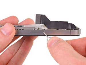

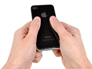

Image 1/2: The panel will move about 2 mm. Image 2/2: The panel will move about 2 mm.
  • Push the rear panel toward the top edge of the iPhone.
  • The panel will move about 2 mm.
how can i take out the screw if it is stripped
Manny Chaidez - Reply
with a small driller, but I guess it is very difficult. Never attempted that myself on an iPhone.
lantzero -
There is no screw in Step 2?
Is the screw stripped or the head stripped?
I have used superglue on the screwdriver to remove a stripped screw, it would turn but not come out, with superglue I could turn and pull the screw out. May also work on a stripped head.
Trevor -
If you are careful, use a Dremel tool and a micro drill bit (sold where Dremel tools are purchased) to drill it out. Last resort kind of thing, good luck.

Why isn't it moving? I removed my screws.
Thomas The Train - Reply
I pried one end of the back off only to find 2 funny little screws holding the other end on so I took my Dremel, like Jack said, and ground those suckers out. Once I had the back off I loosened all the screws then turned it upside down and shook the crap out of it. The screws went flying everywhere and fell on the floor. Its my moms house so of course she's got gross brown carpet. How am I supposed to find my screws in that? I get the vacuum out and go over every inch of the floor to suck up all them screws. Then I dump the bag on the table and all I find is a bunch of hair and gods knows what else, but no screws. When I look for my phone I see its covered in all that stuff that came out of the vacuum. I mean, what's up with that? How can I work on my phone if its covered in dirt? Nobody said anything about that, did they? The average guy's gonna screw up his phone big time if he follows these instructions and nobody warns him about all the dirt that's gonna end up in his phone. Are you kidding me!! Now what?
Marv - Reply
I didn't see any extra screws holding the back in place. I had to use the included pry tool to get the back off. Just start at the bottom and pry gently...if you just "pull" like the guide says it won't work.
Brian - Reply
Don't use too much force to slide the back -- the back on my phone was hard to slide, and I bent and broke a silver metal contact tab at the top of the back (on the inside).
perryskeath - Reply

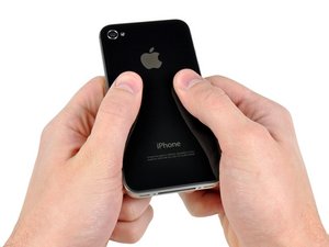

Image 1/1: Remove the rear panel from the iPhone.
  • Pull the rear panel away from the back of the iPhone, being careful not to damage the plastic clips attached to the rear panel.
  • Remove the rear panel from the iPhone.
On reassembly, be sure to clean the metal plate at the place of contact with the tiny pressure contact mentioned in step 4.
Harald Brandt - Reply
Marv - Reply
The replacement panel I got had two sheets of protective plastic on the inside and one on the outside. I used a toothpick to carefully lift and peel the two inside sheets off. One small one was over the lens on the inside. The other was over some large brown sheet of unknown function (though I think it goes over the battery). When I peel that away, some of the brown material tried to lift of with it, so be very careful.
dhein - Reply
From this point go to step ?? Just peel off the tape from the chip. Take some aluminium foil and cut a hole the size of the chip (Use a second layer of foil if you don't thrust it). Heat the chip as described at temperature 300 deg C for 5 minutes. Let it cool down. Reassemble and ..... hura WIFI is on again.
Lucasa Clearman - Reply

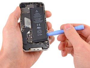

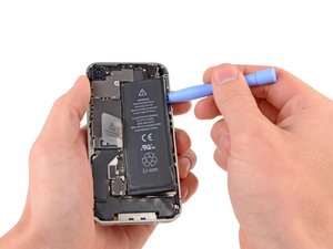

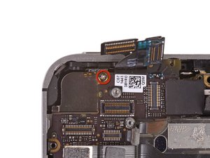

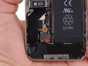

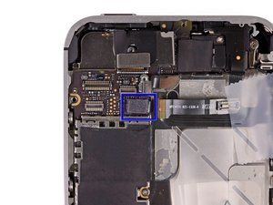

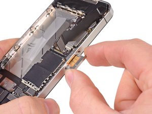

Image 1/3: One 1.7 mm Phillips screw Image 2/3: One 1.5 mm Phillips screw. Image 3/3: Use a plastic opening tool to gently detach the battery connector from the socket on the device. Start lifting off the connector from the bottom side, by placing the tip of the tool between the loudspeaker enclosure and the metal cover of the connector.
  • Remove the following screws securing the battery connector to the logic board:
    • One 1.7 mm Phillips screw
    • One 1.5 mm Phillips screw.
  • Use a plastic opening tool to gently detach the battery connector from the socket on the device. Start lifting off the connector from the bottom side, by placing the tip of the tool between the loudspeaker enclosure and the metal cover of the connector.
  • The battery connector comes off vertically from the logic board. Do not apply force sideways.
  • Pay attention to the pressure contact underneath the top screw of the battery connector. This may come loose while prying the battery connector from its socket.
On my phone at least, there is a small gold and black part held down under the top screw. It goes black side up with the pressure contact touching the back of the phone when the cover is in place. Keep an eye out for correct orientation as you dismantle.
James Molyneux - Reply
I also had a small black and gold connector held down by the top screw on this step.
Kevin Keenan - Reply
While the text refers to the pressure contact, the pictures do not show it clearly. The closet one that does has the yellow circle covering much of it. I was not sure if it was under or on top of the cover when re-installing. It's under.
gregsrow - Reply
This step needs a few more caveats.
The bottom screw on my phone was locked with some thread adhesive, and required more force to loosen it than I expected.
Even after removing the screws, the battery connector was rather firmly seated, and required a fair bit of persistent gentle prying with the opening tool before it came loose.
The ground clip came loose and nearly flew off while loosening the connector, so it would really help people if there were a warning on this step to watch out for the ground clip and make sure it doesn't bounce away.
threephi - Reply
Despite putting a large amount of pressure on the screw I can't get the blades of the 00 to take. Has anyone tried with a 000 and does it work better?
abeardsa - Reply
The 00 didn't work much for me but I had more success with a Phillips #0
DMcG -
I find the #00 doesn't work either. I use the #000 and it works better for me.
Keith -
The battery connector is attached to the battery. You're not going to completely lift it out and remove it. It pulls out from the socket you can see in step 5 picture 3. The pressure contact (little black and gold thing) will probably just slide out from under the connector. Not a problem.
DMcG - Reply
Which screwdriver works best then. I got the #00 philips from ifixit. I agree - it strips the screw and does not work. I don't recommend it.
I am now trying to buy another screwdriver - but which one. #0 or #000. Anyone done this. Please help!
andrepoon - Reply

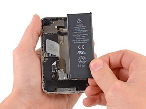

Why do I have to remove the battery for disassembling the rear camera? Any idea?
Andreas Suck - Reply

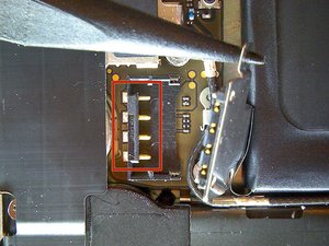

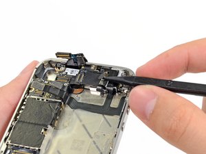

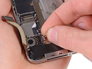

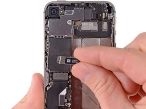

Image 1/3: When reinstalling the pressure contact, be sure to clean it with a degreaser such as windex or isopropyl alcohol. The oils on your fingers have the potential to create wireless interference. Image 2/3: Take notice of the position of the small black ground clip on the upper screw of the battery connector. This clip is attached only by the upper screw. When reinstalling, it must be aligned so the gold contact point will press against the back cover. Image 3/3: Be careful not to rip off the battery connector socket soldered on the logic board. There are 4 very small soldering points awaiting this mistake!
  • Use a plastic opening tool to pull the pressure contact from underneath the battery connector.
  • When reinstalling the pressure contact, be sure to clean it with a degreaser such as windex or isopropyl alcohol. The oils on your fingers have the potential to create wireless interference.
  • Take notice of the position of the small black ground clip on the upper screw of the battery connector. This clip is attached only by the upper screw. When reinstalling, it must be aligned so the gold contact point will press against the back cover.
  • Be careful not to rip off the battery connector socket soldered on the logic board. There are 4 very small soldering points awaiting this mistake!
If I did accidentally remove the pressure contact point from the logic board...what do I do?
Samuel Z - Reply
I also did this. Not sure what its for? My phone appears to be fine now without it.
Ian Booth -
This picture needs to be greatly enlarged! The pressure plate sits directly underneath the battery connector, but cannot be seen here. It is also flat but about half the size of the battery connector, so you won't know you've ripped it up until you have! Picture two slices of bread but not the same size, stuck together.
S Byers - Reply
What if you pop off that pressure contact point?? What is its function? Is it impossible to re-attach?
Ian Booth - Reply
No idea what exactly this step means. I just pulled the battery connector without trying to move the pressure contact. Installed new battery, plugged in connector and aligned the pressure contact slightly for the screw to fit.
Got a big scare as the phone would not connect to the cell network at first boot, only WiFi. Shut it off and when it rebooted it seemed to work. WIll probably know in a day or so if everything works fine or if there are interference issues, etc.
andries - Reply
This is normal ... removing the battery resets internal clock to start value and your provider doesn't accept that, hence no network.
Going online through wifi or manually setting date right corrects this after a reboot.
Dreetn -
I also accidentally removed the pressure contact. I put it back in place as best I could during reassembly and so far haven't ran into any problems.

The black ground contact needs still more "flagging." This is a simple metal strip that is attached ONLY by the 1.5mm (upper) screw. It will help if you look at it before you remove the upper screw. Notice the gold contact arm and point. That contact point must be in a plane above every other surface inside the device when you replace the battery connector, because it makes a ground contact with the metallic inner surface of the device back plate.
When I replaced it, I used the Pentalobe driver to line up battery connector and ground contact with the screw socket post. I then attached the 1.7mm (lower) screw loosely, removed the Pentalobe driver gently, and inserted the 1.5mm (upper) screw into the assembly. There is a tab on the ground contact that helps it align properly once pressure begins to applied. I completed driving the upper screw, pressing lightly with the spudger on the battery connector plate to make sure it was seated on the pressure contacts. Finally, I completed driving the lower screw.
Matt McCaffrey - Reply
This is a hard step because the directions and pictures are not very clear. This might help:
1) Here you HAVE TO disconnect the battery connecter (the language is confusing).
2) This is easier than it looks, as you can simply lift the connector upwards from any angle (I rested my plastic tool on the antenna and gently lifted it up).
The photo suggests you have to pull the connector backwards (which would be hard), this is not true, it can be lifted up towards you (the pins go out backwards and upwards, you'll see).
Finally, don't confuse the "pressure contact" with the "pressure contact point". You remove the contact, the contact point (underneath) sits on the board. No need to worry about this.

Image 1/2: Run the plastic opening tool along the right edge of the battery and pry up at several points to completely separate it from the adhesive securing it to the outer case. Image 2/2: Run the plastic opening tool along the right edge of the battery and pry up at several points to completely separate it from the adhesive securing it to the outer case.
  • Insert the edge of a plastic opening tool between the battery and the outer case near the bottom of the iPhone.
  • Run the plastic opening tool along the right edge of the battery and pry up at several points to completely separate it from the adhesive securing it to the outer case.
This can be very tricky because sometimes theres just too many glue on the back of the battery, and eventually the battery will be deformed.
Carlos Lopes - Reply
Yes, there did seem to be a lot of glue holding my battery in. At first I was afraid of breaking it, but after reading up on the subject I've learned that it is okay if the battery gets a little deformed. Due to the nature of the battery it will still work if slightly deformed.
djlogic26 - Reply
I found the plastic pull tab to be useless. Peeled pretty much the whole battery out from the left side. Used a probe to "break" a few strands of glue to help. Just watch the connector and ribbon cable in the lower left corner as you pry up so you don't crimp them or damage them.
gregsrow - Reply
DO NOT remove the battery unless absolutely necessary. If the battery is removed from the phone, DO NOT reuse it, ifixit does not seem to understand the importance of safely handling the battery
Tom Chai - Reply
Tom you have never been so wrong. Removing the battery is the FIRST step ANYONE should do before repairing or attempting repairs on their phone. The iPhone has many different grounding points in the phone and having electrical current running to it poses a massive risk, especially with ESD (ElectroStatic Discharge). People, PLEASE make sure you remove your phone's battery FIRST before doing any repairs. Use a plastic, not metal, spudger, after unhooking the battery from the logic board, place the spudger along the right side of the battery NOT under the volume buttons, about an inch and a half lower (two roughly if a sim card is present) and start prying it up using the frame as the fulcrum, as you start to lift the battery from the adhesive make sure you slide the spudger farther under to get even contact so you do not damage the battery.
Prestige Computer Solutions -
Try a used plastic credit/gift card to apply gentle pressure to lift the battery out of the phone, the short edge of the card fits within the gap on the logic board side between the battery and video cables. You can also use it on the opposite side if there is room between the battery and iPhone frame. This has worked on all of the 4 and 4s models I've replaced screens on.
I offer an alternative image if interested.
Wallace Karraker - Reply
Hello! My clients iphone 4s:n battery connector broke, when i tried accidentally take the battery out with a plastic tool from the wrong side.
Connector detached completely, so that the two middle ironcensors came with it and was stuck to the connector. When i screw the whole connector back to phone, it works with battery power, but the batterys downloading doesnt work. Are these two middle censors that are stuck in the connector exactly the ones that should be charging the battery? Do you know how i can fix this? I have already bought electrical conductor glue, but should the parts be cleaned somehow first? And how can i fix it, when the center metal sensors on the system board is also attached to the battery?
How can i clean out thiskind of part with windex? I have purchased almost all of the possible tools from iFixit and the electrical conductor glue i bought somewhere else. (http://www.ebay.com/itm/300915727408?ssP...)
SebastianK - Reply
Removing the battery wasn't necessary. I attempted the removal but decided not to in the end. It didn't get in the way at all.
BigFatCat - Reply
i also skipped the battery removal step. the battery didn't get in the way, but it did make it difficult to see if the wifi grounding fingers (step 14) were underneath the case lip. everything worked in the end though so i don't think removing the battery is a strict requirement.
rippergirl - Reply
How can you not remove the battery in a battery replacement fix? Step 14, there are only 7 steps. Me thinks these comments are getting mixed up between different fixes!
bluezzer -
I did not remove the battery to do a Speaker replacement and had no issues with getting the Speaker out/in. So, steps 4 and 5 are required but not step 6.
rcrodriguez2 - Reply
The plastic tab is not attached to the battery. I just pried from the right and slid tools under until I broke all the adhesive.
DMcG - Reply
I found it easier to start by pulling the plastic lip to loosen the battery, then, if needed, use the plastic tool to pry from the side.
superedu111 - Reply
I tried to get the battery out as depicted in the first picture. It deformed and is now broken. Not happy. It seems better to leave it or get it out by gently pulling the tab.
Paul Baars - Reply
Please, Please, PLEASE avoid using probing elements to try remove batteries. I have had dozens handed in to me with punctures and two that actually started smoking due to people trying to prise the battery out. DO NOT DO IT.
The best way I have found to remove the battery is this process;
1) Try remove it with the pull tab directly, some will come out, some will not. Do NOT use excessive pull force else it'll deform the battery and reduce the capacity.
2) If the pull test didn't work, then get a hot air gun on medium and warm up the area around the battery for about 30 seconds, focusing on the perimeter of the battery. If you see ANY popcorn'ing then you're too hot, you don't want to cook the battery.
2.1) Wait about 30 seconds for the heat to now wick underneath the battery to soften the adhesive.
2.2) Now try pull the battery up, the extra heat should have softened the glue that you can remove the battery without excessive force and without sticking objects under the battery.
Paul L Daniels - Reply
Image 1/2: Be careful not to pull the plastic pull tab too hard as it can be ripped off very easily. Image 2/2: Remove the battery.
  • Use the exposed clear plastic pull tab to peel the battery off the adhesive securing it to the iPhone.
  • Be careful not to pull the plastic pull tab too hard as it can be ripped off very easily.
  • Remove the battery.
  • Perform a hard reset after reassembly. This can prevent several issues and simplify troubleshooting.
Be VERY careful NOT to pull off the part of the connector that is on the logic board! Mine now has only contact but no solder until I can get a small enough soldering iron and a less shaky pair of hands!
Rob Hendricks - Reply

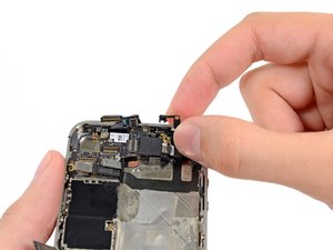

Image 1/1:
  • Use the edge of a plastic opening tool to pry the dock cable up from its socket on the logic board.
Image 1/1:
  • Peel the dock connector cable off the adhesive securing it to the logic board and the side of the speaker enclosure.
Image 1/2: De-route the cellular antenna cable out from under the metal fingers attached to the logic board. Image 2/2: De-route the cellular antenna cable out from under the metal fingers attached to the logic board.
  • Use the edge of a plastic opening tool to pry the cellular antenna cable up from its socket on the logic board.
  • De-route the cellular antenna cable out from under the metal fingers attached to the logic board.
Ok, I did all the steps and phone seems to be OK, wifi is actually working again, yaaay.
But cellular connection is messed up. It will have full reception (5 pins) for about 10 seconds, then drop to 1 pin for a couple seconds, then go into "searching" mode. After a few seconds in "searching" mode it will go back to full reception and the process repeats itself in a timely fashion, over and over again. Obviously I messed up somewhere but where? Which connections are faulty/beyond repair?
Colorblend - Reply
I dismantled the phone again and concluded that the digitizer cable was kind of loose (don't know if that affected anything, but i put it down firmly this time). I had 2 problems, the cellular connection I mentioned plus the phone would charge to 3 percent, die, and then repeat the procedure. What I did was I took out the battery, the tin plate above the cables, and lifted the dock connector. So I did not redo that much. I cleaned all contact surfaces as I had been told but chose to not do before.... I also took out the grounding clip by the battery connectors and bent it upwards quite a bit while also peeling away 2 mm of the black insulation material on the back of the phone to make sure the grounding clip connects well to the back of the phone. I also cleaned that surface with window cleaner, which is basically isoprypol alcohol as has been recommended. The cellular antenna connector I pushed down firmly to make sure it was connected, I was gentler the first time, now everything works.
Colorblend - Reply
Note that the antenna cable goes around the the right side of that little guiding hook/finger. On the photo it shows the cable on the left of it. The hook is almost right below the socket.
jasperm - Reply
Image 1/1: You can use tweezers, a plastic opening tool, or a spudger to remove the outer plastic ring.
  • Be wary of the outer plastic ring located on top of the rear camera's flash assembly. It can be easily displaced if not removed during disassembly.
  • You can use tweezers, a plastic opening tool, or a spudger to remove the outer plastic ring.
Sometimes found stuck to the inside of the back cover.
Jeremy Jones - Reply
Don't do it!!! you can skip that, it will stay and its more of a pain to remove it.
Nic Harper - Reply
This is unnecessary step!! Don't do that!!
javamonk - Reply
Agreed, mine was stuck inside of the back cover
fidelvila - Reply
So was mine - thanks for telling! Rests of soft glue could be scratched off the place - so the ring was already off and I looked for it everywhere.
Ida - Reply
Mine was stuck to the cover too, thanks for posting.
davisyang - Reply
Image 1/1: One 2.7 mm Phillips screw
  • Remove the following four screws securing the cable cover to the logic board:
    • One 2.7 mm Phillips screw
    • One 2.6 mm Phillips screw
    • One 1.3 mm Phillips screw
    • One 1.2 mm Phillips screw
On reassembly, note that the metal lip below the (red) 2.7mm screw and to the right of the (green) 1.2mm screw goes between the ribbon cable and the main logic board, as can be seen in the picture for Step 12. If you don't get this right, the 2.7mm screw is difficult and, worse, there's a risk the edge of the lip will tear the ribbon cable.
David Bruce - Reply
I had challenges here. As noted, the metal lip below the (red) 2.7mm screw and to the right of the (green) 1.2mm screw goes between the ribbon cable and the main logic board. That lip points away from you, towards the screen, THEN BENDS UP towards the power button. You need to pull the metal shield down a little (which stresses the ribbon cable) to get the hook-shaped feature free.
griffn -
The fastening on the board came loose when trying to remove screw the 1.2 mm Phillips screw. So the screw hole for that screw is still attached to the cover that I removed.
Aasmund Gravem - Reply
Got to step 13 and could not remove the 1.3mm screw (yellow circle), even using a different Phillips head screwdriver than the one that came with the kit. So frustrating. Was able to remove the other screws leading up to this point without difficulty (used the saran wrap trick on the other screws to prevent stripping, but this 1.3mm screw just would not budge).
Ended up abandoning the screen replacement--luckily the phone works after putting it back together.
Gayle - Reply
In my case, the 1.3 screw (yellow) wouldn't tighten on reassembly. I might have tightened too much so that it stripped the screw hole. Anyone know whether this has damaged the board in some way. The phone works fine, but concerned about the long run.
Casltech - Reply

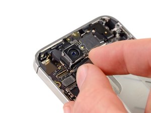

Image 1/2: Be careful not to break any components off the surrounding area on the logic board as you pry upwards. Image 2/2: Remove the rear camera from the iPhone.
  • Use the edge of a plastic opening tool to pry the rear camera connector up from its socket on the logic board.
  • Be careful not to break any components off the surrounding area on the logic board as you pry upwards.
  • Remove the rear camera from the iPhone.
  • There is a small rubber gasket that sits underneath the rear-facing camera. Make sure that it is properly seated before reassembly.
Im pretty sure that when you reinsert the cam the grounding clip has go to between metal sticker and the cam body, or the camra wont be grounded
Michael Rygaard - Reply
I've got a trouble at this step. Is there anybody who could help me out with my problem? When I was removing the camera module, accidently removed small element, which is marked with the red line http://i63.fastpic.ru/big/2014/1022/4e/9...
As I figured out - that is the SMD capacitor. After that Iphone was switched on, and it seems to be working fine at the moment, but I am very scared, if it will continue to work well without that small piece. Anybody to help?
soubi8 - Reply
In my case, the grounding clip was taped to the camera! In addition, my repair process stopped at this step as the left screw on the power button had come out and was floating around next to the camera slightly stuck to the tape. This was lucky since a loose screw in an iPhone under the logic board would be a bad omen.
Michael Scollay - Reply
Image 1/2: This may require a significant amount of force. Image 2/2: Remove the SIM card and its holder.
  • Use a SIM card eject tool or a paperclip to eject the SIM card and its holder.

  • Remove the SIM card and its holder.
I have an Iphone 4 but the inerds look more like this 4S than the 4, except I do not have a SIM card port. What's up?
Dave - Reply
Probably a CDMA (Verizon) iPhone 4.
Pepper -
Is there a reason for waiting until step 18 to remove the sim card and its holder? I can do it right before I start without much force, is this not better?
jmaelzer - Reply
I don't see any reason. So it was my step 1 to remove the SIM card.
Ida -
I agree that the SIM card should be removed before you even start. After I completed this repair (waiting until this step to remove the SIM), the SIM card and holders won't go flush with the side of the phone anymore. The phone still works and everything else is fine, it's just annoying that I have a SIM holder sticking out about 1mm. I'm not certain this step caused this, but I'm just letting folks know that I agree with jmaelzer.
Song - Reply
for the life of me I can NOT get this sim card and holder out!
Lori - Reply
To be honest, it's really hard to remove SIM card without a correct tool.
Beck Sisyphus - Reply
You have to PUSH the paperclip IN, then the tray pops OUT.
Floris Jansen - Reply
I agree. Push in.
ivesrubl -
ifixit needs to edit this: "significant force" is NOT needed! I started to bend out the hole until I read the last post- just push the tool straight in, the SIM card will eject easily.
soopamandan - Reply

  • Remove the five cables near the top of the logic board in the following order:
    • Headphone jack/volume button cable
    • Front facing camera cable
    • Digitizer cable
    • Display data cable
    • Power button cable (located underneath the headphone jack/volume button cable as shown in the second picture.)
  • To disconnect the cables, use the edge of a plastic opening tool to gently lift their connectors up and out of the sockets on the logic board.
  • Be careful not to break any of the small and delicate surface mount components as you disconnect the cables.
There is an additional cable that you have to disconnect that's under the headphone jack cable. You have to do this before you try to remove the logic board. Otherwise, you'll rip that cable.. and I just freaking did.
Dennis - Reply
The digitizer cable won't reach! I've already ripped it off once. which disconnect are you talking about?
kct16k -
I just ripped off the power cable ... i can live without the power button though!
Oreste Attanasio - Reply
is that sarcasm or is there really a way to turn on the phone without the power button?
Sharn de Wet -
The only way to turn on an iPhone without a power button is to plug it in to power. If it was shut down while connected to a sync cable then disconnect and reconnect for it to turn on.
ben0509 -
I just broke off the power button as well because I forgot to disconnect the cable. Thank goodness for chargers and assistive touch!
grilledsoap -
Need to remove the shield over the connectors first. Look at the other guides for the 4S they show the 4 screws and how to lift the shield out, take out the camera etc.
Paul - Reply
During reassembly, I noticed that the data display cable is rather stiff. It may be a bit tricky to get it reconnected, but you'll know once it's in.
bsporer3 - Reply
That power cable connector is very delicate. I managed to tear it just a tiny bit in the curve of the cable too. So I’ve got another part on order now. Apart from that the screen replacement went great ;) I’m not sure at which step the tear actually happened, it might have been during re-assembly when I was trying to get all these cables to stay on top of rather than go behind the motherboard. Realizing how easy that is to tear and keeping that in mind as you do this is important.
james - Reply
I ripped the power button cable(didn't see it), any chance it could be outlined with a dotted color in the future? (I'm bad at reading the warnings)

Image 1/1:
  • Use the edge of a plastic opening tool to disconnect the Wi-Fi antenna from the logic board.
Great Guide and thanks. Now...what if i snapped the wifi antenna cable together with its male connector from the board? Like tearing it apart ? Can this be replaced by any chance? Thanks!
spyrosandreou - Reply
I also had a problem with the connector breaking off, but after putting everything together, the WiFi seems to work like before, so I guess there is no problem there...
Dirk Blom - Reply
Ok so no fret here if you accidentally pull off the metal insert placed on top of the actual antenna. This step needs to be rewritten imo, the deal here is that there is an actual 'socket' looking deal underneath here that you need to lift up. There is a metal tab semi'glued' to that part of the antenna and it does come off easily, however all you need to do is press them back together to get them back, I believe it to be a range 'extender' of sorts.
So your looking to actually lift up what looks a lot like a ribbon cable as well in this step. YOU SHOULD NOT HAVE A PIECE REMOVED IN THIS STEP, it's still in the case at this point.
Ben - Reply
I have connected my wifi antenna to the phone but when my phone switches on the wifi button is a grey colour and won't let me turn it on, help?
melissamerin -
Image 1/2: Remove the 2.6 mm Phillips screw securing the logic board near the power button. Image 2/2: (Use caution when removing this screw and removing the power contact held by it; the contact tab will come loose with the screw)
  • If present, peel the piece of black tape covering the hidden screw near the power button.
  • Remove the 2.6 mm Phillips screw securing the logic board near the power button.
    • (Use caution when removing this screw and removing the power contact held by it; the contact tab will come loose with the screw)
  • Notice the small rubber bumper under the screen & digitizer cables (which are detached at top above the Q-code). This bumper can fall off of the logic board when removed or get stuck to the cables and fall off later.
Dimension given are Length of screw. I think it meant to say 2.6mm screw.
Jon - Reply
Note that there is a rubber insulator that is loosely attached to the PBC that can be seen in the upper right corner of the red outline near the tag with Q5M on it. It falls off after the logic board is removed and should be replaced before reassembly.
ghodges - Reply
where the heck does it go back on the logic board?! It fell off during removal and I cant seem to locate it in the pictures. :(
Shaun Brown -
As noted: Put the bumper back right above the white bar code label. The label says Q5M on the far right side. The bumper goes on the edge of the board to protect the ribbon cables that bend over the board.
griffn -
So, my 2.6 Philips screw near the power cable just spins and spins. It happened the first time, so I know I didn't strip it. Any ideas?
thebacks - Reply
So, I couldn't gind the tape and instead of digging around. I did what no one should do. I twisted and pulled. So now the screw that holds the upper left corner on broke that part of the logic board off. Everything else went back great....Phone won't turn on. Am I screwed here?
cdays01 - Reply
step 13 - “One 1.3 mm Phillips screw”
step -22 “Notice the small rubber bumper under the screen & digitizer cables (which are detached at top above the Q-code)”
“Note that there is a rubber insulator that is loosely attached to the PBC that can be seen in the upper right corner of the red outline near the tag with Q5M on it”
now, the problem :-)
while assembly the iPhone I screw by mistake the 2.6 mm instead of the 1.3, and without noticing I break the 1.3 base screw from the motherboard :-/
Now, the rear camera is not working.
I couldn't figure in the picture above, if the rubber bumper you mean, is under that screw or above the Q5M tag ?
Can it be that the dewar camera don’t work because of that broken screw?
Any idea how to fix it?
Is there any option to buy the rubber bumper, if I lost it ?
Appreciate any help,
thanks!!
Simon - Reply
Under the screw is a ground clip from step 25. I tweezed it out here since it might bounce free while pulling logic board out. Use a big white towel as a work surface to prevent wayward bouncing bits from flying off the table.
griffn - Reply
Caution: the image with the QR code is "mirrored" --> look at it "reversed" !
jacquesfforster - Reply

Image 1/1: Remove the logic board.
  • Carefully lift the logic board from the end closest to the speaker enclosure and slide it away from the top edge of the iPhone.
  • Remove the logic board.
  • Before reassembly, be sure to clean all metal-to-metal contact points on the logic board (not the mating halves of connectors) with a de-greaser such as windex or isopropyl alcohol. The oils on your fingers have the potential to cause grounding issues.
  • There is a small rubber bumper that sits on the top edge of the logic board where the digitizer and screen cables come through the case. It protects the cables as they bend over the top of the logic board. This can either get stuck to the cables or fall off the logic board when it comes out. Look back over step 22 for more details.
After I had lifted the logic board and moved around a little a small rubber piece fell off. Approx. 1 cm long and 2 mm wide. I'm guessing it's for some sort of isolation between the board and the chassis. Where should it go when I reassemble the phone?
The piece I'm referring to can be seen on the table in the upper right corner in this video: http://www.youtube.com/watch?v=IVQtgD89e...
Simon Fransson - Reply
It sits between the logic board top-edge and the two ribbon leads from the screen. Its purpose is to stop the PCB cutting in to the FPC leads over time due to vibrations. If you require I can send a photo.
Paul L Daniels -
hey, i removed the logic board and gave it a bit isopropanol spray. is this ok? how can i found out if it is working? is it possible to remove something from the logic board? thank you :)
bne - Reply
On reassembly, make sure you lift up the power button cable before installing circuit board. I thought I had all of the cables lifted until after getting to step 17 (in reverse) only to find out power cable was under the circuit board. Added 15 minutes to my process.
juanocasio - Reply
I had a similar problem as I was back tracking steps to perform something I missed and actually broken the power and sensor cable (the one that is connected to the digital board first during re-installation. A secondary order and another 20 minutes took care of it. Glad you were able to not hit that barrier.
mattwilber -
On reassembly, you are putting the plate under the spaghetti. I went back a few times to get all the cables out. Here is a check list before you tighten any logic board screws or try to jam the top edge of the board in place:
Counter clockwise from upper right near power button:
- Wi-Fi Cable from step 21
- 5 cables near the camera from step 17.The ‘blue’ power cable underneath loves to hide. The ‘orange’ front facing camera cable can get kinked under the board during re-install (no more selfies on this phone).
- Dock cable from step 9
- Cell Antenna from step 11
Go slow. Look twice.
griffn - Reply
Image 1/1:
  • Be sure not to lose the small grounding finger for the rear facing camera near the power button. This finger rests on top of the PCB, screwed down, and covered with the adhesive black plastic tape.
if I LOSE it, what will happen?
Actually, i DID lose it.
XuKaimeng - Reply
Hi. This little clip is responsible for the image stabilization on the 4S. When the iPhone 4S was launched, one of the things that were different from iPhone 4 was Image Stabilization, specially when the user was filming. This clip holds the camera module in place while the phone is shaking in the hands of the user. Pretty high tech :D
Pedro de Almeida Silva Chaves -
Apparently it had uncovered my iPhone before, because when I did not find this piece uncapped here. I need to know which function is on the iPhone and if it is very important. How could I get?
Raul Tejada - Reply
Hi, I had the phone apart to replace the wifi chip.
Has anyone found a source for the two nano sized SMD resistors, because this also causes "no wifi" syndrome due to them being important for the I2C lines.
thanks!!! -A email testing_h "at " yahoo.com
Andre De Guerin - Reply
I think this is one of the parts I didn't put back in... Does it affect anything?
Also, Took apart my iPhone 4S to fix the screen and battery... Now the camera light doesn't turn on and I'm left with two pieces. Help!
Here are the parts: http://imgur.com/DsYtdlR
Nicole - Reply
Left part: See step 5 - "Take notice of the small black ground clip on the upper screw of the battery connector".
Right part: See step 25 - "Be sure not to lose the small grounding finger for the rear facing camera near the power button".
Simon Fransson -
I removed this in step 22 even though it only slightly alluded to it. If you did, too, don't panic. Go find your step 22 parts and verify it is there. :)
christopherjwells - Reply
What are the consequences of losing the 'small grounding finger for the rear view camera'?
3chris3rivers3 - Reply
I did it. No problems!!!
I used a Tupperware orange peeler as a plastic opening tool and didn't touched any screws oder other inner parts.
I had to do it two times, because my old 4S 64GB has a broken WLAN Chip on the logic board, and my wifes 4S has broken her display glass. So I took her logic board into my 4S body. Now we have one running iPhone 4S 64GB instead of two broken phones.
HaJo - Reply
HELP! Miy clip does look different, and i have no idea how to fit it in
slipknot660 - Reply
This little piece was missing when I opened my phone, seems it was lost last time I sent it to the repair shop for screen replacement.. :-( but it does take pictures
Jose Fernandez - Reply
