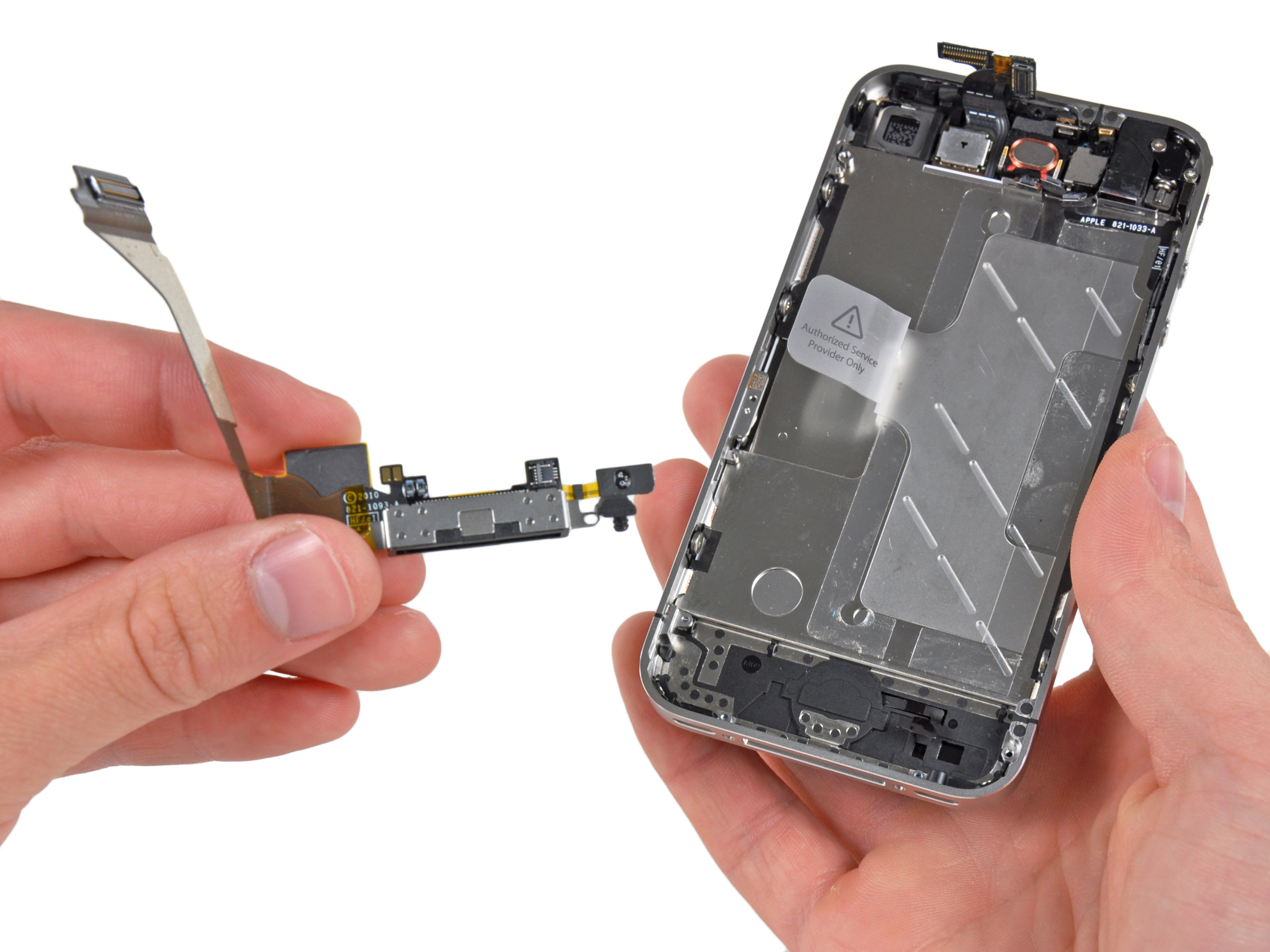

  19. iPhone 4 Dock Connector Replacement: step 19, image 1 of 1
    • Slide the rubber cover off the microphone attached to the old dock connector and transfer it to your new dock connector.
    • The ribbon is very fragile and can easily be torn when placing the rubber cover onto your new part.
    • If your microphone does not work after replacing your dock connector, the issue may be that the rubber cover is not positioned properly on the mic cable.

I had two different little pieces of plastic on my replacement on the mic that I needed to peel off. You may have left some on. Not the easiest to check, but a possibility.
