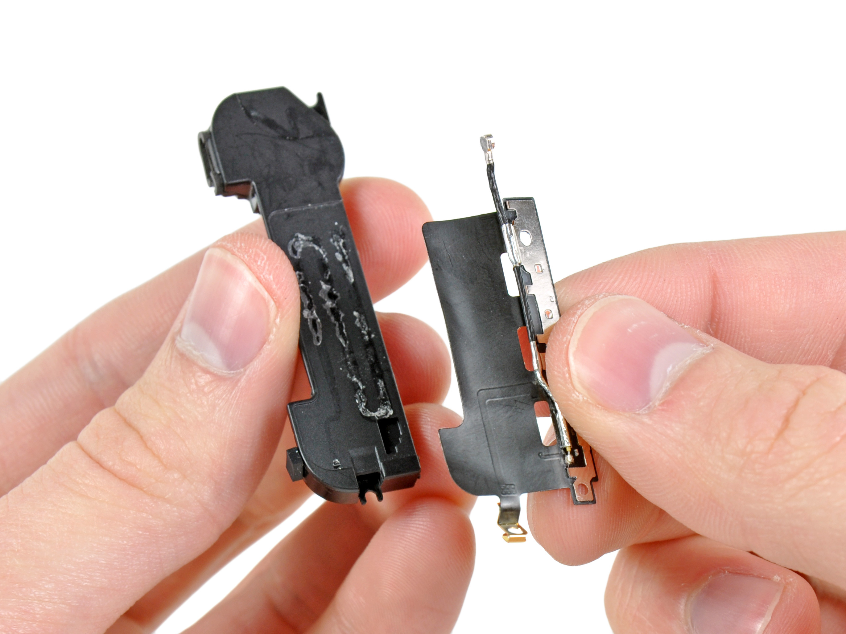

  14. iPhone 4 Cellular Antenna Replacement: step 14, image 1 of 3 iPhone 4 Cellular Antenna Replacement: step 14, image 2 of 3 iPhone 4 Cellular Antenna Replacement: step 14, image 3 of 3
    • Starting near the cellular antenna cable, use the edge of a plastic opening tool to peel the antenna off the speaker enclosure. Make sure you insert the plastic opening tool under the plastic the antenna is mounted on, not the metal plate.
    • Continue peeling the cellular antenna off the speaker enclosure, being careful not to rip the gold bracket attached to one of its edges.
    • Remove the cellular antenna.
    • When installing a new cellular antenna, be sure to slide the gold bracket over the ear molded into the speaker enclosure before sticking the antenna down.
