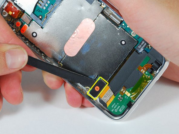

  9. iPhone 3GS Dock Connector Replacement: step 9, image 1 of 1
    • Use a spudger to disconnect the ribbon cable labeled "4."

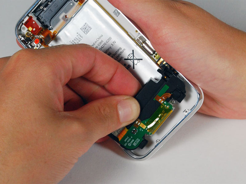

  18. iPhone 3GS Dock Connector Replacement: step 18, image 1 of 1
    • Lift the dock connector assembly up and out of the iPhone.
    • When inserting the new assembly, ensure the screw holes of the assembly rest ABOVE the bezel's holes.

When replacing the connector you will have to desolder 4 small solder points, 2 per ribbon cable. They are easily desoldered by gently pressing the soldering iron tip to the top of the cable and gently peeling it away.
They can they be resoldered onto the new connector.
The solder points can be seen in step 16 just above the two 1.5mm screws.
