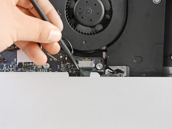

  10. Installing iMac Intel 27" EMC 2429 Dual Drive Kit (HDD or SSD): step 10, image 1 of 2 Installing iMac Intel 27" EMC 2429 Dual Drive Kit (HDD or SSD): step 10, image 2 of 2
    • Pull the black tab straight up to disconnect the latch on the display data cable ZIF connector.
    • Do not pull up too hard or you will damage the connector and socket.
    • Continue to pull the black tab up toward the top of the device, to detach the display data cable.

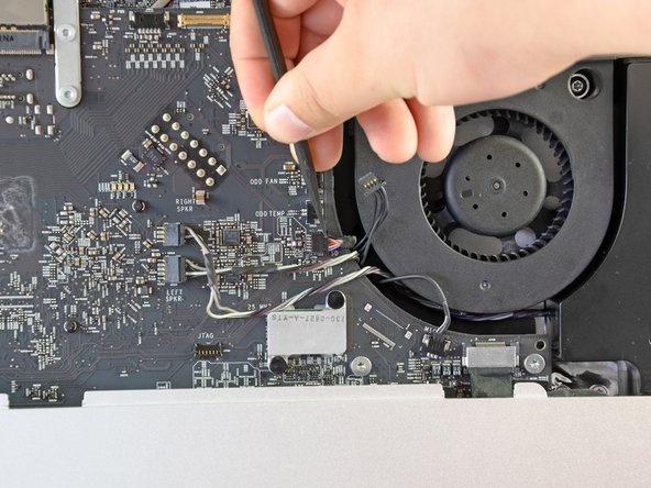

  14. Installing iMac Intel 27" EMC 2429 Dual Drive Kit (HDD or SSD), Optical Drive: step 14, image 1 of 1
    • Use the flat end of a spudger to pull the optical drive data cable out of the optical drive.
  15. Installing iMac Intel 27" EMC 2429 Dual Drive Kit (HDD or SSD): step 15, image 1 of 1
    • Use the tip of a spudger to pull the optical drive thermal sensor connector out of its socket.

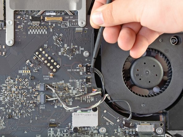

  18. Installing iMac Intel 27" EMC 2429 Dual Drive Kit (HDD or SSD), Dual Drive Kit: step 18, image 1 of 1
    • Use the flat end of a spudger to pull the optical drive fan connector out of its socket.

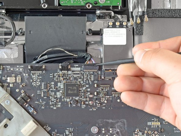

    • Use the tip of a spudger to pull the SD board data cable connector out of its socket.
  20. Installing iMac Intel 27" EMC 2429 Dual Drive Kit (HDD or SSD): step 20, image 1 of 1
    • Use the flat end of a spudger to push the I/O cable connector out of its socket.
    • Alternate pushing on the tabs on the side of the connector to "walk" the connector out of its socket.

  22. Installing iMac Intel 27" EMC 2429 Dual Drive Kit (HDD or SSD): step 22, image 1 of 2 Installing iMac Intel 27" EMC 2429 Dual Drive Kit (HDD or SSD): step 22, image 2 of 2

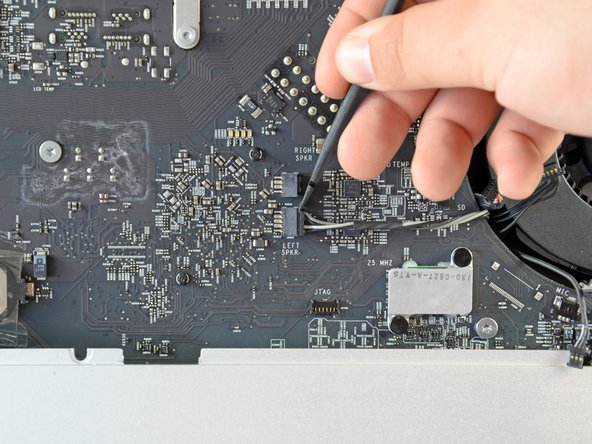

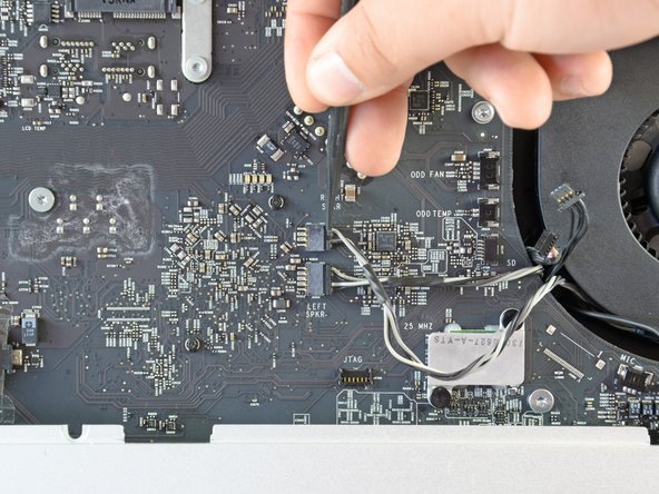

    • Release the right and left speaker connectors from their sockets using the flat end of a spudger.

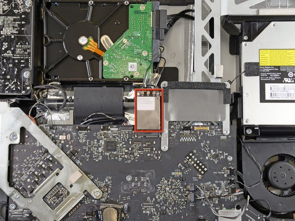

  23. Installing iMac Intel 27" EMC 2429 Dual Drive Kit (HDD or SSD): step 23, image 1 of 2 Installing iMac Intel 27" EMC 2429 Dual Drive Kit (HDD or SSD): step 23, image 2 of 2

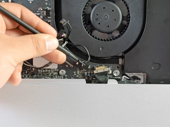

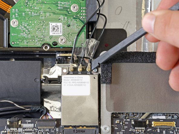

    • Locate the AirPort card at the top center of the logic board and just below the hard drive.
    • Use the flat end of a spudger to gently pry each of the antenna cables off their sockets.
    • Do not disconnect the antennas by pulling on the cables as this may damage the cables, connectors, or sockets.
    • The antennas have markings to help you identify their order. The antenna with no marks goes to "CH0", the antenna with one mark goes to "CH1", and the antenna with two marks goes to "CH2".

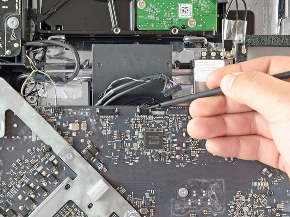

  24. Installing iMac Intel 27" EMC 2429 Dual Drive Kit (HDD or SSD): step 24, image 1 of 1
    • Use the flat edge of a spudger to push the camera/Bluetooth/ambient light sensor connector out of its socket.

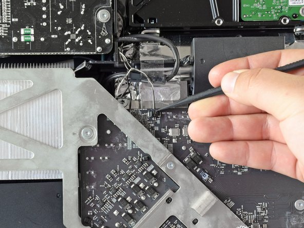

    • Release the hard drive fan connector from its socket by pushing on its tabs using the flat end of a spudger.
  26. Installing iMac Intel 27" EMC 2429 Dual Drive Kit (HDD or SSD): step 26, image 1 of 1
    • Push the thermal sensor connector out of its socket with the flat end of a spudger.
  27. Installing iMac Intel 27" EMC 2429 Dual Drive Kit (HDD or SSD): step 27, image 1 of 1

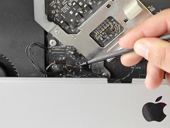

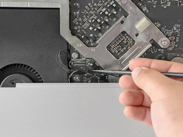

    • Use the flat edge of a spudger to release the CPU fan cable
  28. Installing iMac Intel 27" EMC 2429 Dual Drive Kit (HDD or SSD): step 28, image 1 of 1
    • Use the flat end of the spudger to push the ambient temperature sensor connector out of its socket.

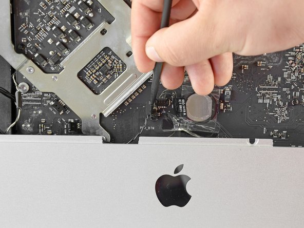

  29. Installing iMac Intel 27" EMC 2429 Dual Drive Kit (HDD or SSD): step 29, image 1 of 1

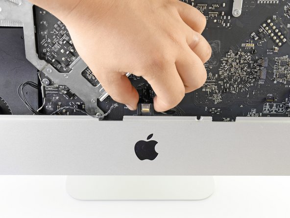

    • Use the flat edge of a spudger to pull the power button connector free of its socket.

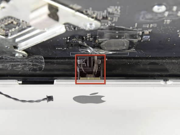

    • Locate the IR sensor located behind the black Apple logo.
    • If necessary, peel back the tape covering the IR sensor.
    • Detach the IR sensor by pulling it straight up and out from the case.
    • Do not attempt to completely remove the IR sensor from the iMac as it is still attached to the logic board.

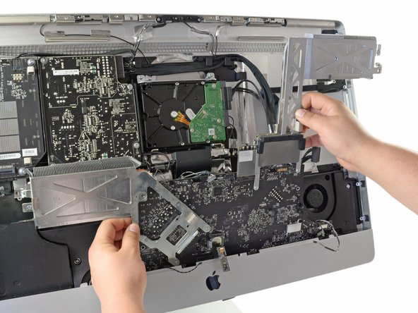

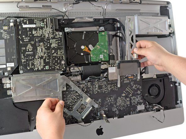

  31. Installing iMac Intel 27" EMC 2429 Dual Drive Kit (HDD or SSD): step 31, image 1 of 1

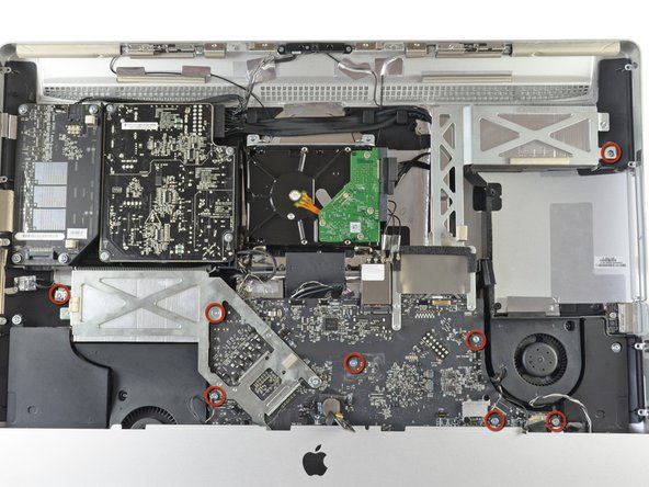

    • Remove the eight T10 Torx screws securing the logic board and heat sink assembly to the iMac case.
  32. Installing iMac Intel 27" EMC 2429 Dual Drive Kit (HDD or SSD): step 32, image 1 of 2 Installing iMac Intel 27" EMC 2429 Dual Drive Kit (HDD or SSD): step 32, image 2 of 2
    • Simultaneously lift and rotate the logic board and heat sink assembly away from the iMac case until you can easily access the back side of the logic board.

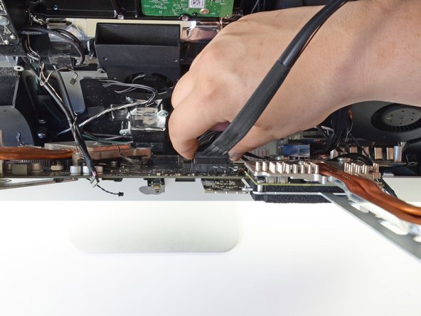

  33. Installing iMac Intel 27" EMC 2429 Dual Drive Kit (HDD or SSD): step 33, image 1 of 2 Installing iMac Intel 27" EMC 2429 Dual Drive Kit (HDD or SSD): step 33, image 2 of 2
    • Locate the secondary SATA socket, next to the primary SATA socket.
    • Plug in the included SATA data/power cable.
    • The hard drive cable side with only one connector goes into the logic board connector.

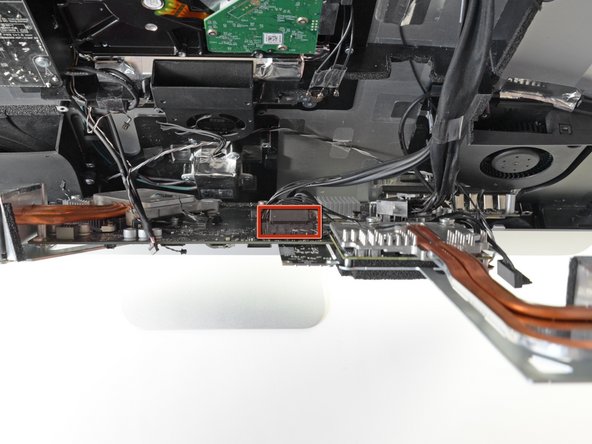

  34. Installing iMac Intel 27" EMC 2429 Dual Drive Kit (HDD or SSD): step 34, image 1 of 2 Installing iMac Intel 27" EMC 2429 Dual Drive Kit (HDD or SSD): step 34, image 2 of 2
    • Route the new SATA cable through the indentation that the primary SATA cable goes through and into the optical drive bay.
    • Not all of the 27” iMacs (2011) have the channel in the optical drive wall to route SSD cabling. If you have one of these iMacs, you can simply route the cables under the optical drive.
    • Set the logic board back into place, being careful not to catch, cover, or pinch any cables.
    • Be sure that the SATA cable has as much slack as possible and that it is not tangled with any other cables.
    • Make sure the cables are not stacked on top of each other; they have to lay as flat as possible

in step 22 you can see the wifi cables are not connected anymore. but there is no step that shows you should disconnect them
R Sonnema - Reply
+1 Unfortunately mine has been broken (CH1 cable is out from the UFL connector). Unfortunately I do not now how to repair it.
It would be important to add this step in order to protect others falling into the same issue.
