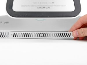

Lay your iMac face-down on a soft, clean surface as shown.
Loosen the three Phillips screws securing the access door to the bottom edge of your iMac.
Remove the access door.

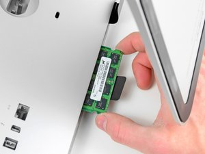

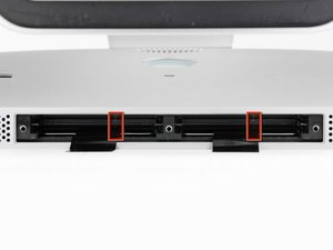

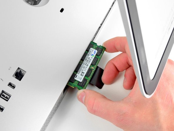

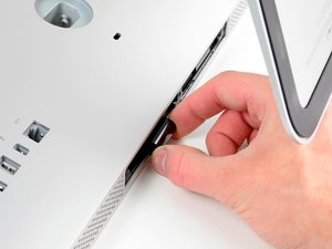

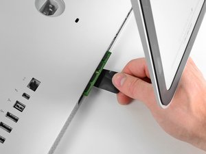

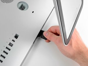

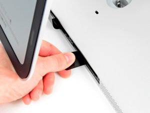

Gently slide the black plastic RAM pull tab out from the RAM slot.
Pull the black plastic tab away from the bottom edge of the iMac to eject the module(s) on that side of the RAM bay.
i pulled very hard on this tab, could not get it to release?
is this common?
It is far harder than I thought you have to pull REALLY hard and then there will be a little click and than you can gently pull out the RAM.
Slide the old RAM module(s) out of their slots in the RAM bay and set them aside.
Repeat the process in the previous steps to remove the RAM module(s) from the other side of the RAM bay.

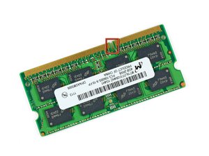

Be sure the small notch cut into each RAM module (shown in the first picture) mates with the protrusion in each RAM slot (shown in the second picture).
When reinstalling RAM in this machine or any iMac with upgradable RAM slots push hard to get them to go in (Apple really did make this one harder than it needed to be). If you don't push hard it won't go in and your computer won't work. (trust me on this learned the hard way)

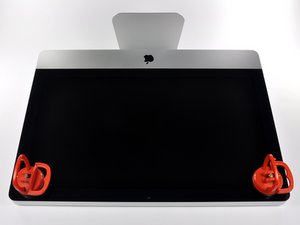

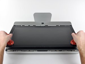

Stick a suction cup near each of the two top corners of the glass panel.
If your suction cups refuse to stick, try cleaning both the glass panel and the suction cup with a mild solvent.
Change "Before beginning, unplug your iMac and lay it on a soft surface as shown." to "Lay your iMac on a soft surface as shown"

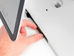

You don't need suction cups. The screen, held by magnets, can simply be pried off using a very thin blade such as a screw driver and fingers.
That's a bad idea. using a metal tool to pry off glass is likely to end with an expensive broken front glass.
Suction cups are common. Find a couple and do it the safe way. I use some cheap ones that came with iPhone repair kit.

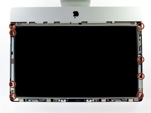

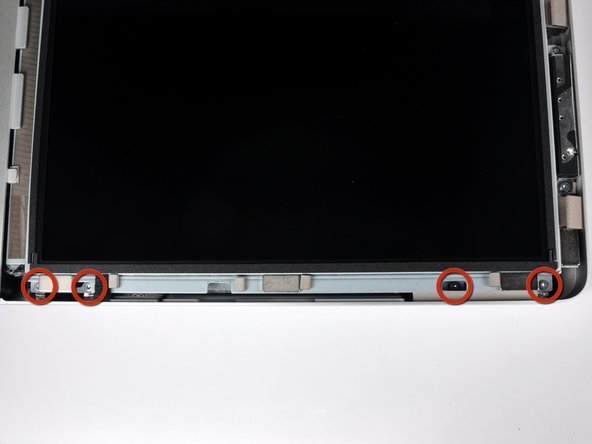

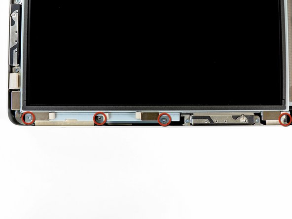

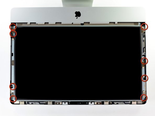

Remove the eight 8 mm T10 Torx screws securing the display to the outer case.
The metal near the screws is VERY magnetic. Honestly, the hardest and by far most frustrating step was trying to put these screws back in.
I ran into the same problem - easily the most frustrating part of this process. To help deal with it, I took a drinking straw, cut it to be about 2 inches long, and used it as a chute to guide the screw to the hole. Dropping the screw down the straw, it'd still stick to the side due to the magnets, but using my screwdriver, it was easy to push the screw down to where it needed to go, and the straw kept the screw from being pulled out of place by the magnets.
josh -

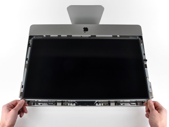

Slightly lift the top edge of the display out of the outer case.

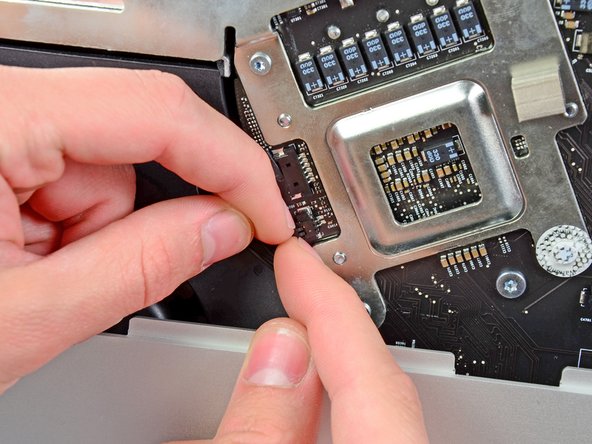

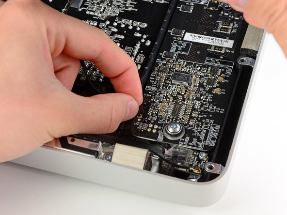

Pull the vertical sync cable connector out of its socket on the LED driver board near the top left corner of your iMac.
Rotate the display out of the outer case enough to disconnect the LED backlight power cable from the LED driver board.

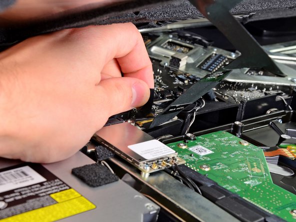

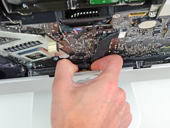

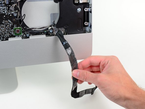

Grab the plastic pull tab secured to the display data cable lock and rotate it towards upwards.
Pull the display data cable straight out of its socket on the logic board.
I am having a difficult time reattaching the LCD cable. A better description or any tips would be useful here.
Me too — ditto that.
https://eshop.macsales.com/item/OWC/DIDI... —> abt. 5:30 into the vid. Handle up to slide in, then flip it down to lock the connector in place.
The connector needs to be carefully pushed in parallel to the board with a surprising amount of pressure and the pull tab must be folded back. Not super fragile, but not strong either.

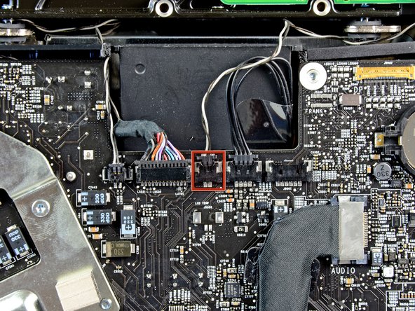

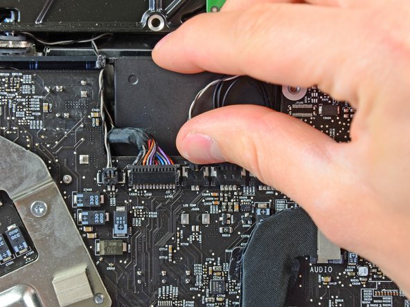

Disconnect the LCD thermal sensor cable connector from its socket on the logic board.

Carefully pull the display toward the top edge of your iMac and lift it out of the outer case, minding any cables that may get caught.

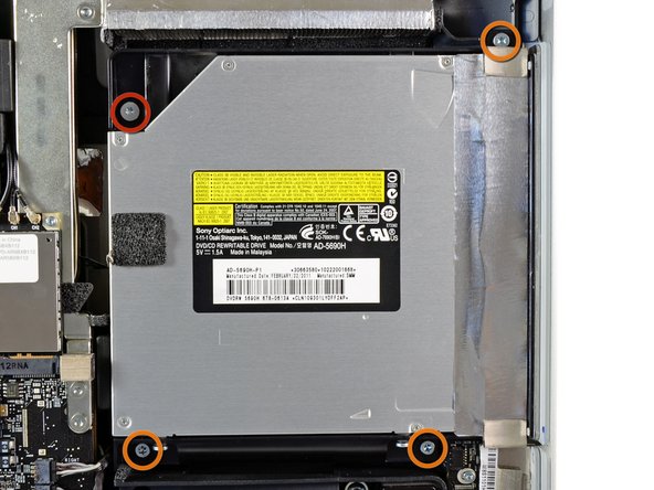

Remove the following four screws:
One 9.3 mm T10 Torx screw with a large head
Three 9.3 mm T10 Torx screws with a normal sized head

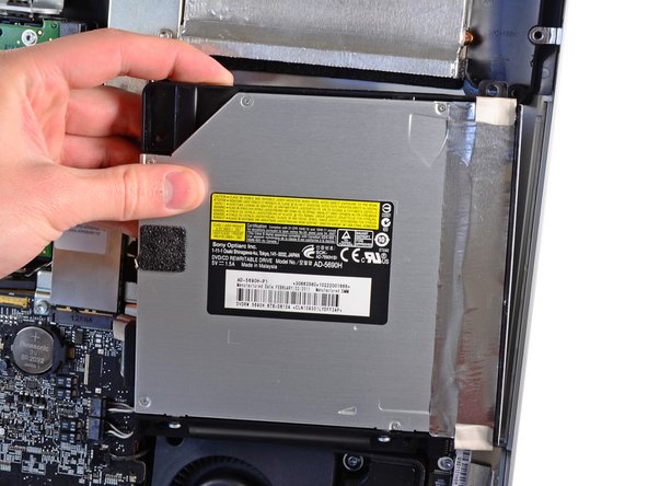

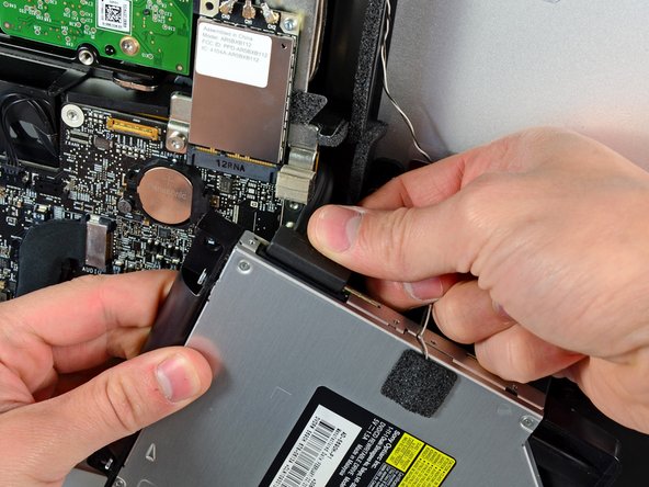

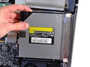

Pull the optical drive thermal sensor connector straight up from its socket on the logic board. Pull parallel to the board.
Lift the inner edge of the optical drive and maneuver its connector past the GPU frame attached to the logic board.
Carefully pull the optical drive off its mounting pins on the right side of the outer case to gain clearance for disconnecting the optical drive cable.
Allow the optical drive to hang down as you de-route the optical drive thermal sensor connector from behind the GPU heat sink.
Disconnect the optical drive cable by pulling its connector away from the optical drive.
Remove the optical drive from the iMac.
I have already installed the second SSD drive, but due to the size of the drive I need to change it with another SSHD 1 TB drive. Am I right that I have to follow the instructions up to Step 18? Because The SSD is already behind the optical drive, so what I need to do is remove it and install the new SSHD drive and put everything back again. Please confirm.

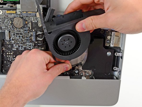

Remove the single 13 mm T10 Torx screw securing the optical drive fan to the outer case.
Pull the optical drive fan off the pins attached to the outer case.
Pull the optical drive fan connector away from its socket on the logic board.
Remove the optical drive fan from the iMac.

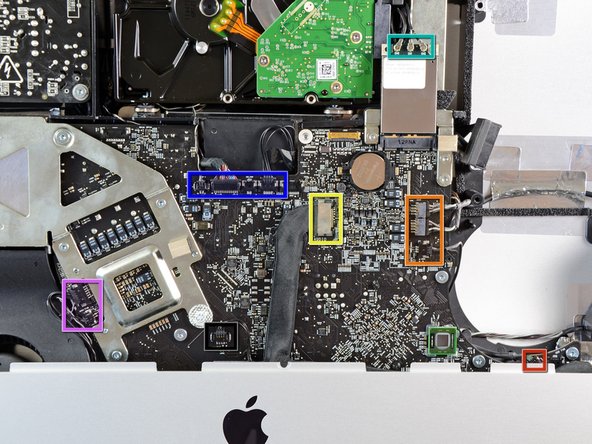

In the proceeding steps, you will disconnect the following cables:
SD Board
Left/Right Speaker and Microphone
Audio Port
Wi-Fi Antenna
Right Temperature Sensor, Bluetooth/Ambient Light Sensor/Camera/Left Temperature, and Hard Drive Fan
CPU Fan/Ambient Temperature and Power Button
IR Sensor

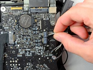

Pull the SD board cable out of its socket on the logic board.

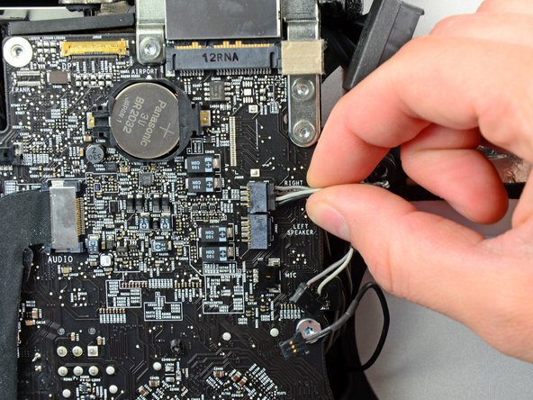

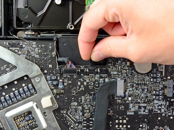

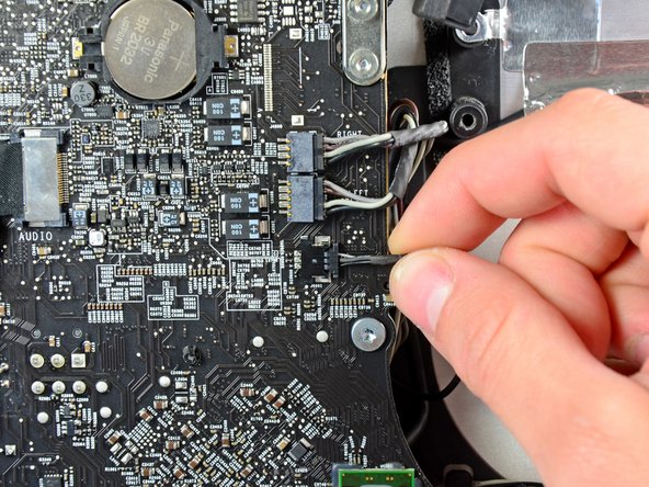

Disconnect the microphone, left speaker, and right speaker cables by pulling their connectors toward the right side of the iMac.

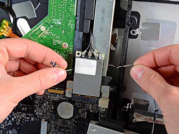

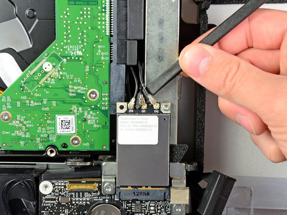

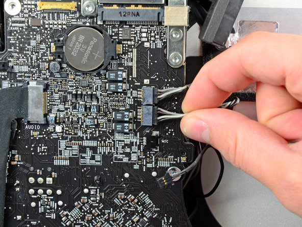

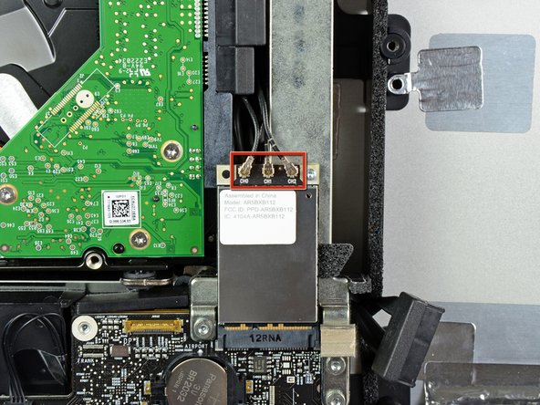

Use the flat end of a spudger to pry all three AirPort antenna connectors up from their sockets on the AirPort board.
For me it was originally the reverse order. No stripes for ch2, one for ch1 and two for ch0
As another user already posted, cables can be in the reverse order as depicted on the guide. Pay attention before disconnecting them.
E.g.:
To simplify this and since there seems to be some variable set ups, take a digital picture of the way it is before following this step so that you can put it back the way it was. (If no digicam then draw yourself a note with paper and pen).

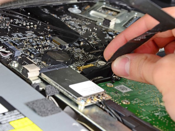

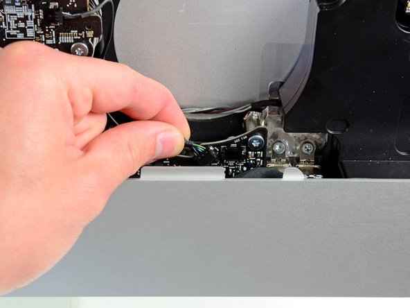

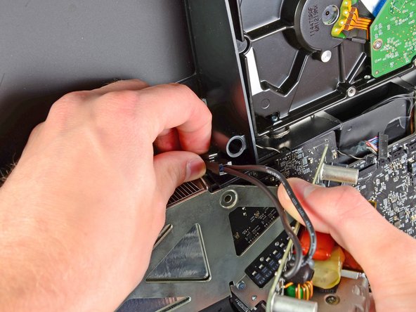

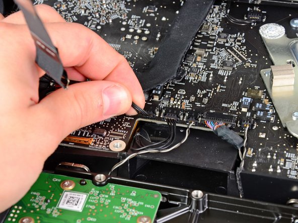

Pull the hard drive fan connector toward the top edge of the iMac to disconnect it from its socket on the logic board.

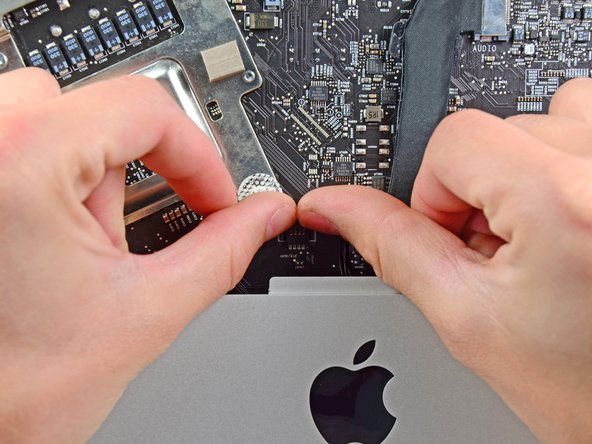

Use your thumbnails on both sides of the Bluetooth/ambient light sensor/camera/left temperature connector to push it toward the top edge of the iMac and out of its socket on the logic board.
Use your thumbnails to push the right temperature sensor connector toward the top edge of the iMac and out of its socket.
Pull the CPU fan/ambient temperature sensor connector toward the bottom left edge of the iMac and out of its socket on the logic board.
Pull the power button connector toward the bottom left corner of the iMac to disconnect it from its socket on the logic board.
Use your thumbs to push the IR sensor connector toward the top edge of the iMac and out of its socket on the logic board.

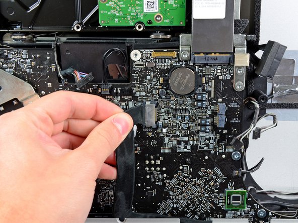

Pull the audio port cable connector toward the left side of the iMac to disconnect it from the logic board.
Peel the audio port cable off the front face of the logic board and let it hang down as shown in the second picture.

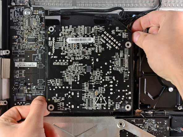

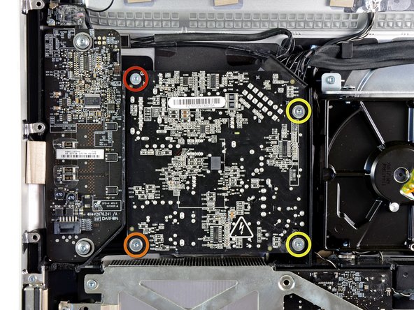

Remove the following four screws from the power supply:
One 9.3 mm T10 coarse-threaded screw
One 25 mm T10 coarse-threaded screw
Two 22 mm fine-threaded screws
Pull the upper right and lower left corners of the power supply away from the rear case to dislodge the mounting posts attached to the power supply's corners.
Carefully lift the power supply out of the outer case and rotate it to expose the cable lock as shown, minding the DC-out and AC-in cables still attaching it to the iMac.

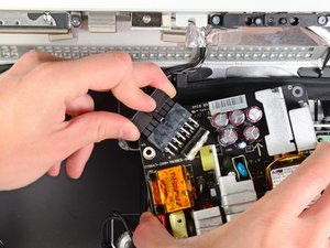

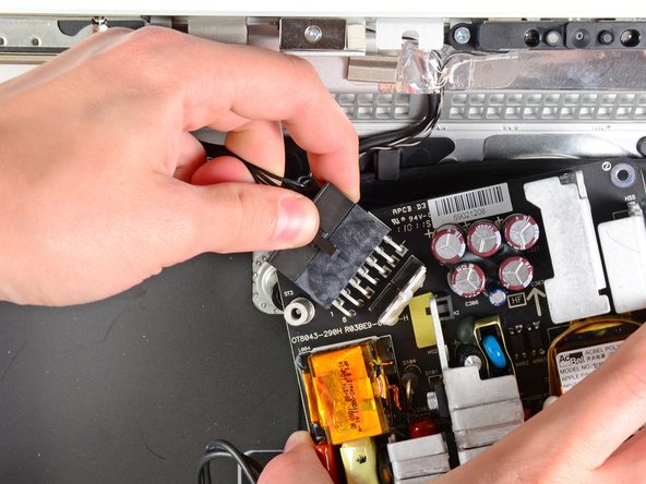

Disconnect the DC-out cable by depressing the locking mechanism on the connector while you pull the connector away from its socket on the power supply.
Once the locking mechanism has cleared the socket, pull the DC-in connector away from the power supply.
Disconnect the AC-In cable by depressing the locking mechanism while pulling the connector away from its socket.
Remove the power supply from the outer case.

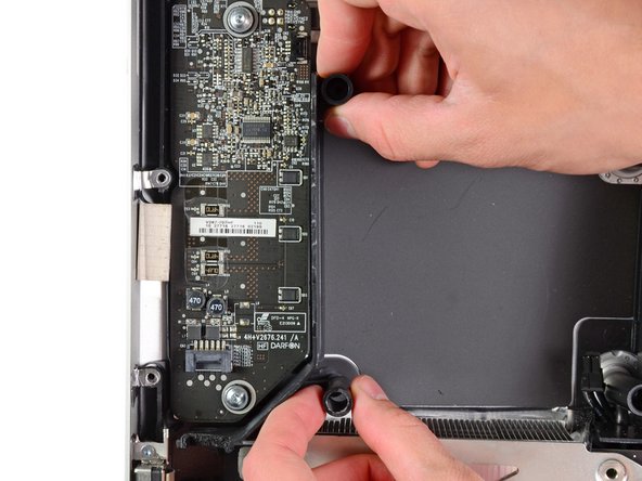

Remove the plastic wall that is installed directly to the right of the LED driver board.

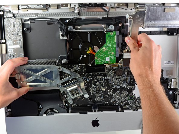

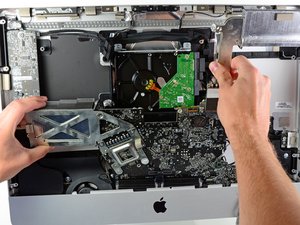

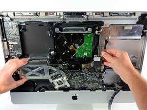

Slightly pull the logic board away from the back of the outer case, then lift it upward to clear the lower front face of the outer case.
Be careful when balancing the mother board here, you can damage the RAM bays if not careful. (Had a friend do this, good by motherboard and iMac.) Just be careful and aware of how you have it sitting.
Before you lift the logic board, remove the infra-red receiver ( have a look at the logic board replacement guide )! It will make your life a lot easier.
Like stated also in the video, it's easier if you put the iMac on its foot again.
This was a great tip. Removing the IR made my life easier when putting the board back in place.
fansntt -

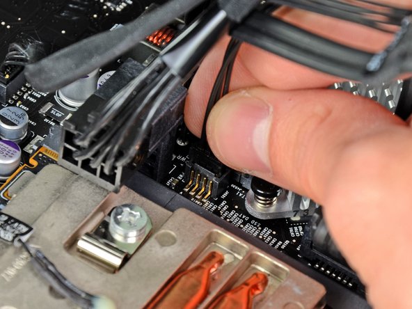

In the following steps, you will hold the logic board slightly away from the outer case as you connect the new hard drive cables included with the dual hard drive kit.
First, locate the small connector on the SSD power cable.

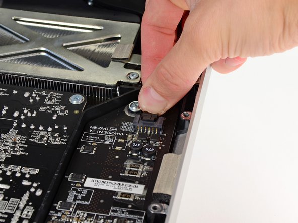

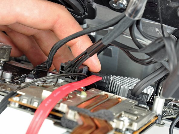

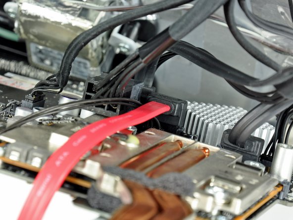

Connect the small plug on the SATA power cable to the socket labeled SSD Power on the logic board.

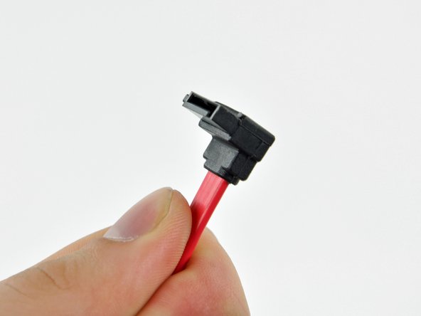

Next, locate the 90º connector on one end of the SATA data cable.
Connect the 90º end of the SATA data cable to its socket on the logic board next to the SATA power connector.
With both SATA cables connected, they should look like the logic board shown in the photo.

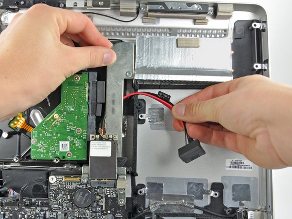

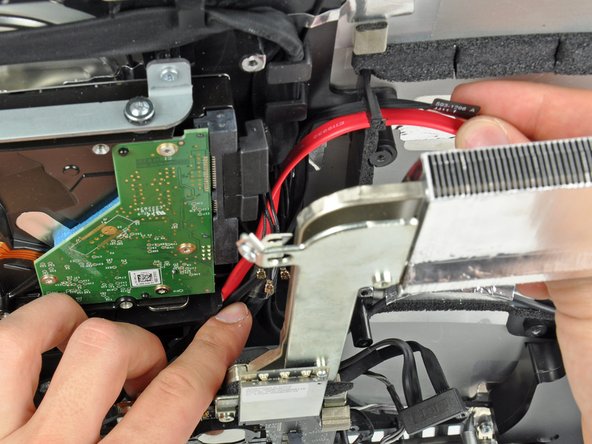

Next, while holding the new hard drive cables against the GPU heat sink, lower the bottom edge of the logic board back down into the outer case.
Before pushing the logic board against the back of the outer case, first route the hard drive cables in the channel near the bundle of power cables.
As you place the logic board into its recess, route the hard drive cables through the small channel cut into the plastic pressure wall near the fins of the GPU heat sink.

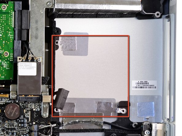

In the next few steps, you'll install your new drive into the case of your EMC 2428 iMac.
Isn't there a way to fix the SSD by screws?
No. Its just flat aluminum. The adhesive pads will work well. You may even be able to use the picture hanging velcro strips by 3M that you can find any where (they now have ones with stronger adhesive). If using the velcro ones it would make it easier for removal later. I personally have not done it this way, but I think it would work. I just used the red ones they gave (i could find my box of the velcro ones).

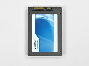

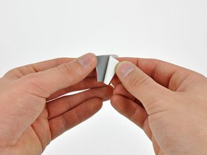

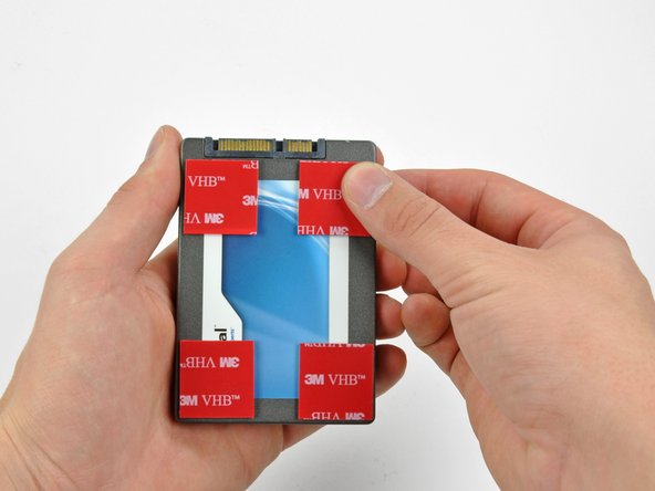

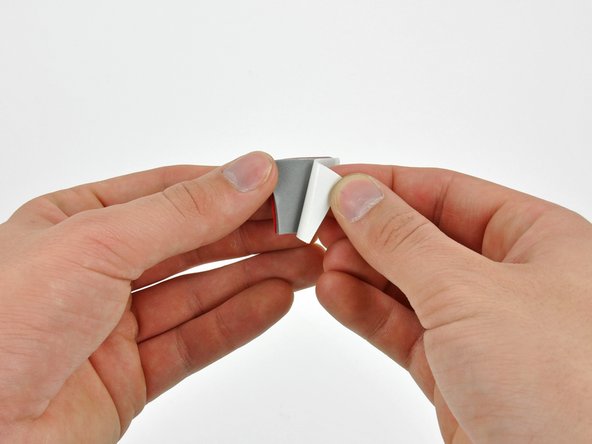

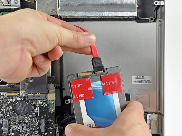

Peel the backing off one side of the double-sided tape and place the pieces at the four corners of the hard drive.
They have crucial here pictured (we used crucial and it works phenomenal). Also Samsung has a great line of SSDs called EVO (we used it in our Macbook Pro and it works just as good if not better than crucial). {here is their website, http://www.samsung.com/us/computer/solid...) Its a second option for ssd hard drives.
Also when installing SSDs make sure to enable TRIM support (crashes can and probably will occur if you don't) TRIM enabler is available free and the pro version is $10 http://www.cindori.org/software/trimenab... It is the easiest solution for this issue.
Hello Robert I have a question, I have an Imac 21.5 mid 2011 and I want to add a second ssd drive (Crucial or Samsung Evo) ....I want to know if the second port is Sata 2 (3Gb/s) or Sata 3 (6Gb/s)
??? Could you check the¨link velocity¨? Thank you Robert !!!
Leonardo -

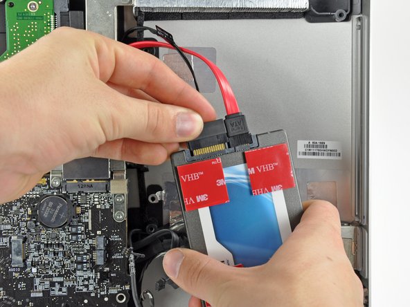

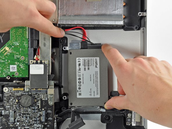

Connect both the SATA data and SATA power connectors to your new hard drive.
Remove the backing from the double-sided tape and place the hard drive inside the iMac.
Carefully set the drive into the iMac optical bay as close to the lower left corner as possible.
Once you are happy with the hard drive's placement, firmly press down along its edges to ensure full adhesion.

Found that the logic board was extreamly hard to remove.
Good tip is to selotape the cables before removing / inserting the logic board as i traped my microphone connector underneath. Luckely i could reach it with a pair of tweesers.

Can anybody explain why the PSU module needs to be removed (steps 34-37)? I saw a similar guide elsewhere and it skipped this completely. Is this not required? If so, that might explain why this guide says that to re-assemble do the reverse from step 33 and not 38 as expected!
I can confirm that you do not need to remove the power supply to do this - you can safely skip these steps! Anyway, this install went well for me, not as scary as I thought it would be. You just need to be prepared, remain calm and keep track of all the screws!
markbart -
Having read this comment, I initially skipped the PSU removal steps. While removing the logic board was a bit difficult, putting it back in place seemed impossible until I figured one of the plastic walls (step 37, although it was the one on the other side) was getting in the way: some pieces have a diagonal cut from top to bottom and they have to fit together, and the diagonal shape forces one to be placed before the other (one on bottom, then the other on top, so to speak). I had to remove the PSU to be able to remove the plastic walls, get the logic board in place properly, and then put the plastic walls back "on top" of a piece attached to the PCB.
So while I guess it could be possible to skip the PSU removal steps, I found it easier to put everything back into place by removing it. YMMV, just keep it in mind, and you can always do as I did, skip the steps and do them afterwards if needed.
How long is the Sata data cable?
Is a 10" too short for the job??
Help asap would be awesome!
Thanks
The cable is a standard length, but I feel it was too long as it needed to be folded to fit. A 10 inch cable will be fine.

Very helpful guide, easy to follow. Took me around an hour and a half to install an SSD.
For the record, instead of using them independently I configured them as a Fusion Drive. Works like a charm, more info here:
The article you link to isn't describing a fusion drive. The whole areticle is a mistake. Read the comments over there...
Very helpful guide. I did it in 1 houre without removing the PSU.

L'accès au cablage du SATA (coté opposé de la carte mère) est délicate (avoir des petites mains c'est mieux).

1. This is a really long, laborious process. To keep track of screws, I drew a little chart and taped them to a piece of paper.
2. Make sure when reinstalling the logic board that the RAM slots line up correctly. They didn't for me, so had to undo the whole thing.
3. When my Mac restarted, the fans ran at full speed. Thought I'd broken something. Turns out, just needed to do SCM reset (see Apple docs)

Thanks.. OWC has a much much better step-by-step video. Successfully added a 240G Crucial M500 disk.. created a fusion drive and it's beautiful!
Tips:
- Plan well, clean surface, use anti-static band, be very very very careful and gentle
- Can use almost any “cheap” suction cups (like ones in car window shades) http://bit.ly/1oGzHIe
- Ensure 6G SATA cable
- Power cable is unique (SD Power Cable 593-1296 922-9862) and can be bought from AliExpress: http://bit.ly/1oGAjOd
- You’ll need Torx T10, T6 screw-driver bits
- Use tape to put cables in place when putting the logic board back
- Having someone to hold the logic board while putting in SSD cables can be useful

Oh yea, I also installed a free fan program called Macs Fan Control from crystalidea to help with some of the weird fan issues I was getting in Windows- plus they make it for both platforms.

The most difficult step was step 10, just the first cable to disconnect. This cable have a very small conector and was a little hard to remove, but at the end all was fine.

I have 2 original hdd cable (data and power) from a damaged imac. These two cable are long enough to add an ssd? maybe using a different path for the cables?

After ADDING an aditional SSD (samsung evo 850 1TB) to my 21.5inch imac mid 2011, I was having a problem with the speed of my cpu fan.
After adding this SSD I upgraded to El Capitan. I also added a OWC thermal cable on the SSD to solve the problem but my fan continued to turn very fast (4000RPM)
Nothing worked, so I installed Mac Fan control based on temperature of other sensors. This worked for one month untill last week my fan started turning fast again.
This time I checked my activity monitor. I noticed that my cpu was running at 700% because of my HP printer driver.
After deleting the driver I put all the fans on "auto" and my mac is now behaving like before the ssd upgrade.
