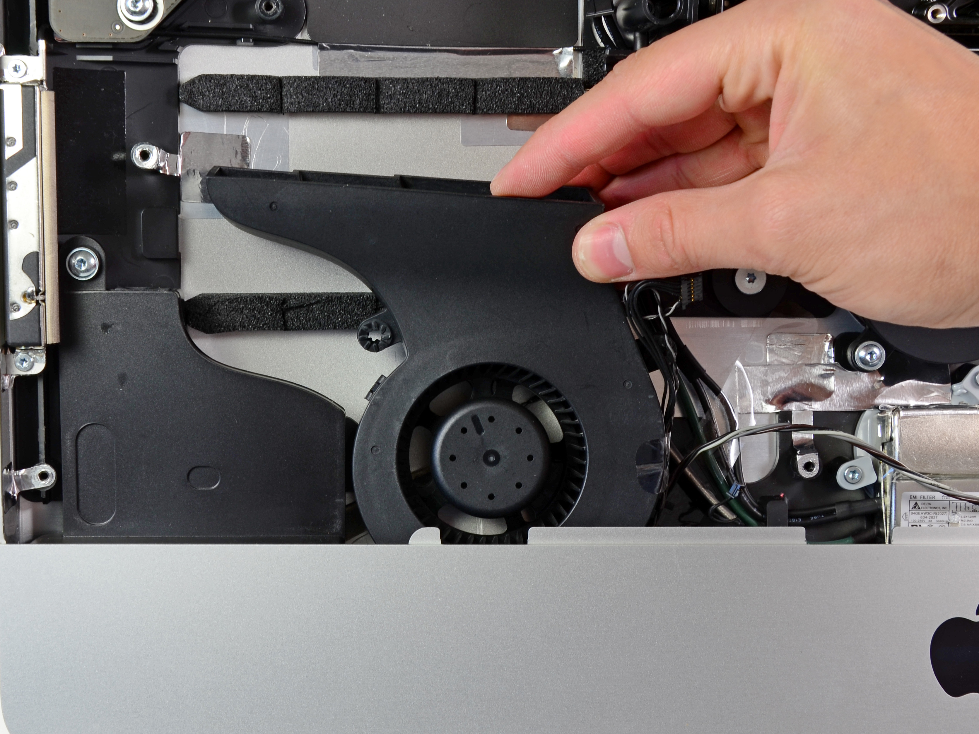

  39. iMac Intel 21.5" EMC 2428 CPU Fan Replacement: step 39, image 1 of 1
    • Disconnect the LCD temperature cable by pulling its connector up and out of its socket on the logic board.
  40. iMac Intel 21.5" EMC 2428 CPU Fan Replacement: step 40, image 1 of 2 iMac Intel 21.5" EMC 2428 CPU Fan Replacement: step 40, image 2 of 2
    • Depress the locking mechanism and carefully pull the DC-In cable out of its socket on the back of the logic board.
  41. iMac Intel 21.5" EMC 2428 CPU Fan Replacement: step 41, image 1 of 1
    • Being careful not to damage the socket on the logic board, gently pull the hard drive SATA data cable straight out of its socket on the logic board.
  42. iMac Intel 21.5" EMC 2428 CPU Fan Replacement: step 42, image 1 of 1
    • Pull the hard drive power cable connector out of its socket on the logic board.
  43. iMac Intel 21.5" EMC 2428 CPU Fan Replacement: step 43, image 1 of 1
    • Remove the logic board from the outer case, minding any cables that may get caught.
    • When reinstalling the logic board, plug in a thunderbolt cable and a USB cable into the USB port closest to the headphone/microphone ports before tightening the logic board screws to ensure proper alignment.
  44. iMac Intel 21.5" EMC 2428 CPU Fan Replacement, CPU Fan: step 44, image 1 of 1
    • Remove the two 13 mm T10 Torx screws securing the CPU fan to the outer case.
  45. iMac Intel 21.5" EMC 2428 CPU Fan Replacement: step 45, image 1 of 1
    • Pull the CPU fan straight up from its mounting pin near the bottom edge of the iMac.
  46. iMac Intel 21.5" EMC 2428 CPU Fan Replacement: step 46, image 1 of 2 iMac Intel 21.5" EMC 2428 CPU Fan Replacement: step 46, image 2 of 2
    • Being careful not to put too much strain on the left speaker cable, flip the CPU fan over to expose its bottom edge.
    • Use the flat end of a spudger to press down one side of the speaker cable retainer as you use your other hands to slide the speaker cables out of the retainer.
    • Remove the CPU fan from the iMac.
